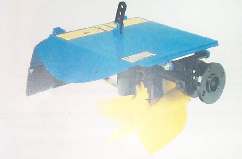

ZJ_HR - the website you link to has some interesting pictures. The rotary plow shown there looks fairly different from the Berta rotary plows sold by Earth tools in the US (see the pictures posted earlier in this thread).
Berta and Earth Tools have a double plow model which can be reversed to plow to the right or left. At the time I purchased my plow I was unaware of the problems I would encounter using it on a slope, and Joel from Earth Tools advised against the double plow because it is very heavy, so I bought the single. Perhaps I should have chosen the double.

Just a question; this Berta plow is in front, or at back during work?
Plow on my link is in front of tractor, like mower for example.

PS ZJ_HR the rotary plow on the gravely was in front, on the BCS (and European 2 wheelers) is driven with the PTO in the rear facing position.

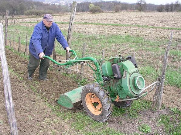

We were tilling yesterday our old vineyard. Soil was really hard, and walk behind tractor, borrowed from a friend, had hard time to break compacted clay soil. Also father (on pic) had hard time to make several feets of tilling (when I take a pics /forums/images/graemlins/grin.gif )
Walk behind is about 20y old. It has 13 HP licensed Lombardini diesel engine, which started on first pull after 6 months of non use.

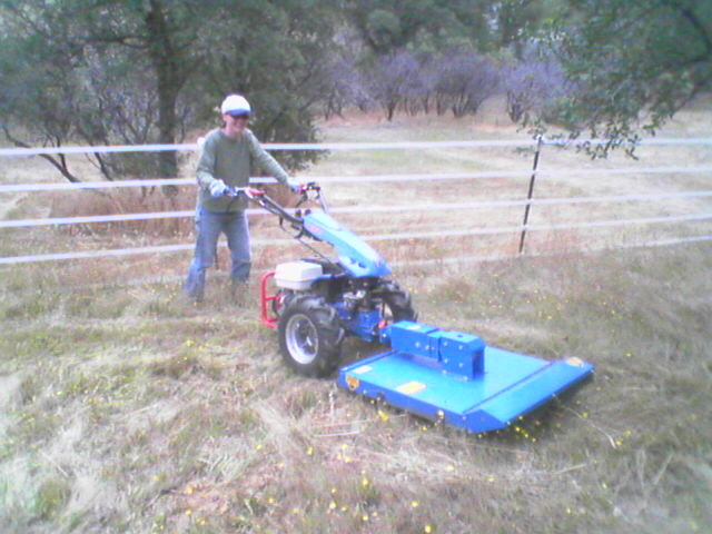

I have a BCS 852 with a 30" tiller and a 31" DelMorino brush mower, the machine has been great so far, I only have about 20 hours on it, I bought the tractor and tiller from a local dealer in Redding, CA. The mower and several other goodies were purchased from earth tools, they were awesome. The mower has been great, and the best thing is that my wife can actually wrestle the contraption and mow the property, which is steep and covered with lots of oak trees with low branches and brush.

Sorry, don't have any Berta pic. I have their CD somewhere ...
Principle of rotary plow you can see here .

ZJ - why do you have the tires on "backwards" ?

</font><font color="blue" class="small">( ZJ - why do you have the tires on "backwards" ? )</font>
To20Chris,
You DO understand that these tractors are <font color="red">bi-directional</font> right? /forums/images/graemlins/confused.gif The handlebars rotate 180 degrees to pull or push its various attachments. /forums/images/graemlins/cool.gif
The tires are on the right way for tilling, which requires more traction than mowing, etc.

Thanks, I'm more used to my Gravely with fixed handle bars. But still, for the tilling direction he's going, the tires are reversed from that of a tractor. Not that you'd want to spin the tires every time!
I've recently procured a rusted out Gravely carcass - but it has duals on it. I've been spraying the bolts with penetrating oil every week - one of these days I'll find the time to get the air wrench on them. Then I'll put on 4 ag tires, and I've heard some people put one on forward, one on backward on each side. I may have to give that a try.

To20Chris,
Reason why tires are backwards is that, as I mentioned, machine is borrowed from my friend, and I was too lazy to replace their side. /forums/images/graemlins/wink.gif
BTW, when you till soft ground, reverse tires don't dig when tires spin in place, similar effect to snow (tractor goes better backwards than forward in deep snow). This is good effect if machine has narrow tires and is lightweight.
Machine on pic is heavy about 450 lbs, and traction is not a issue.
