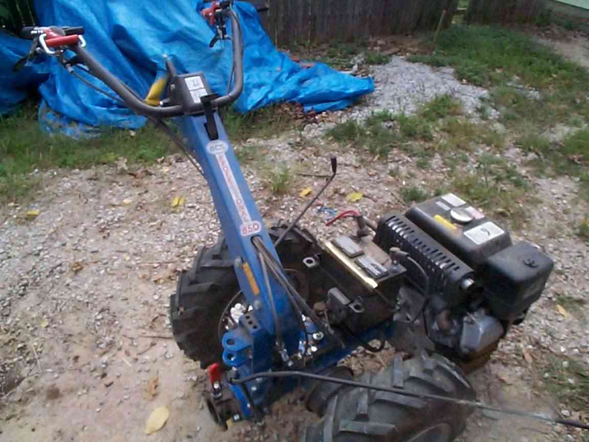

Received my tractor two days ago. Spent all afternoon figuring out how to assemble the trailer. Finally my son and I got it together and he took it for a ride. Tonight I put on the steel wheels and attached the brush hog, but have yet to try it. I want to read the directions one more time. I have one blue steel bar left over and I have no idea what it is for and want to verify with Joel its purpose before starting up any attachments.
This thing is so big.
