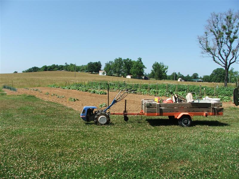

I agree, I'm really enjoying my 20 yr. old BCS 735 this year. I doubled the size of my garden, mainly to give me more room to work what I put out, not necessarily that I wanted more stuff. When I started using the BCS last year, I was having a problem with the fuel vaporizing in the line, called vapor lock, so I called Joel ad Earth Tools and he suggested using AV gas, well since that's not readily available here, I moved the gas tank and rerouted the fuel line away from the exhaust side of the engine and solved that problem. The old 735 is a real joy to use, it has large tires and a differential, easy to turn at the end of the row, 5 speed forward and 2 rev, I have a trailer with all my tools and the tiller, and when I get to the garden I just unhook the trailer and attach the tiller and go to work. Nothing like the smell of fresh turned soil.

js5020, thanks for the bump, I just went back and looked at some of the pics and links, real interesting thread and it's that time of year around here, already had the BCS out and in the dirt. Here's another pic from last year, hoping the garden does as well this year.
