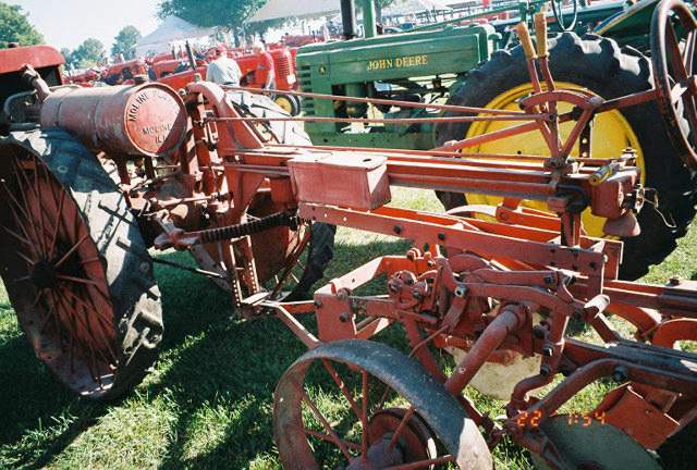

Here, gentlemen, is the "ultimate" in 2 wheelers. In fact its so large it has a sulky permanently attached (would hate to try and handle that one with handle bars!). I think it was made in the teens. The sulky is pinned to the tractor - you can see the swivel attachment in the pic. Two cylinder engine.

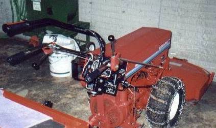

I've a 5665 with a 12 hp Kohler engine. It was difficult to steer with and without the duals. What it needed, and now has, is steering brakes. The one shown in the picture has no brake bar. It could be the 8 hp, which would be a little lighter in weight.
Attached is a picture of mine before the duals but with the brake bar over the left side handlebar.

I think my 5665 with 12 hp engine is heavier than some old Ls that I've seen. On hills, it was too much for me to handle without the aid of the steering brakes.
With steering brakes and all, turing it 180 degrees at the end of a row isn't too bad, long as it's a left hand turn (as steering brake arm is on the left). Gotta do it in 1st gear for the maneuvering. Also, the plow throws dirt too far in 2nd gear.
With the steering brake and sulky, you can pretty much one hand steer it, with just a gentle touch on the handle. Gotta always watch out for stuff a tire can hit that'll cause it to make a sharp turn on its own.
