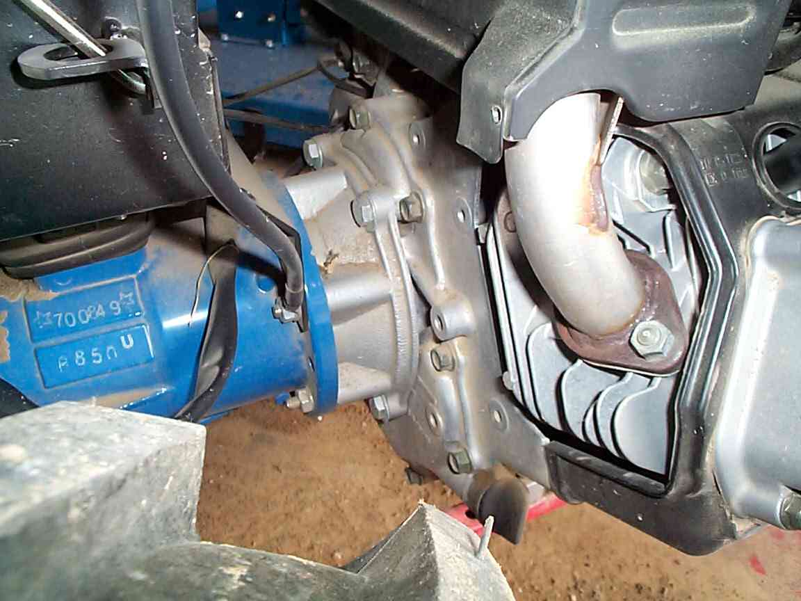

This type of equipment can use any small engine you might wish. An adaptor plate (just to the right of the blue transaxle housing in the attached picture) is bolted to the transaxle. The engine is bolted to the adaptor plate. There are two types of bolt patterns, European and American style. Both bolt patterns can be used (just switch the adaptor plate). The engine on this is a 12hp Kohler (made by Yamaha I believe). However, you can use Lombardini industrial diesels, Yanmar diesels, and a myriad of gasoline engines.

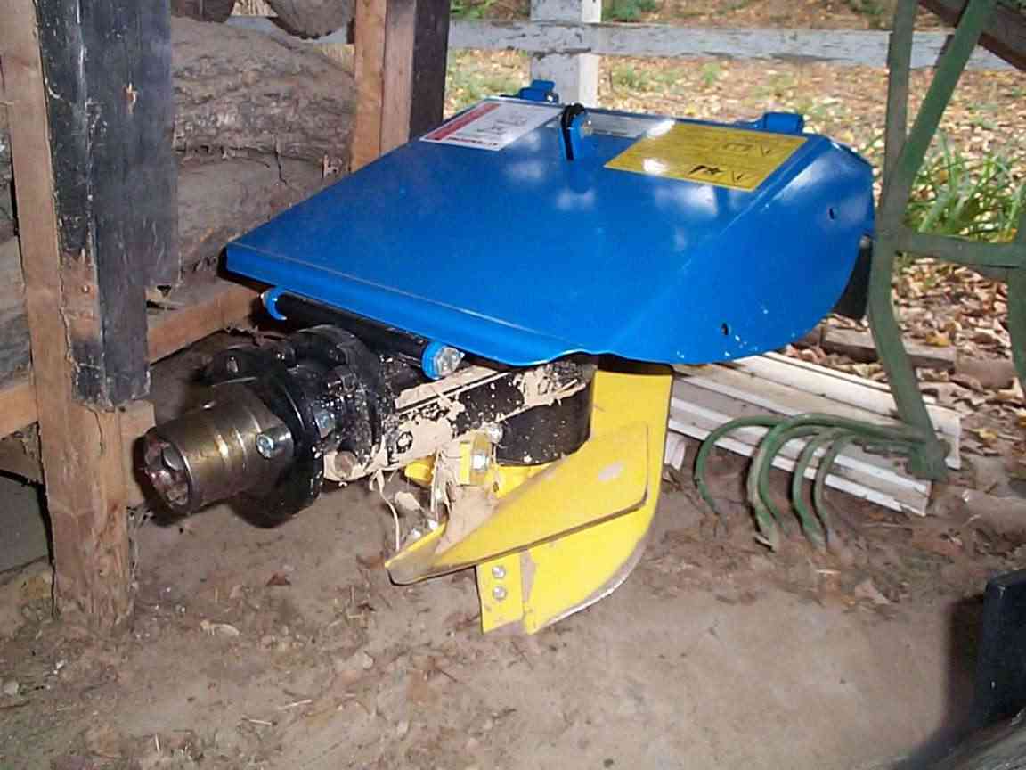

This is a rotary plow which augers the ground and produces a very good bed. You can see the quick attach in the photo. It will “plow” about 10” deep and works better than the old Gravely rotary plow I had before. I don’t believe these are available (yet) on 4 wheel CUTs.

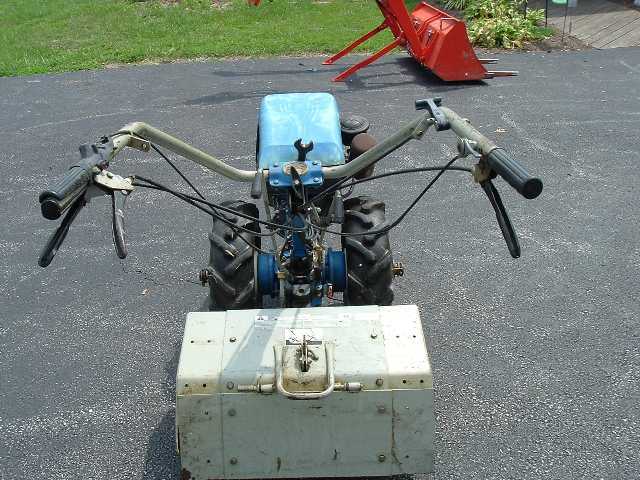

Me too! I think there are Euro regs for positioning - the new BCS 852 has the brake levers on the post, rather than handle bars. Not as handy for using the brakes to do a 180.
On my 735, I found it difficult to turn left with the mower and sulky attached, the brake levers being on the right handle, in a sharp left turn, the right handle was out of reach. I removed the handle for the left turn and welded it on the left, by the clutch, I've not found a disadvantage with this arrangement.
There used to be a logsplitter for the BCS in their brochure, it was rather expensive, probably why they dropped it. Love that old BCS.

I don't have sulky for BCS. Had 2 sulkies with the Gravelies (one steered with a steering wheel, one with handle bars). While it's easier riding than walking, I found the use of a sulky with the Gravely was sometimes more trouble than it was worth, especially on steep slopes or when turning a lot. It you're mowing an acre or two, mostly open, seems fine. Don't know if I will even get a sulky for my BCS.
Nice idea swapping location of brake lever. Shows how much easier it is to use the 2 wheeler. Try modifying the location of the brake on a CUT!
You have the older style tiller. Don't know how it tills, but you have more adjustment range than the newer style. Looks like you can adjust the outer width to at least three widths. My 30" is only adjustable to 2 widths (30" and 26"), although I guess I could drill more holes in it. Looks like yours is more flexible.

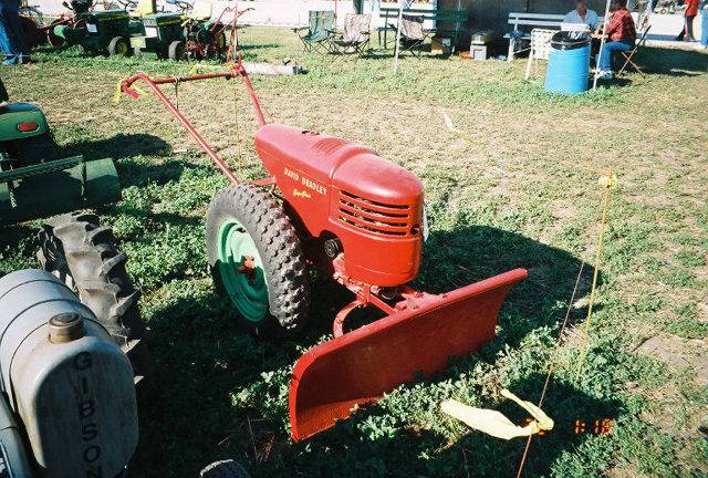

Hi - was at an antique power show over weekend - thought I would post some pics of old 2 wheelers. This is a david bradley very nicely restored.
