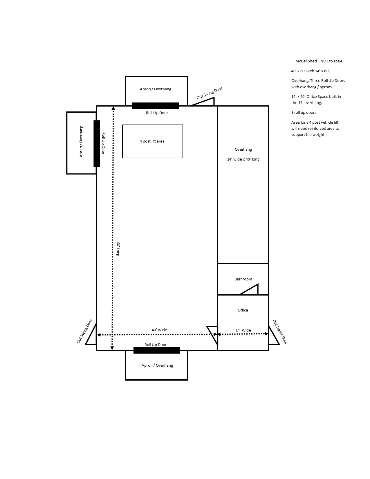

Just a couple of other thoughts and things to consider that I did not see mentioned. Consider mounting the doors so the swing in. They are more secure. You didn't say which way was north but I limited my northern exposure as the cold wind comes right in those 12' doors.
Thank you for your service and congratulations on a nice shop.

My 3-bay shop/garage is 40 x 26, built in 2012, with a 10k lb. 2-post lift and boy am I glad I got a 2-post. Too many things you cannot do on a 4-post. Door issue is an inconvenience only solved by a commercial lift with posts farther apart.
You have a dream shop - my only regret is I didn't make mine larger. But I did break the bank when I built mine (myself - commercial GC & EC for 40 years among other things).
