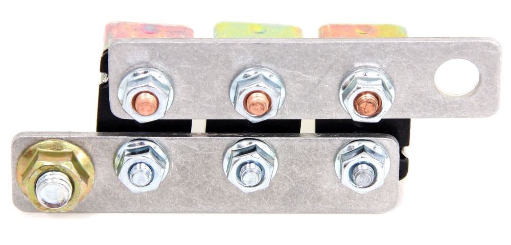

I have Anderson plugs mounted on my truck and tractor. I installed one on the 12V fuel pump power wire (a bit overkill) so I can drive up to the tank, plug in the pump and refill the tractor. Another Anderson plug on a set of jumper cables I keep in the truck.
If you want to use jumper cables for a winch, water pump, or boosting another battery, use the cables direct to the battery or through a circuit breaker set up. A fuse will just blow and need to be replaced.

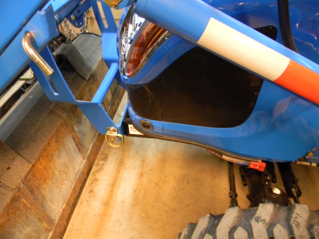

No fuse. From Anderson plug to battery on the tractor I installed 2 short length 6 gauge red and black cables. Here's a pic of my plug just above the axle.
For jump starting (if needed) I like to connect jumper cables direct to Batt + and frame ground. For connecting the tractor to the fuel pump, the pump wiring is fuse protected.

Whatever size I make the fuse needs to be able to handle the load of jumping a dead battery as well as heavier loads such as a portable winch, water pump, etc.
Not gonna happen. Rethink, try another plan. If you want a jumper port, run the heavy cable to your Anderson connector someplace convenient and close, and sheath the hot lead in plastic wire loom for extra protection. No fuse.
If that location isn't good for your pump hookup, do that separately. If it is okay, put the fuse downstream of your Anderson connector. That way your pump setup is fused.

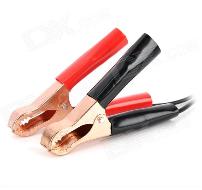

I just did a 15 foot cord with med size clips, just clip the hot to my starter lug were the battery cable connects, the the ground to the frame near it. I use mine on different vehicles and tractors so it's nice to have a universal connection.
