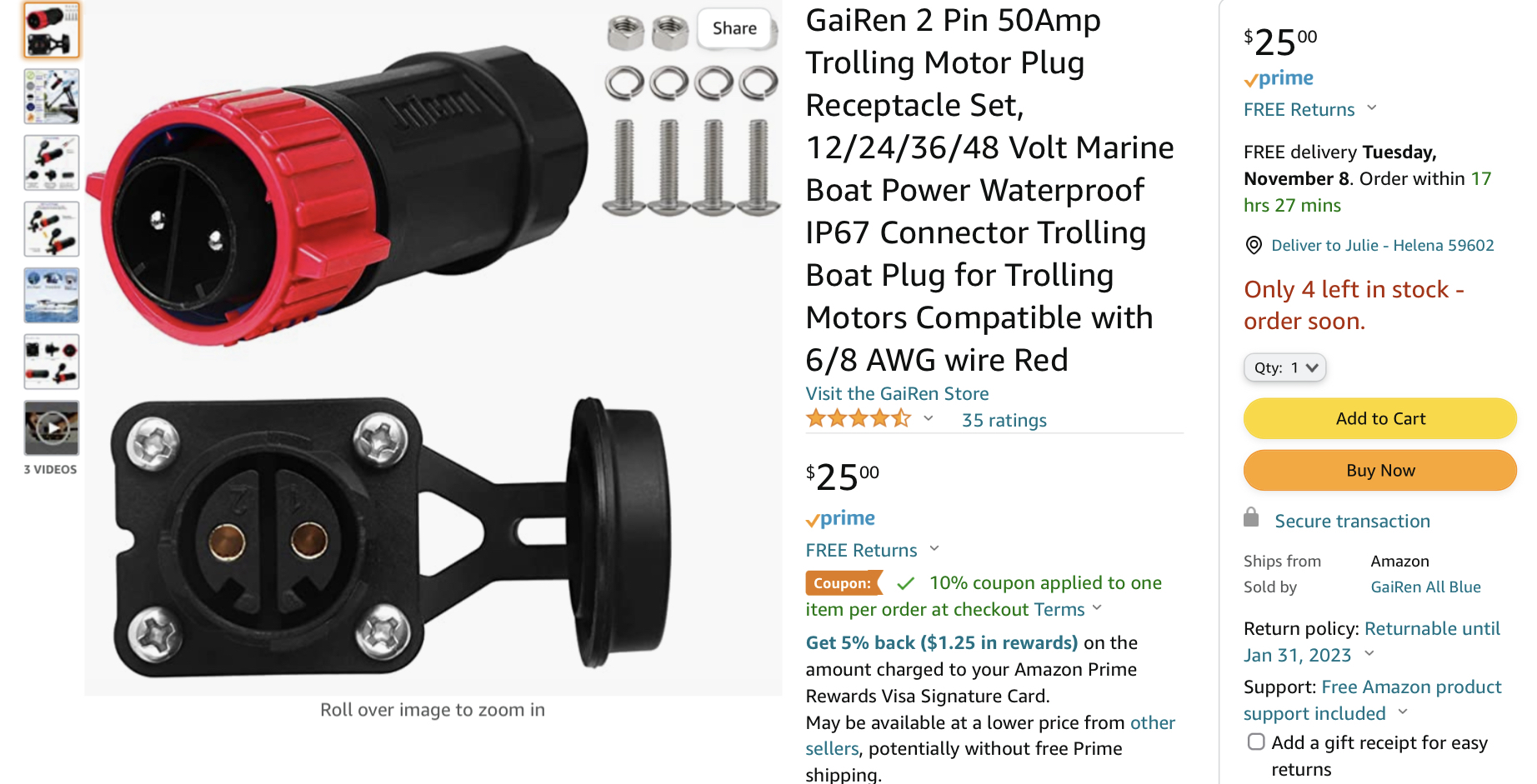

I’m deliberating adding an 12v outlet to my tractor… currently (pun intended) having three items I wish to connect I’m thinking of a quick connect like this:
In the past I connected items via alligator-style clips.. not exactly easy and screwing around with battery clamps isn‘t on my favorite-things-to-do list… also, driving around with my spot sprayer I’m concerned with the battery clip moving and shorting out… not good…
The items I want to connect are:
1-Fill Rite fuel pump
2-Spot sprayer
3-Battery Tender
If I were to place the female connector in a permanent, convenient location on the tractor.. I would then have three male connectors I could attached to the various electric items… each of my intended items has a shut-off switch so the risk of sparking while plugging in would be reduced…
The above outlet/plug is rated for 80 amps …edit: rereading, it’s rated for 50 amps…(I think I’m safe there ;)), is waterproof (it’s a trolling motor connection) and accepts 6/8/10 AWG wire… I’ll probably be safe with 10 AWG and a 20 amp fuse…
Anyone done something similar? Anything I’m overlooking? Am I complicating the heck out of this (hey, it’s fun adding farkles to my new toy…)

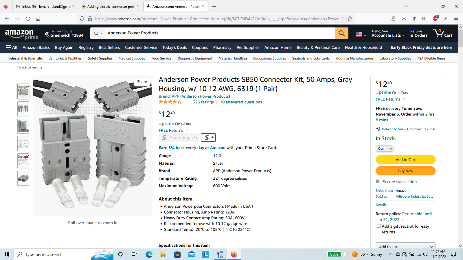

That looks good. 80 amps is plenty of capacity. Waterproof is good too. I was wanting something similar for the fuel transfer pump. I was going to use an SB50 connector just hanging out of the battery compartment area but I like your idea, more sanitary and H2O proof is appealing. I don't see how you additional male ends without buying the whole thing again? That gets pricey so I posted the question about additional male ends on Amazon.
/ Adding electric connector port
…I don't see how you additional male ends without buying the whole thing again? That gets pricey so I posted the question about additional male ends on Amazon.
I was think the same thing… kinda spendy…
Let me know if you hear anything back from Amazon regarding individual male connectors…

Looks good, you could also consider the Anderson Power connectors;

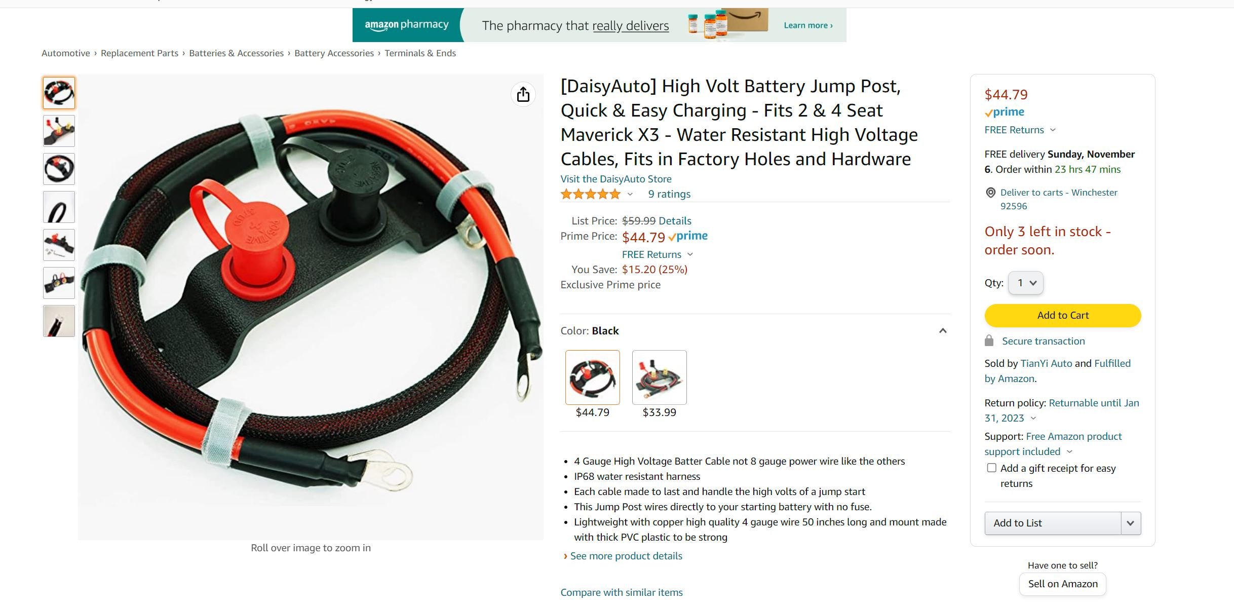

I chose the post extensions because:
I'm tired of opening the tractor hood and closing it on my cables to pump fuel into the fill neck in the hood.
I didn't want to change the clip ends on my fuel pump because I use it on other equipment also. Although I did think I could make up another SB50 adapter with the old clips attached. Just didn't really want a dangling SB50 connector in the front of the tractor.
This just turned out to be the easiest for me. Will post pics in what did you do for your tractor today when the mod is complete.
For charging and fueling 20 amps should be more than enough.

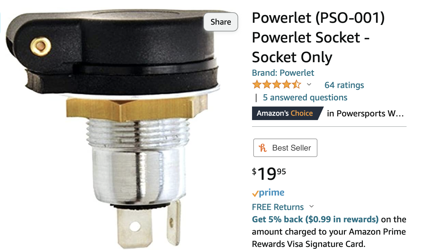

FWIW.. my original idea was to install a PowerLet socket... same size and space constraints as the standard "cigarette lighter" but much more robust...''
While searching for the Powerlet, the 50 amp, marine socket magically appeared on my Amazon search page... which brought me to today

Just put the post extensions on the tractor. Bought the kit linked to in post #5 and promptly tossed the cable aside. I cut some 4g welding lead off the spool I keep and soldered copper lugs on. I prefer to crimp but I only had 2g cable lugs and solder and shrink wrap was the best available solution. The cables that came with the kit had the wrong ends on them for me plus the cable was 4g covered in 1/2 inch of insulation.
I needed to drill a 1" hole for the 2 cables to exit the bottom of the battery compartment. It was a pain in the butt to install but should make fueling a lot easier. No more popping the hood connecting the clamps, closing the hood pinching the pump leads. Fueling then popping, the hood removing the clamps, closing the hood.... just remove the rubber covers and clamp on the exposed terminals.
Another bad is the rubber caps are a loose fit so I foresee losing them after a bit.
