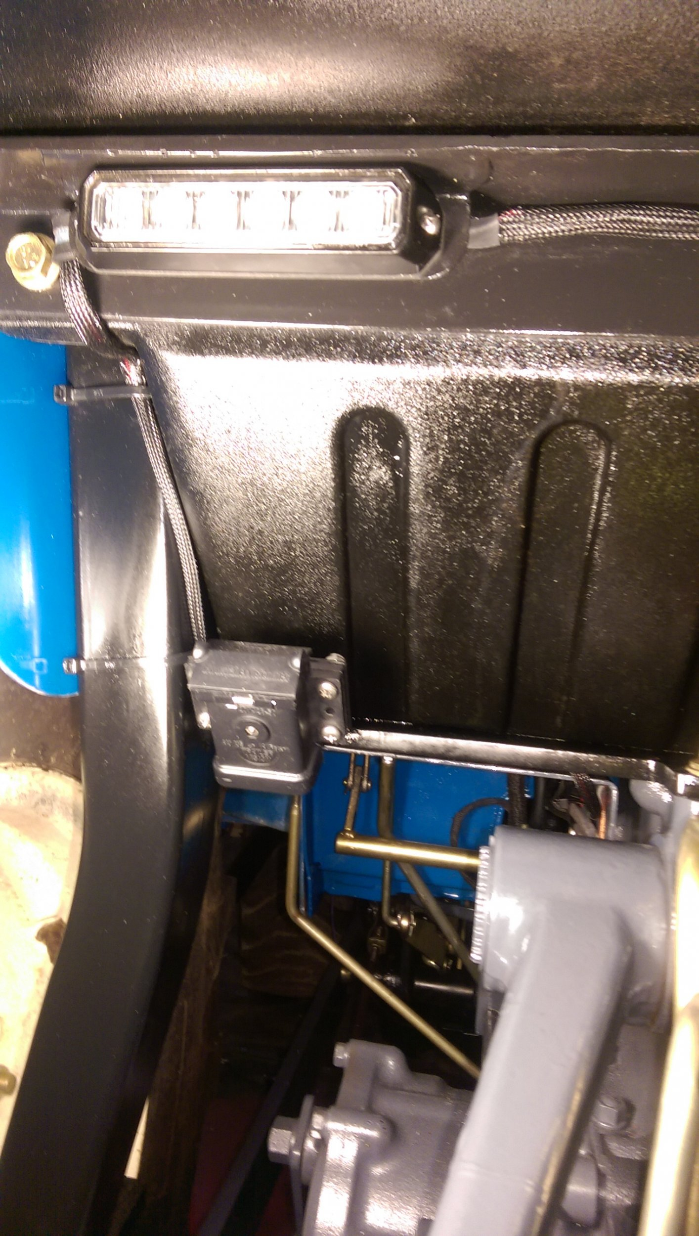

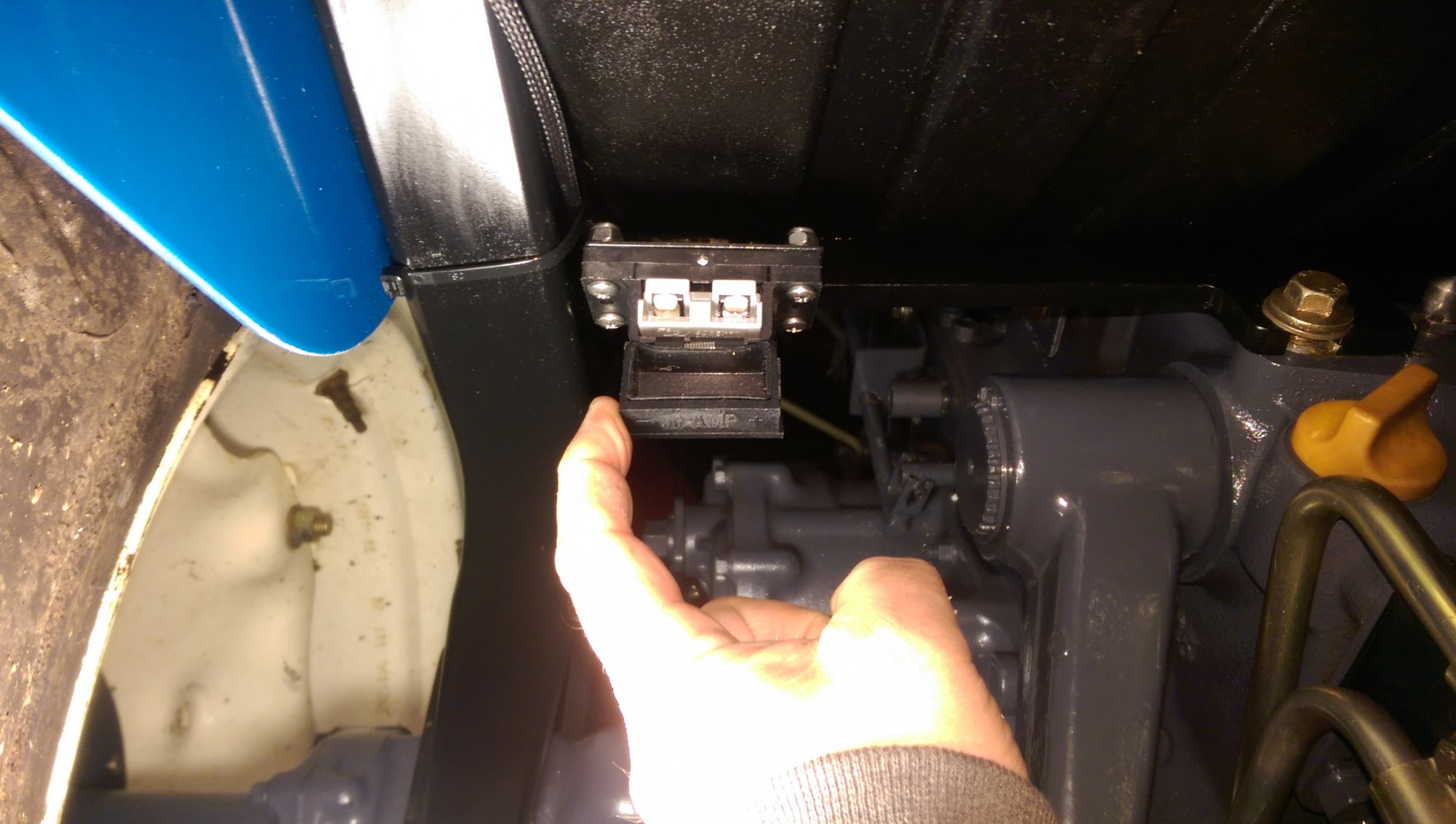

So I did something similar... I used Anderson Power Pole connectors, (still overkill for what I'm running but I got them cheap) installed one on the rear & one in front. We were tired of connecting different equipment to the rear without a good (& consistent) way. Added the Anderson connector to the tractor which are fused & switched (with relay) separately from the rest of the tractor.
Now every piece of equipment has a Power Pole connector on it... I make the harness for the equip it will work with... Anderson Power Pole connectors are quite a bit less expensive than the connector you are looking at & you don't have to worry about ordering the male or female connectors separately (if you even can)... After the Power Pole connectors are wired they only connects one way so no issue connecting it incorrectly... this also makes it easier to have some spare connectors on hand being they are not gender specific.
This is the Power Pole Connector in the housing I used... (I made the bracket)

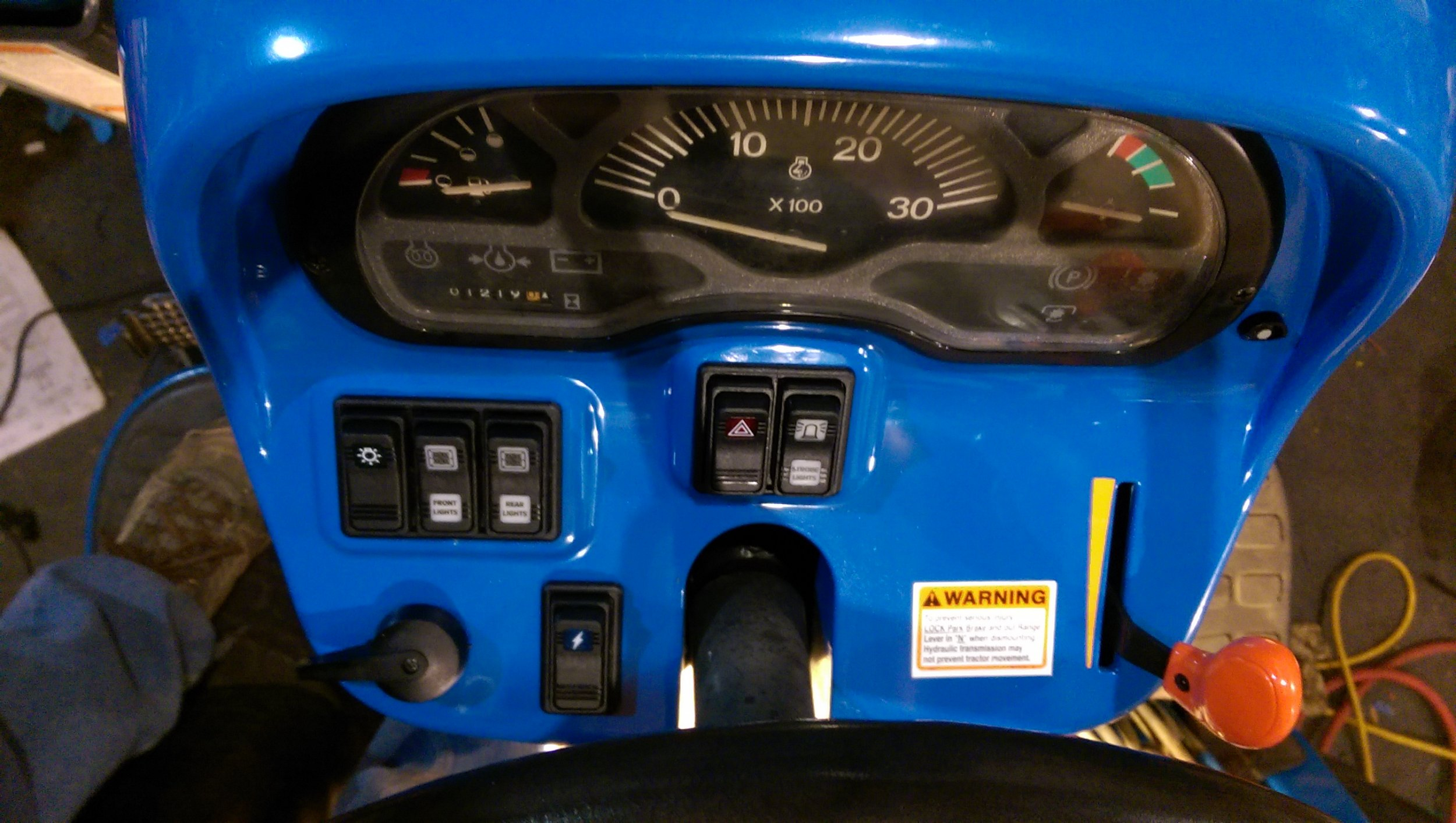

The stand alone switch on the dash controls the Aux Circuit...

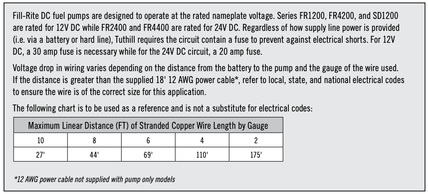

Which got me to looking at the specs of my most power-hungry connection... the one going to my Fill Rite SD1202H pump...
My pump is probably 18-20 years old (still works great!) I'm hoping the current manual is applicable...
As Roadworthy alluded: 12 AWG is the wiring supplied by Fill Rite... which is what I'll go with...
As far as the 50 amp receptacle... I'll probably stick with it strictly from a size-vs-capacity standpoint... I'll need to up grade my originally planned 20 amp fuse to 30 amps--which would fry a 15 amp Powerlet receptacle...
Something else I haven't considered... a dash mounted switch...

So, I wanted a dash switch for a few of reasons:
1.) I like the ideal of a physical disconnect incase something goes wrong, I can shut it off without getting off the tractor. I could have just connected the relay to the tractor ignition but then I would need to turn off the tractor to control it
2.) There are some pieces of equip that I wanted to be able to turn on & off from the operators seat... i.e. like one of our small sprayers had a boom on it that we use of vegetation & pest control. I can set it up in our 3pt carry-all & leave the pump on, drive to the application site & then use the dash switch to turn the pump on & off depending on what we are applying & where.
3.) I can leave equip attached & plugged in when I'm done & with the switch off I don't have to worry about something draining or drawing from the battery while it is parked. Example: This time of year we leave the debris blower (for leaves) attached to the tractor but I can shut off the circuit to the blower that controls the rotation & deflection motors when we park the tractor.
Note on the Switch: This circuit is fused separately & the switch just controls a relay... the circuit does not pass through the switch
The surface mount spring loaded covers are from Trailer Vision they are great quality, but I just looked & they are pricier then when I purchased them. However being I would only need 1 or 2 for the tractor side, I would not hesitate to buy them again... I really like them. There are a bunch of other options out there but I had used the Trailer Vision one on other project, so I knew there quality already.
Yes I'm using the Anderson 50 amp Power Pole Connectors - they run about $6 - $8 per pair with 2 connectors & 4 terminals depending where you purchase them... Just remember only like color connectors work together (red to red / grey - grey but red to gray will not work)... the only exception is the black connector will work with the grey.

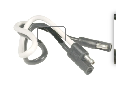

I use this type on everything I own that's 12V, tenders, lights, tractor, mototbike, generator etc, that way I know everything's compatible. Just make sure that when you install it, the female covered receptacle is on the battery side so it can't short to ground, fuse wouldn't hurt neither. Reason I went with this type in the first place is that it seems like it's a standard type for tenders. I've got three different brands and the pinout is the same on all.
The Anderson type I use on my winch because of the draw, they are a nice plug.
