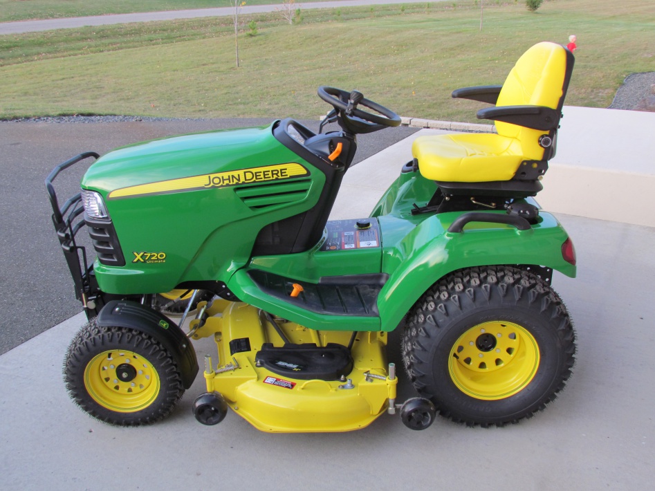

Hi everyone, new to the forum and have a question. I have a X485 that I purchased recently and need new tires. I really like the Carlise Field Trax HD tires. I can get 26x12-12 for the rear, but I can't find a 16x8.50-8 size for the front. There is a 16x8.50-10 size available, which could work if I could find a 10" rim for the 2wd front axle. Any ideas?
Thanks in advance.
/ 10" front rims for X495 #2
Yes. In addition to the 10" rims you also need to purchase the hubs for your front axle. The 10" rims bolt on to the hubs that slide on to the spindle, whereas the 8" rims slide directly on. The later model SE units come equipped with what you want.

If you get the 5 hole hubs and 10" rims it will look just like my X720SE.

Yup, that is just the look I want! I'll have HDAP's front and rear.

He is correct, but to give you an idea of cost:
M144698-Bolt, Wheel, Qty 10-$11.40
AM140109-Hub and flange assembly Qty 2-$189.28
M150676- wheel, 10x6, spl ed-Qty 2-Qty 2-$144.88
Total Cost without tires- $345.56
If you do not want the mismatched wheels, the rear SE wheels will have to be ordered. I think they cost about $205.00 for a pair. I'm guessing the total cost would be around $1000.00 with tires, just a guess,though. The rear tires M156433 HDAP are $384.80 through a dealer. I'm having trouble finding the front HDAPs

Thanks for the help. The tractor came with bar tires on the rear. I bought 2 used rear rims for $100. Already ordered the rear HDAP's online. I would prefer the fronts without the extra holes in the SE rims. Would the std 4wd front rim work?
/ 10" front rims for X495 #13
I do not know the offset is different, the other specifications seem the same.
/ 10" front rims for X495 #14
Yes the std. 4wd rims are what you want to match your rears.
