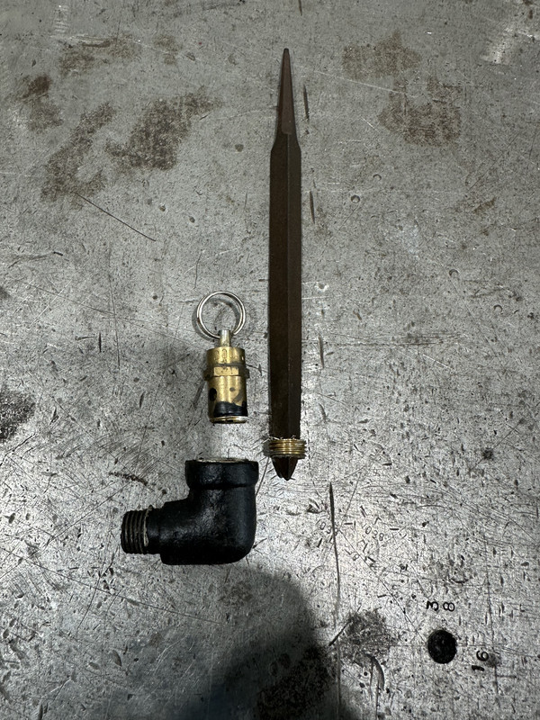

I’m one of those people that always believes in shutting off the power to the compressor after leaving the shop. I do this every time I leave (apparently mostly every time.)
I was working on the plasma table late last night, and apparently didn’t shut off the compressor. I came into a very loud Shop this morning. thankfully, no overheating, no fire, etc.
Something was missing.
Found it.
Old file as ez-out
So, time to add a timer to the outlet so that doesn’t happen again
(And time to replace all the pop off valves on this one)

Failure, agreed! Who would have guessed the device fails at a lower psi than the spring pressure?

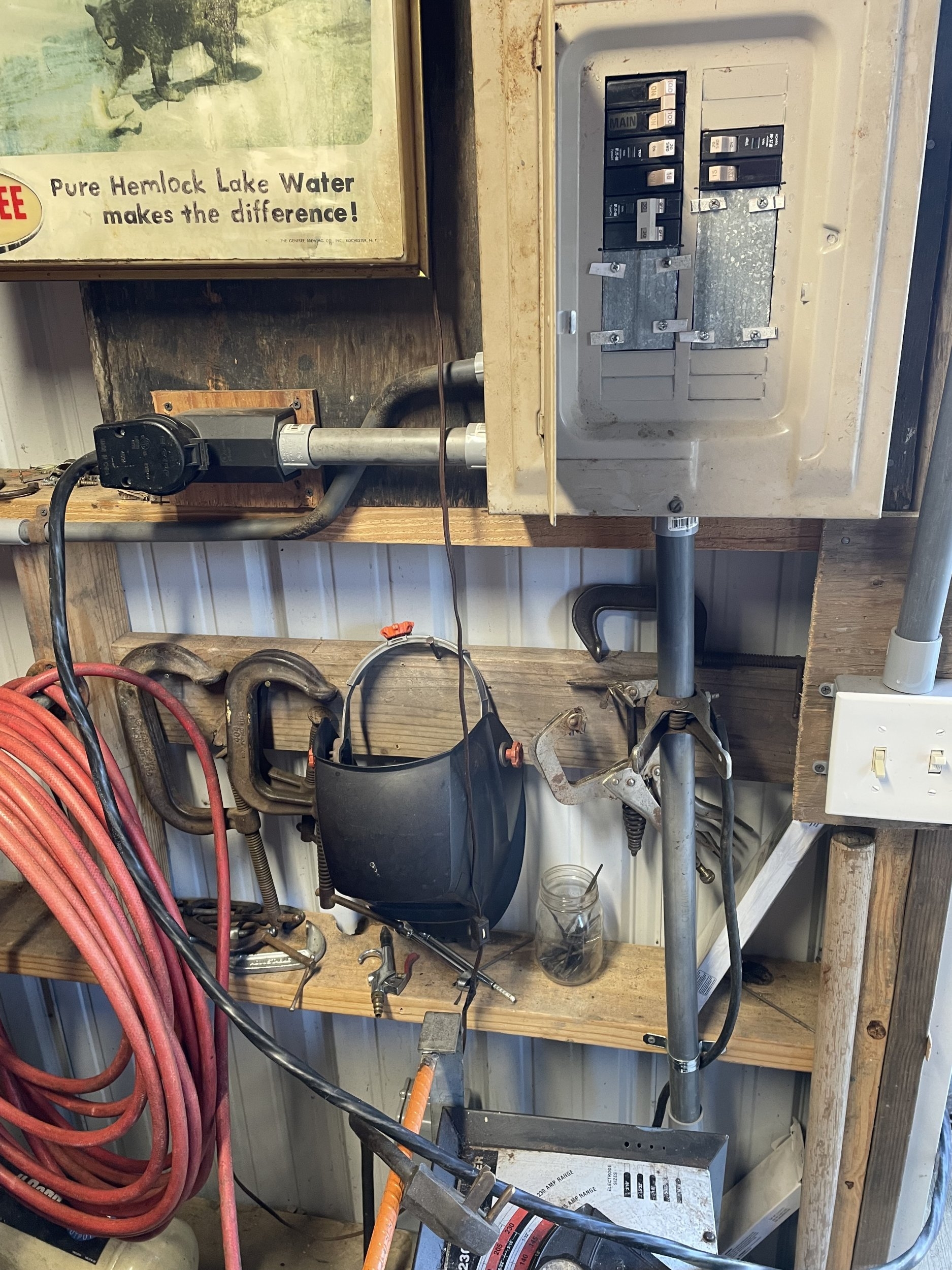

I plug a compressor into an outlet that is controlled from a switch next to the front door of my shop (on the right side of the photo below the sub-panel). The overhead LED fixture up there is also plugged into that outlet. I never leave the light on when I’m not out there so I never forget to kill the power to the compressor. Of course it’s just a little 120 volt model.
That wouldn’t work out so well with a 240 or 480 volt one. Also, I just plug that compressor into that outlet when I need it, because it annoys me to hear it come on when I don’t need it.
I have a second small 120 volt compressor on the opposite end of the shop, that I can plug into a non-switched outlet by the back door, when I need air back there. I prefer (2) small compressors, over one big one, because I always have backup that way.

It probably blew apart when the pressure went too high, instead of opening like it suppose to.
Sometimes my pressure cutoff switch doesn't cut off the compressor. A couple of times I have came into the barn to hear the relief valve blowing and the compressor running. I try to make a habit now of turning the compressor breaker off.
So..................., a new pressure cutoff switch might be needed.

Oil changed
New check valve(s) installed
Back up and running
That's good. I bet you had some anxious moments watching that pressure gauge, as it worked up to the shutoff point, eh?

I need to figure out what sort of timer would control 220v, 30??amp
@plastikosmd - I've installed a few different versions of timers / remotes for my brothers shop -
Both used 2-pole 240V 40 Amp Contactors with 120v coils (similar to this Contactor). Then for the timer circuit I just used a 120v 2hr - 12hr push button timer (similar to this Timer) to control the Contactor. Basically press the timer button from 2 - 12hr it energizes the coil in the Contactor & the compressor is only powered for that amount of time.
His other compressor is installed in a separate room so for that one I used the same contactor with a wireless remote switch / relay (similar to this wireless unit) to control the Contactor. So, this does not have the timer feature like above but we installed the remote switch right next to the light switches in his shop, so it easy to remember & he has control over the unit without walking all the way around the shop (Bonus was I didn't have to run any additional wire:))
Oh, I know they say the wireless units are rated for 30Amps but I was more worried about the start-up inrush amps the compressor required, so for the couple of dollars the Contactor cost, I felt it was worth it.
