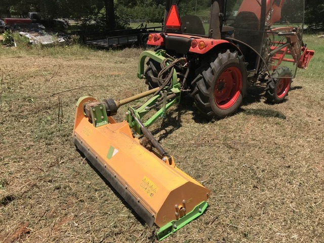

I run a 64” Victory ditch bank mower that weighs 685 LBS on my Branson 4815C. My tractor weighs somewhere around 4,000 lbs with cab and loaded tires. It handles it well but you definitely feel it when you extend it all the way out off of the ground. But never felt tipsy and I run without FWD engaged. Don’t have a picture of it fully extended in the air but here is the way I mow 90% of the time.

How do you like that? I have pretty well convinced myself that I would prefer something like this to an RC. I need to keep cost down, but I don't want junk either.

I really like it and glad I bought it but I did have to replace the pillow bearings on the rollers. The ones that came on it did not last long and I am very conscientious of keeping them greased and the grass cut off. I put a much better bearing on but had to modify the housing to get it to fit. Interesting enough grass doesn’t wrap around quite as bad.
My dad warned me when I bought it that I was not going to like it because of the maintenance it takes to keep it going. So far I have not found that unreasonable except when I decided to sharpen the hammers. If dad was still alive he would have gotten a call that day letting him know he was right! That took half the day and I have not run a grinder that much since I quit building trailers. :oops:

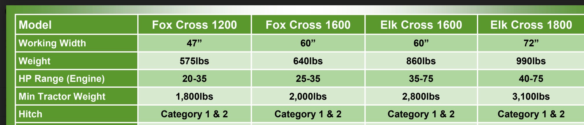

Yeah, I'm just getting advice all over the place, trying to compare apples to apples. Peruzzo lists pretty mowers as compatible with smaller tractors. My advice from a Del Morino dealer was more conservative. I'm not trying to be argumentative, but the only chart, or rule of thumb I have is the one attached.

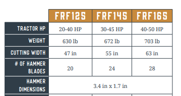

I'm looking at the FRF 165. I cannot find any info on the size of the hammers. It seems most of this size/type have either 400 or 800 gram hammers. Anyone know what these have?

They give dimensions of the hammers but not weights.
Do these match one weight but not the other? or are the heavy hammers just thicker?

From what I can tell they are thicker. Most of my use will be heavy grasses and brush, no lawn.
It can be hard to figure out some of these various flail mower brands. Most are Italian, but a few are Chinese. Same units marketed under different names.
