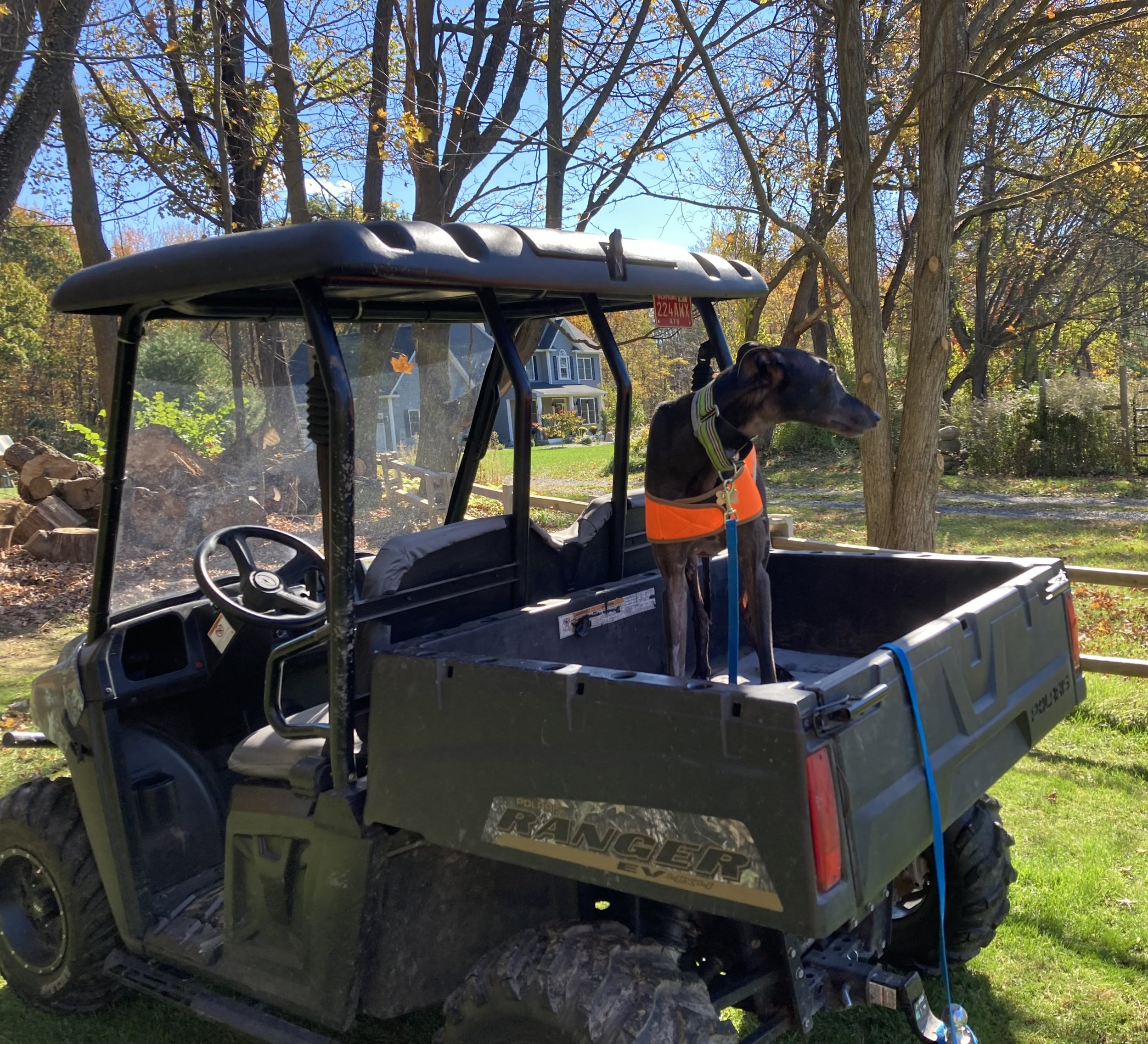

I have a 2012 Polaris Ranger EV.
Bought it used on Labor Day 2020.
It had 336 hours on it with 8 48V new deep cells recently installed plus the optional extra 2 lithium’s to add a little power / range .
I love ❤️ the thing .
Besides about the 10 gallons or so of distilled water and some grease the operational costs have been zero .
Plenty of range and power to work all day around the farm.
Whisper quiet, have it registered and insured to run down the road .
Female and dog friendly.
Just really love ❤️ it and won’t ever be selling anytime soon .

/ Electric UTVs #13
No the 2 extra batteries just power up the 12V things.
Lights , winch , plug in accessories .
Never really looked into it that much because I bought it that way and the units been flawless so far.
The main batteries 🔋 are down to about 85% after 2 and a half years of ownership and routine maintenance.
