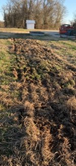

So, I just hooked my new disc harrow up to my new machine. This was the first time to hook anything up to the three point hitch. I was surprised that the discs did not go down in the ground any further. I "Assume" I hooked it up correctly, but when I put the 3pt down as far as it will go, the discs only go in about 4"-5". I am attaching some pics. I don't know what else to say. I hope the pics are good enough for y'all to tell me if everything looks normal. Ask me questions if ya have any. Thanks a bunch! ! !
27AFC8B1-7D5E-4CA8-93F3-78B481E77F3D.jpegA03CCDF4-0ACD-4AB7-A4D4-8E624242814B.jpeg8D0BC89A-0932-4B94-9666-E7C33DD14BB3.jpeg4D5C702E-941F-4865-8C61-77BA13830AFE.jpegB650B7FA-E181-4F9E-9884-9633B4FFA51E_4_5005_c.jpeg

You're cutting in new ground that hasn't been cut recently. It will need to be cut a few times. After I made the cuts in that direction I would probably cross cut it once and the third time should do it. You may need to play with the center link as well. That's where you add or remove weight from the rear set of disc blades. You will find the front set does most of the heavy lifting. Just stay with it but that looks normal for a light disc harrow like you have.
/ How far into ground should disc harrow go? ? ? #3
What you are seeing is not unusual on unbroken ground 3 point disc just don't have the weight per blade to really dig.

OK. . . Good to hear. Yes, I plan to go over it quite a few times, then I will be tilling it with a walk behind tiller. Then I have a BIG job in a week or two. That being, discing and dragging about 10 acres. Disc, Disc, Disc all diff directions, then drag, drag, drag. 13 years ago my pastures used to be watermelon patches and they still have furrows. I will then have them sprigged with Bermuda. I'm just glad to hear that it looks normal.
So, do I turn the top link where it pulls harrow forward to get the front discs in the ground a little more aggressively?

My soil is very much sandy loam, and is easy to dig into. The difficulty comes with the weeds that have been growing for years.
So, I want to try to understand. . . my DH is not as deep as it could be, but if I had some decent weight on top of it, it would set further down in the soil? ? ?

The tandem disk is a secondary tillage tool. To get compacted ground worked deeper, you need to plow first.
Weight bearing on each pan, pan diameter, pan spacing and pan adjustment are the key factors relative to soil penetration.
Most of the Disc Harrow weight is in the pans. A Disc Harrow with 18" diameter pans is too light to reasonably break hard soil. A Disc Harrow with 18" diameter pans requires multiple passes to smooth recently plowed ground even under optimum conditions.
A Disc Harrow with 20" diameter pans is the first weight Disc Harrow with enough weight bearing on the pans to penetrate reasonably well.
An MX with cab should pull a TPH Tandem Disc Harrow with 22" diameter pans covering rear tire tracks through all soil types.

I would start with maximum angle/set in the gangs and adjust the top link for optimal cutting with front gangs. Make multiple passes in several directions. Easier after a rain soaks in the ground and you can work it again. Not muddy but not too dry.
~~ YES ~~
An MX has a Category 2 class Three Point Hitch. If weight is added to a relatively light Category 1 class Disc Harrow you may over stress the frame and pull it to distortion or destruction. Once distorted the ability to adjust gang angles is lost. I discourage adding weight. Owner added weight is outside the stress parameters calculated by Disc Harrow designers.
Shorten the Top Link and adjust gang angles aggressively for penetration. If that does not do give the penetration you need, you have too light an implement.
