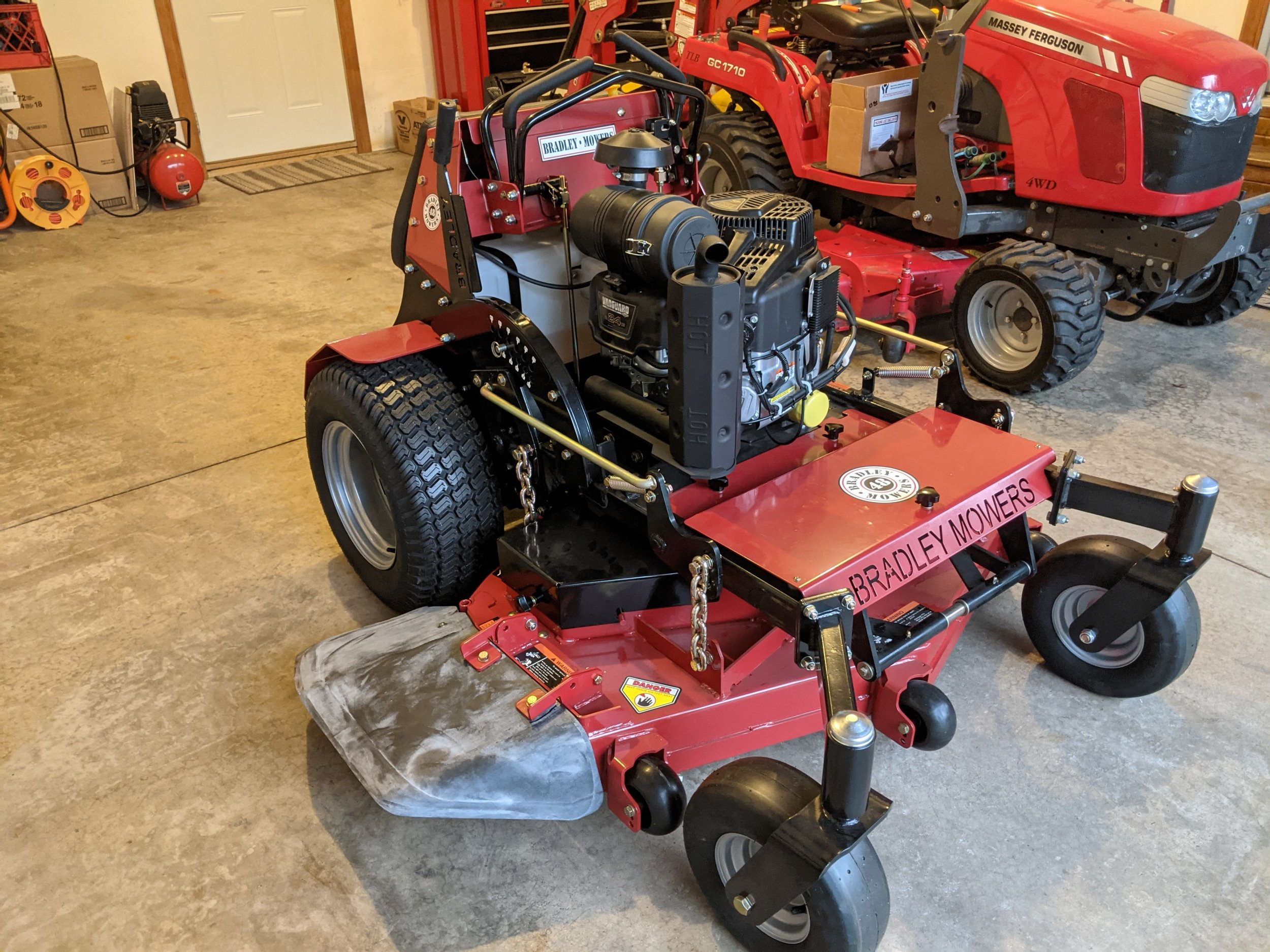

You have used the words “stander mower” several times in this thread and I’m not sure what you mean by stander ? At first I thought maybe you were talking about one of those zero turn mowers where there is no seat so you just stand on the backend on a platform to operate it.
Yeh that's the one, there's a pic of it on the first page of this thread.
Well I looked at the first page again and there is no picture of a standup zero turn mower. Exactly what post number are you referring to ?
It's the second post on page 1. Here's another pic:
Roy, yeh around here most commercial operations are switching over to stand-on mowers. I don't mean to age you, so don't mean you specifically...but in general if you're an older fella that don't do well on their feet for extended periods, these ain't right for you. Or lets say it's just long flat fields to mow, probably better to chill on a seat. Otherwise, standers are better in every way, including way more fun.
I am an older guy (72) and I ain't too proud to set on my ass when mowing. Plus, a bad leg (stroke 22 years ago).
Don't think it's just older guys...there's a lot of younger to middle-age that probably couldn't stand long enough to mow 2-3 acres.
Stand-on mowers may be popular with commercial mowing...don't see them being too popular with most home users
