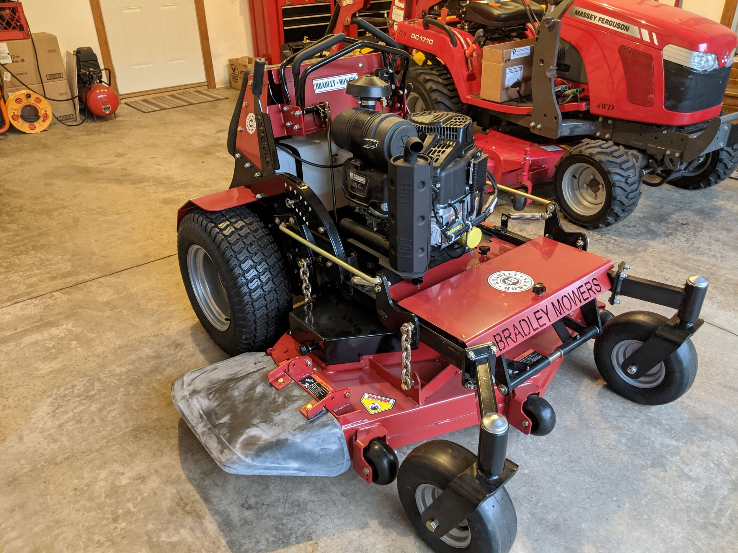

Regarding the standers....I personally hate them. They suck mowing under trees because standing on a mower you are taller than sitting on a rider. And you use your wrists to control, and no armrests. And yea, standing in general sucks.
My friend that owns a landscape business owns standers and riders. There are only TWO benefits to a stander as far as mowing and business is concerned.
1. They are cheaper
2. With employees....they are more likely to get off and move trash/debris rather than mow over or go around.
Having choices is great, so to each their own. Mine's actually a commercial mower, and goes 10 miles/hr.
More benefits for a stander over sit-down mower, I could hop off my stander and use it like a self-propelled walk-behind. In soft ground areas (although I usually don't mow there until it thoroughly dries out), being able to instantly decrease the weight of my mower by 150 lbs is pretty nice.
Around trees, you duck or squat, or get off the mower and walk next to it. Can't do that with a sit-down mower.
1.
2.
3...they take up less room on a trailer.
4...landscapers prefer them to sitting on a ztr all day.
