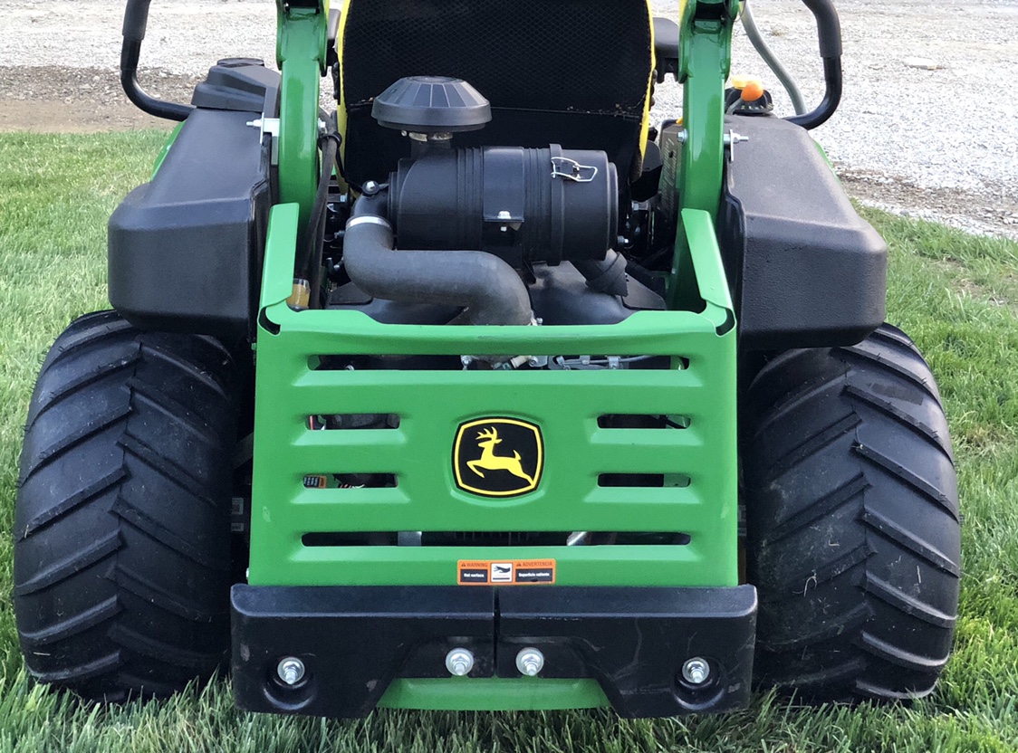

Just ordered some Kenda Tires | Turf / Trailer / Specialty | K5�2
for our zero turn. I look forward to getting them mounted up and see how they do. Hope to prevent the sliding down the hill issue more than anything.

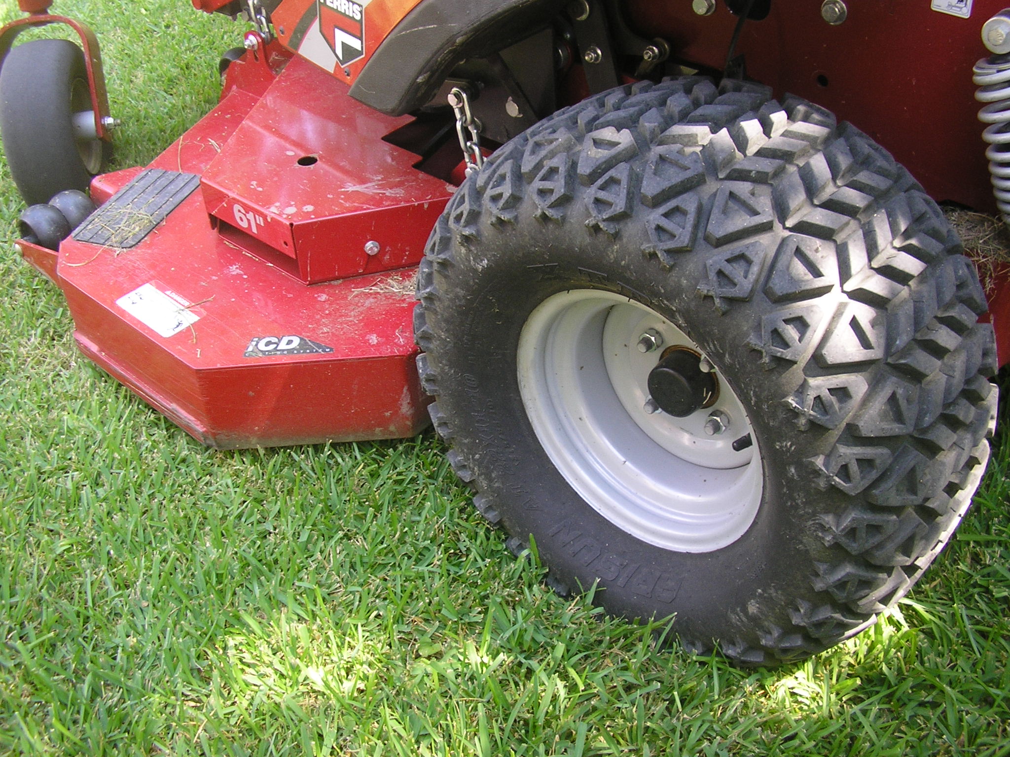

Good luck. These Golf Cart tires shown, didn't work for me like I expected from looking at the tread design.......still too much rubber/cu in of contact area. Changed them out for the ATV tread I mentioned which work.

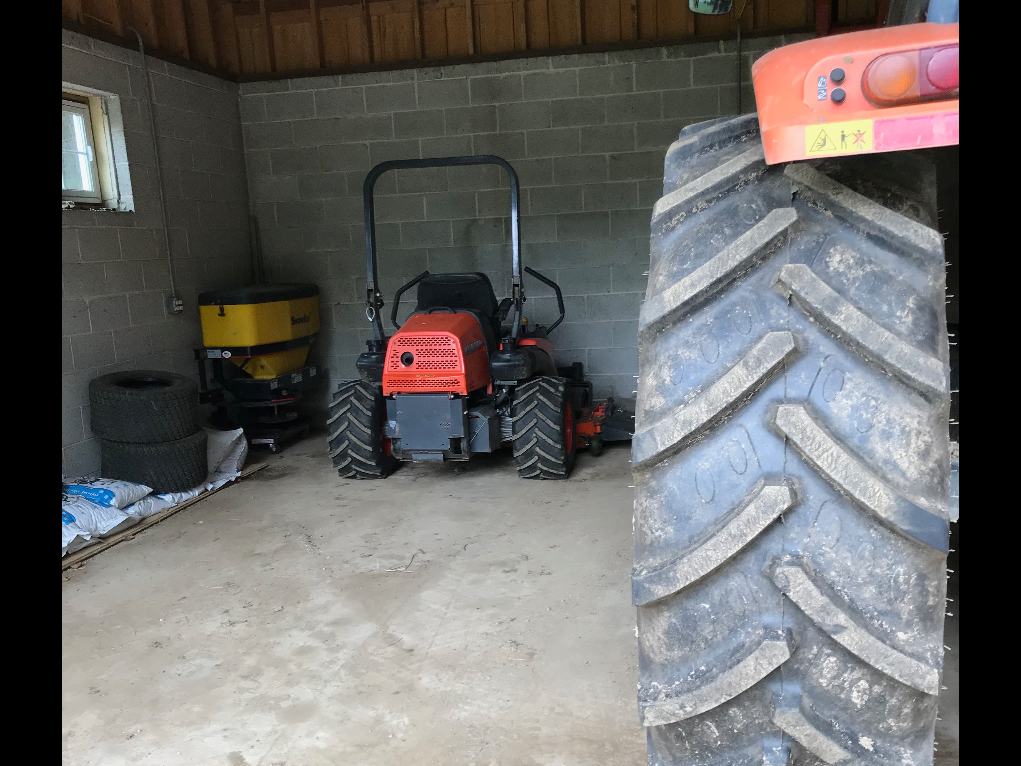

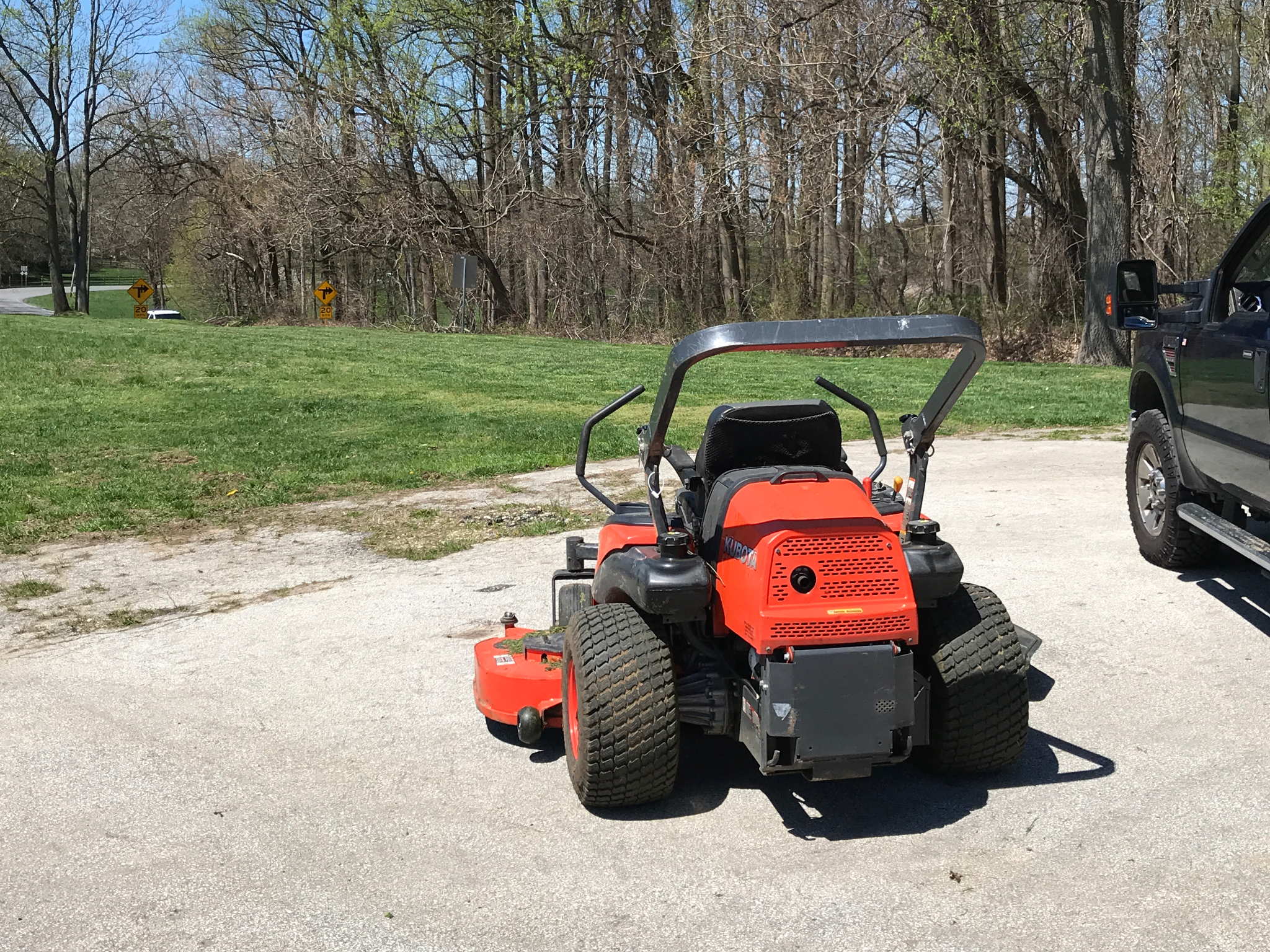

Carlisle AT101’s are in my opinion, the best traction tire for a zero turn machine. They offer great traction compared to the turf tires and don’t tear up the yard. I have mowed very steep and off camber terrain for many years...
Tires

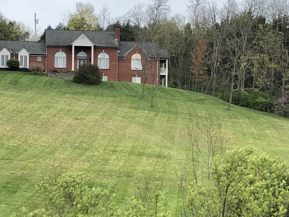

Example of hills

That is the same mower I have, in the picture posted.
