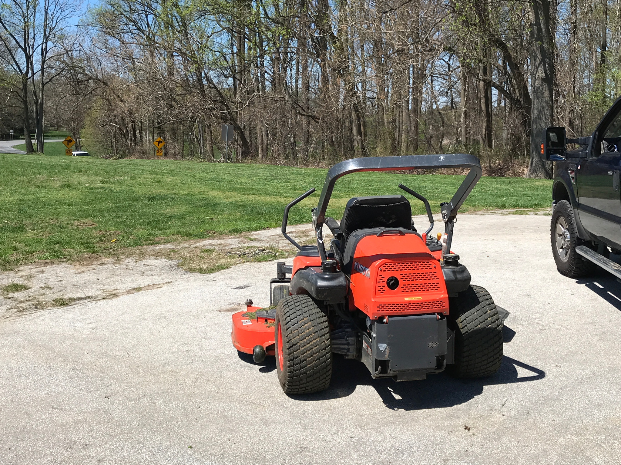

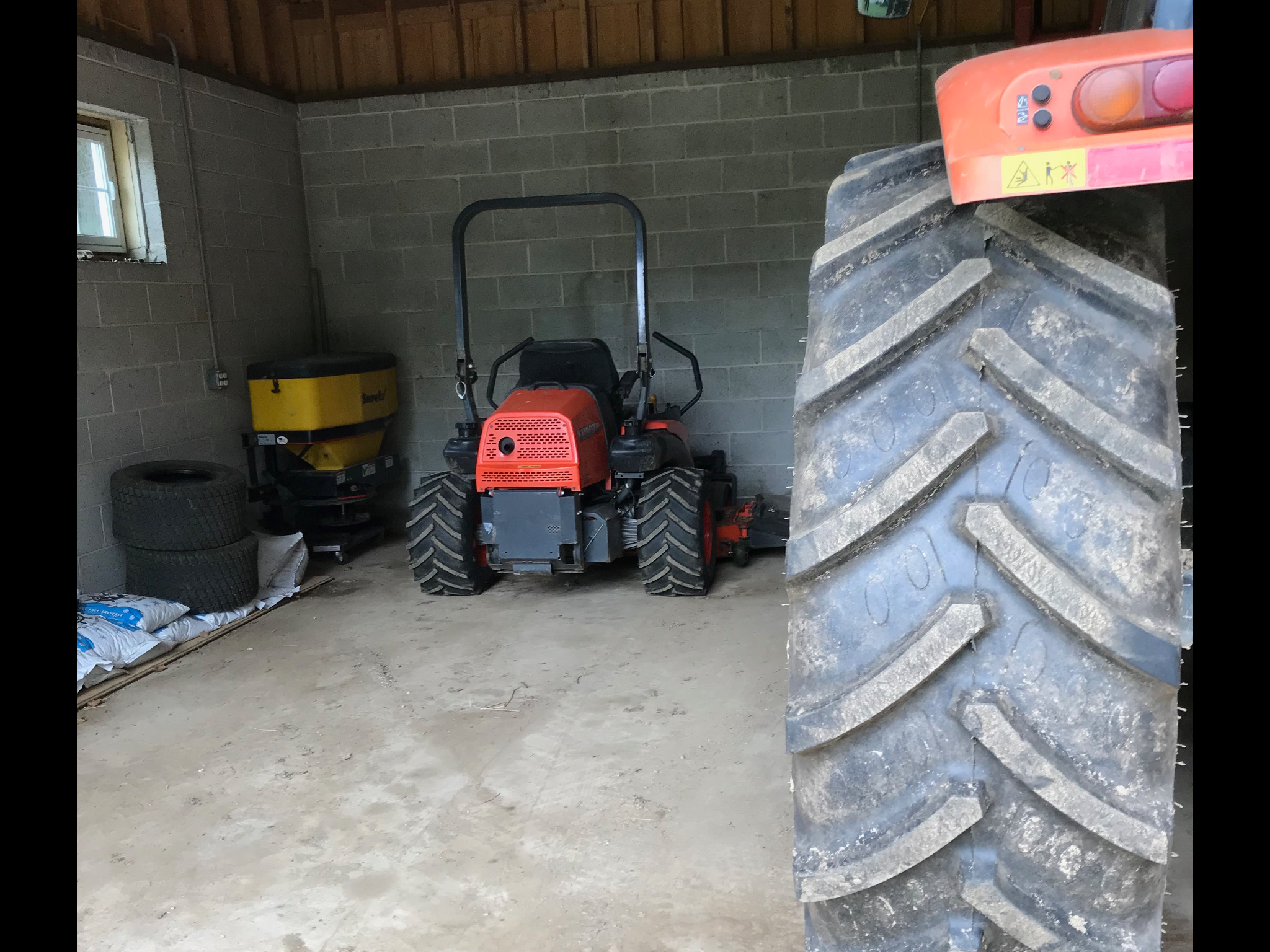

Before and after pics
Note Turfs now have become a "garage ornament" aka "clutter".
My unit weighs 1,812
Looks like a 428d weighs 1,360
Pretty close in weight
/ Zero turn bar tires #27
Those look look real tractor tires and not the ZTR version that’s on mine and DK35s mower. Yours probably have stiffer sidewalls and I imagine you can run them nearly flat with just enough air not to run off the bead.
#28
Theyre Carlisle "Tru Power".
I took them down to 14psi and I could make sidewalls leak a little by pushing in on them with my foot.
That could also be from the tires new bead not being well-seated yet.
