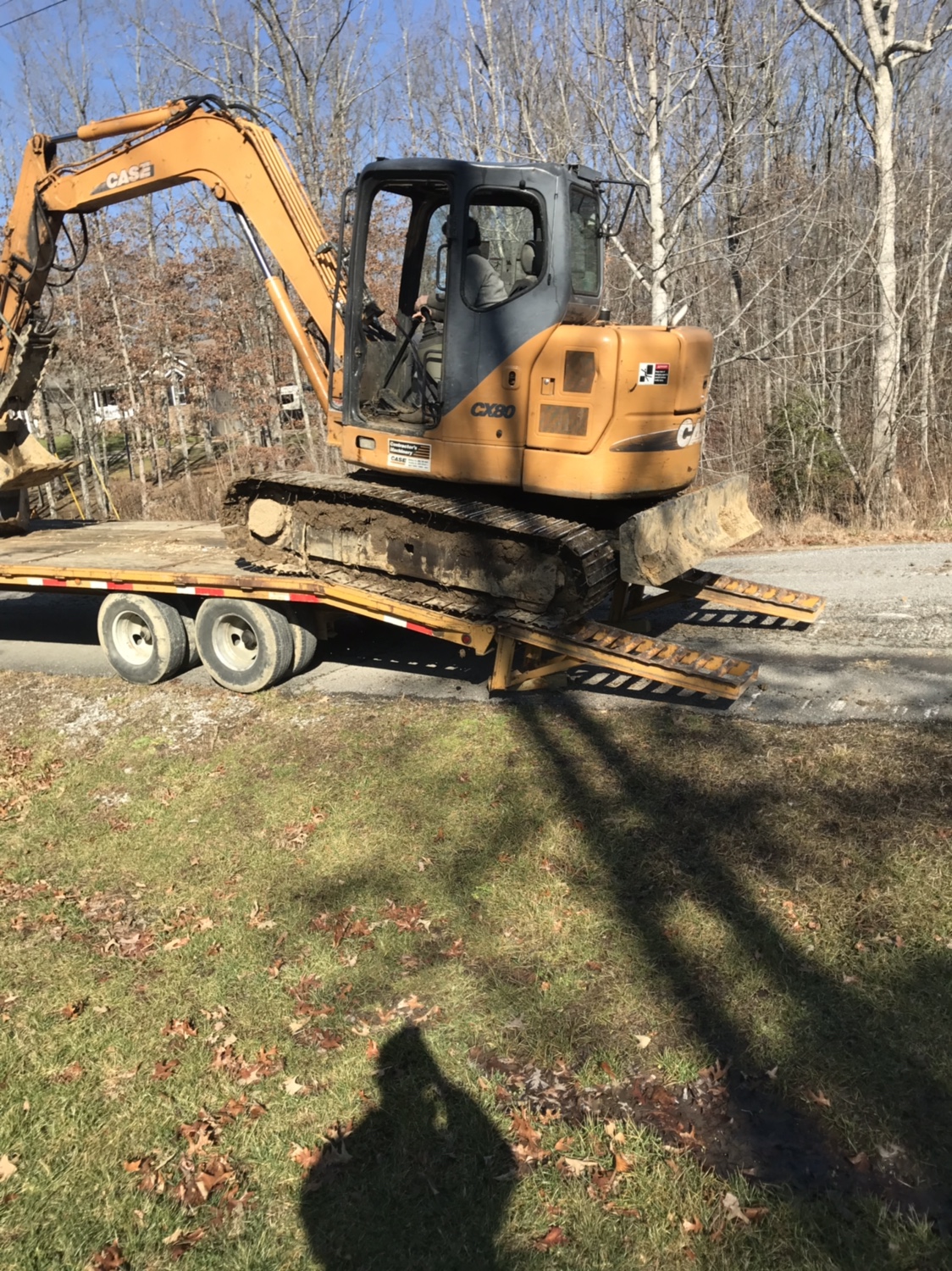

My deck over trailer is already bad to load. You’d need 10’ ramps to reasonable load without a dovetail. IMG_9482.JPG

I got a lighter duty equipment trailer (14k) but it has roughly 55" ramps. Even with the dove tail my SCUT feels like I'm climbing Everest. I'm debating what to do. I want a minimum of 6' but I've looked at some 8'. I also need to figure out how to handle my narrow front end tractors.

I think it normally feels a lot worse than it really is. We went away from ramps a few years ago for our delivery trailers. We can justify multiple trailers as a business, I realize not everyone has this luxury. For our everyday deliveries of compact tractors, we use 14.9k GVWR tilt trailers. 6' fixed deck in front, 16' tilt portion. That allows a couple of implements to be set up on the fixed portion, and it gives us a fairly gentle ramp angle. And we aren't messing with ramps. We rarely approach the max GVWR, but it's just nice to have a bunch of margin when hauling daily. 17.5" tires, oil bath axles, hidden winch. For the heavier or bulkier loads, or doing multiple tractors we have a 32' hydraulic dove gooseneck. We use that much less and it is a chore to get into most driveways.
For times when we need a really shallow ramp angle, like hauling a car for a friend or something, we built some 4' long ramps that taper to nothing on one end are about 8" tall on the other. Made out of 2" thin wall tubing and angle iron cross pieces, so they aren't a chore to carry. They have a notch so that the tilt trailer (or hydraulic dove) can set down on them. That extends the ramp so to speak and makes a very gentle ramp angle.

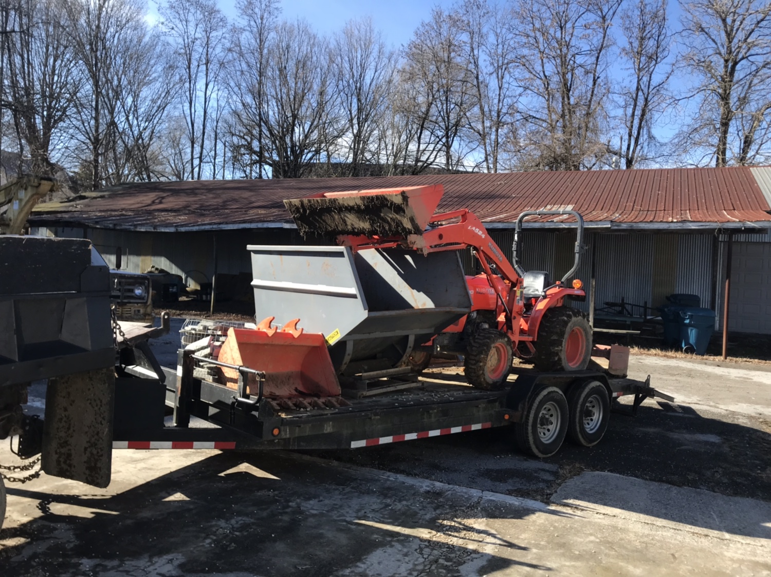

If you were delivering tractors everyday a tilt trailer would be a definite advantage. But the downside is they weigh more and cost twice as much and are more limited for loading stuff and then driving on. IMG_9434.JPG

It's all a compromise. The 6' fixed front deck on our tilt trailers helps with some issues. Tilts aren't so good loading an excavator or Bobcat in slick conditions either, ramps work best for that. And your point on the tilt being heavier is very true. As mentioned, in California if your trailer is over 10k GVWR it requires a CDL. Trying to stay under that with a heavy-duty tilt doesn't let you carry much. I gave up long ago and got my CDL.

That Blackwood flooring is expensive but seems to be popular because it gives more traction loading in damp conditions. For those who need/want it, and can afford it, Im glad they can get it.

The blackwood stuff wears off pretty quick, especially if your loading equipment a lot.
1/2 bar stock welded on the ramps every 10 inches is the best way to keep from sliding all over the place in rain and snow. Plus it lasts the longest.
