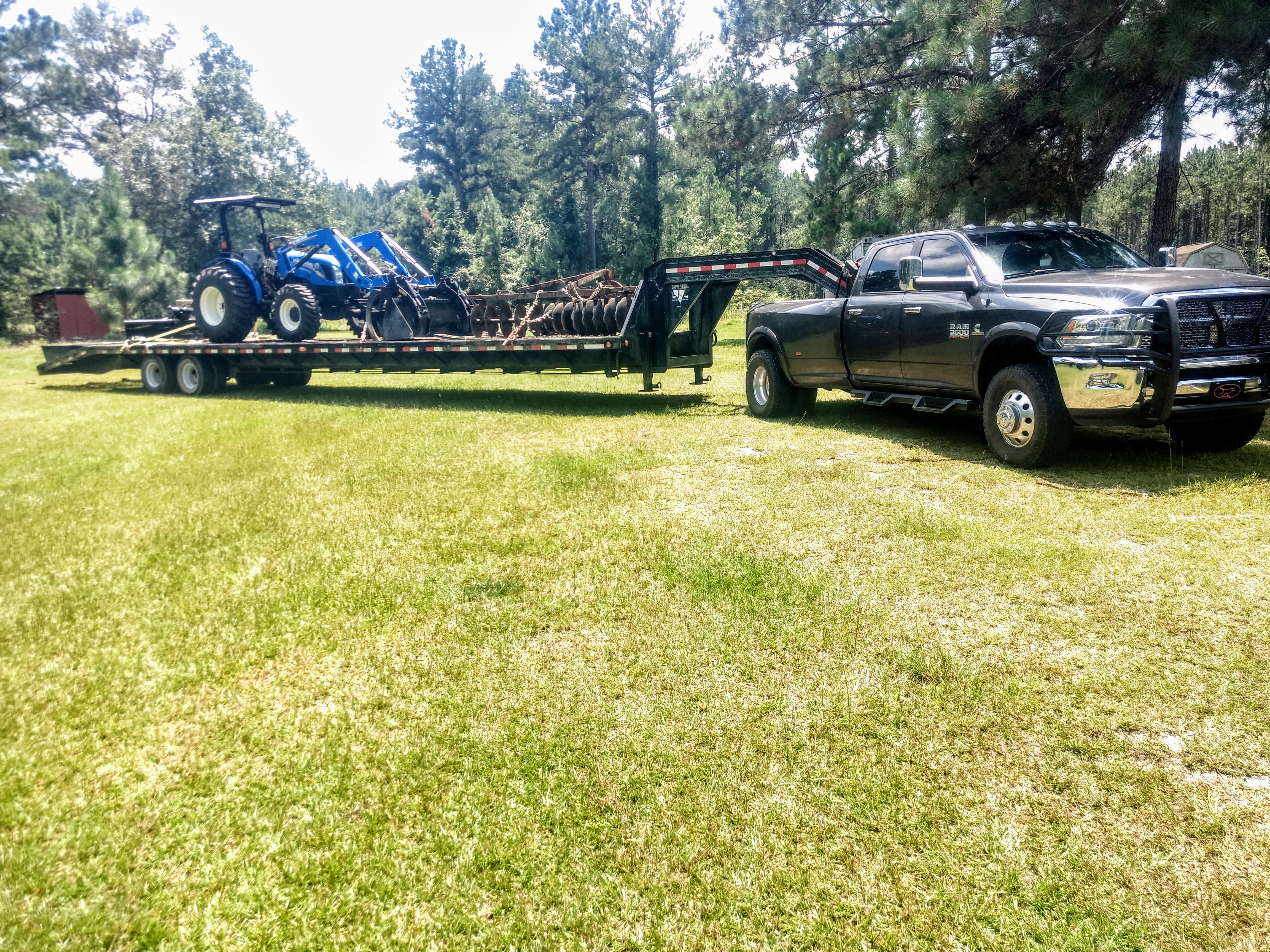

16' Ram 3500 Dre, Aisin transmission, 4.10 gears with a 35' + 5' dove tail, dual tandem trailer with triple ramps.

What does that 40’ trailer weigh? If it has 12k axles, would you feel comfortable putting 20k lbs on it?
I want a 40’ gn, but as the length goes up, the weight capacity goes down.

Taking a quick look at the Big Tex website their trailer with 12k axels at 35+5 long can’t haul 20k. Its payload is 17k and weighs 8900 pounds.

Nice setup !
Rgds, D.
Thanks man, I hope to be driving the same rig 10-15 years from now. Figure buy once cry once. Lol
It's a PJ classic flat deck trailer and they don't list the weight with dove tail just straight deck. If I remember right they said about 8,500 lbs. So that's 16,500 lbs capacity left. The hitch is the limiting factor on mine at 25k lbs max rating.
But, I believe you can get an upgraded GN hitch rated for 30,000 lbs & twin 15k lbs axles which gives you a GVWR of 30k. That would leave you 21,500 of capacity on this specific trailer.

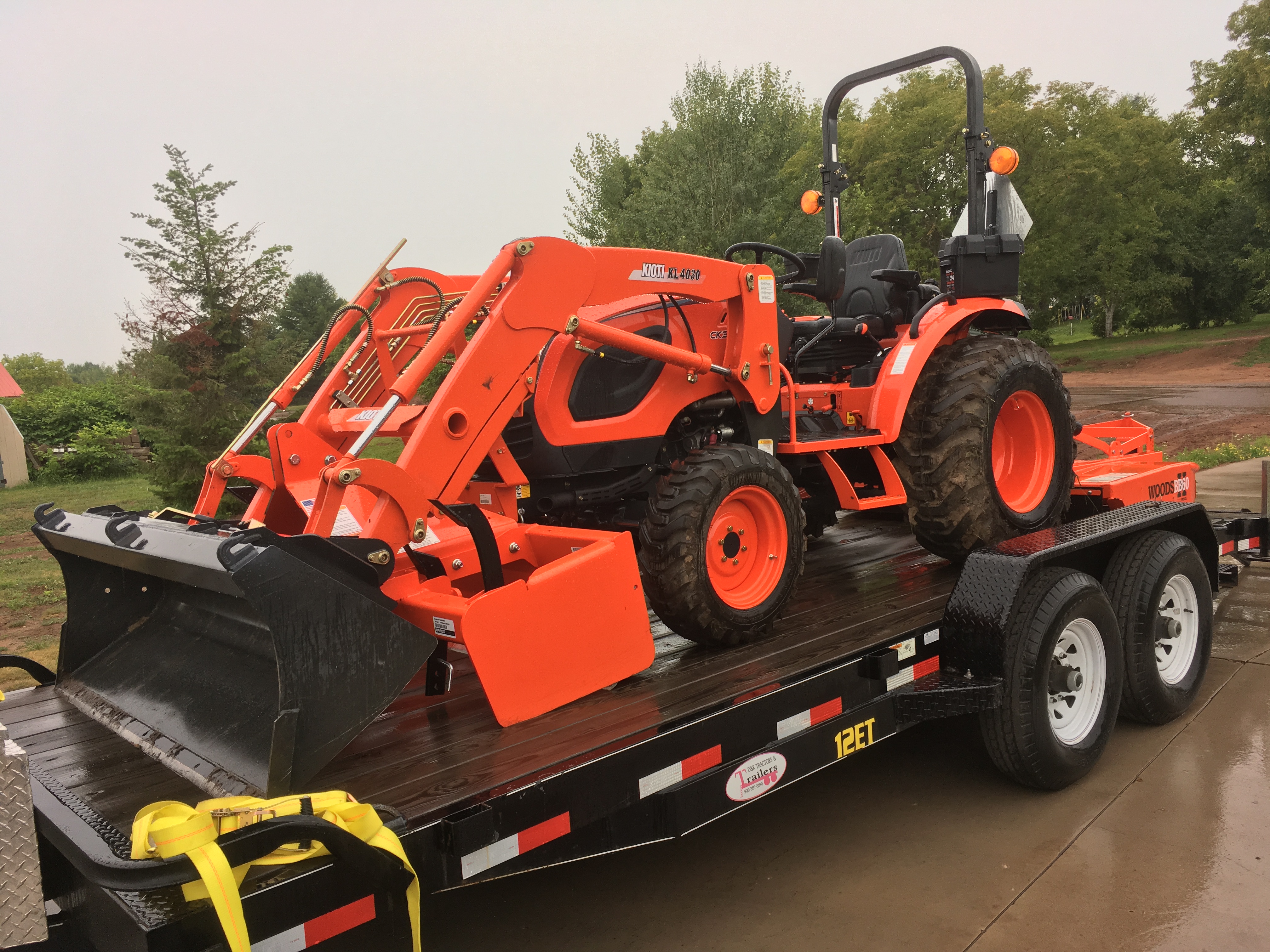

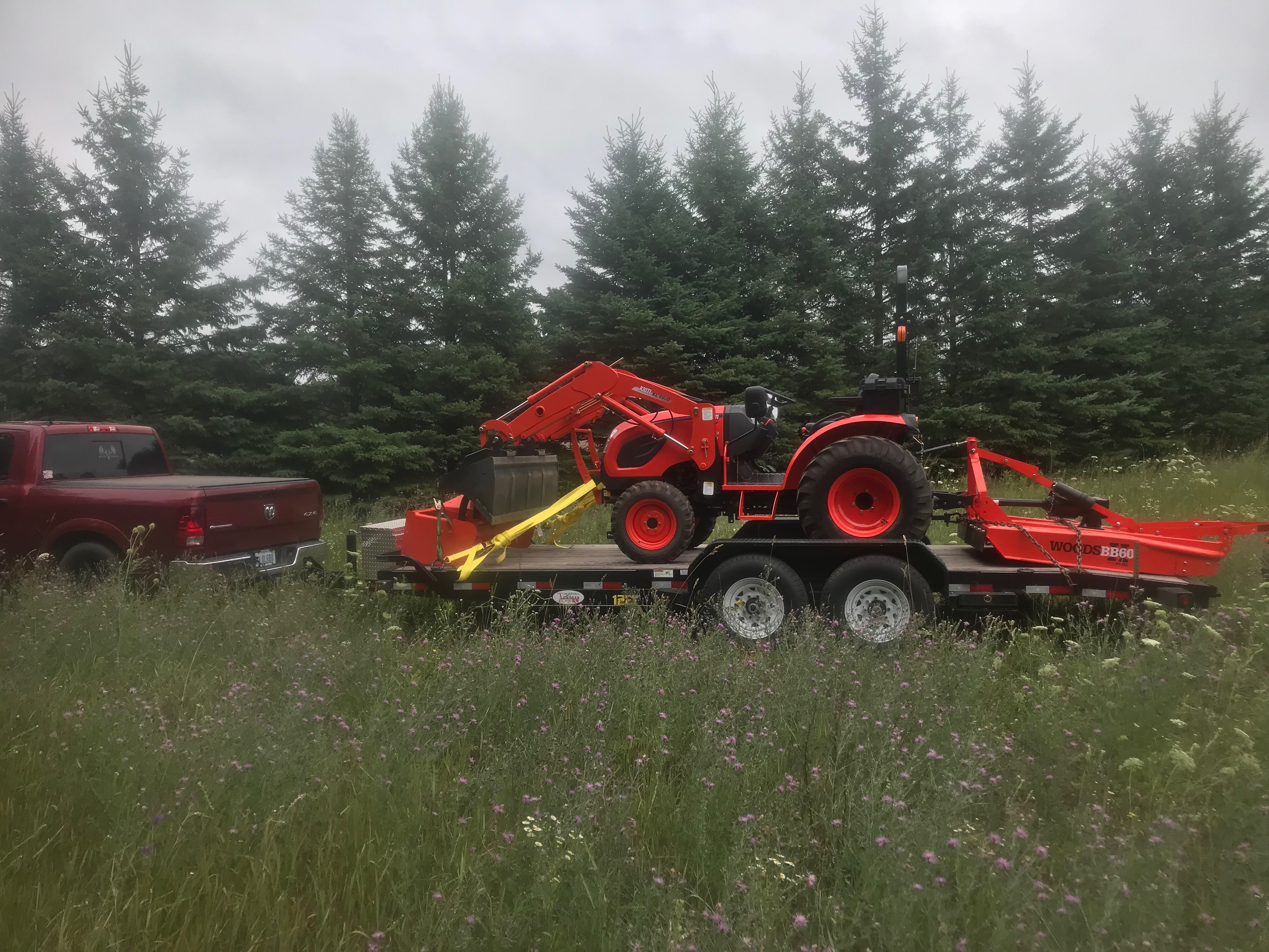

My rig 14 Ram Outdoorsman and a 20' Big tex/12k limit trailer. Tractor is a Ck3510SE (2734lbs) FEL (840lbs) with filled tires (235-250lbs/tire). The Bbull (604lbs), Bblade (514lbs) and I brought home a Lpride tiller (362lbs). This adds up to 5554+2800 for trailer is 8354lbs. I pulled her 200 miles each way at 55-60mph with no problems at all. It did squat down a bit and definitely more on the way home with tiller in the box. Im hoping my other tires and adding some airbags will help to mitigate that issue.
