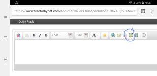

How does one post pictures on a phone on this site?
   / Your towing rigs and trailers #3,004
Hit the button I circled in the below picture, select 'From Computer', select 'Choose File', select the photo you want to upload, and select 'Upload File(s)'.
