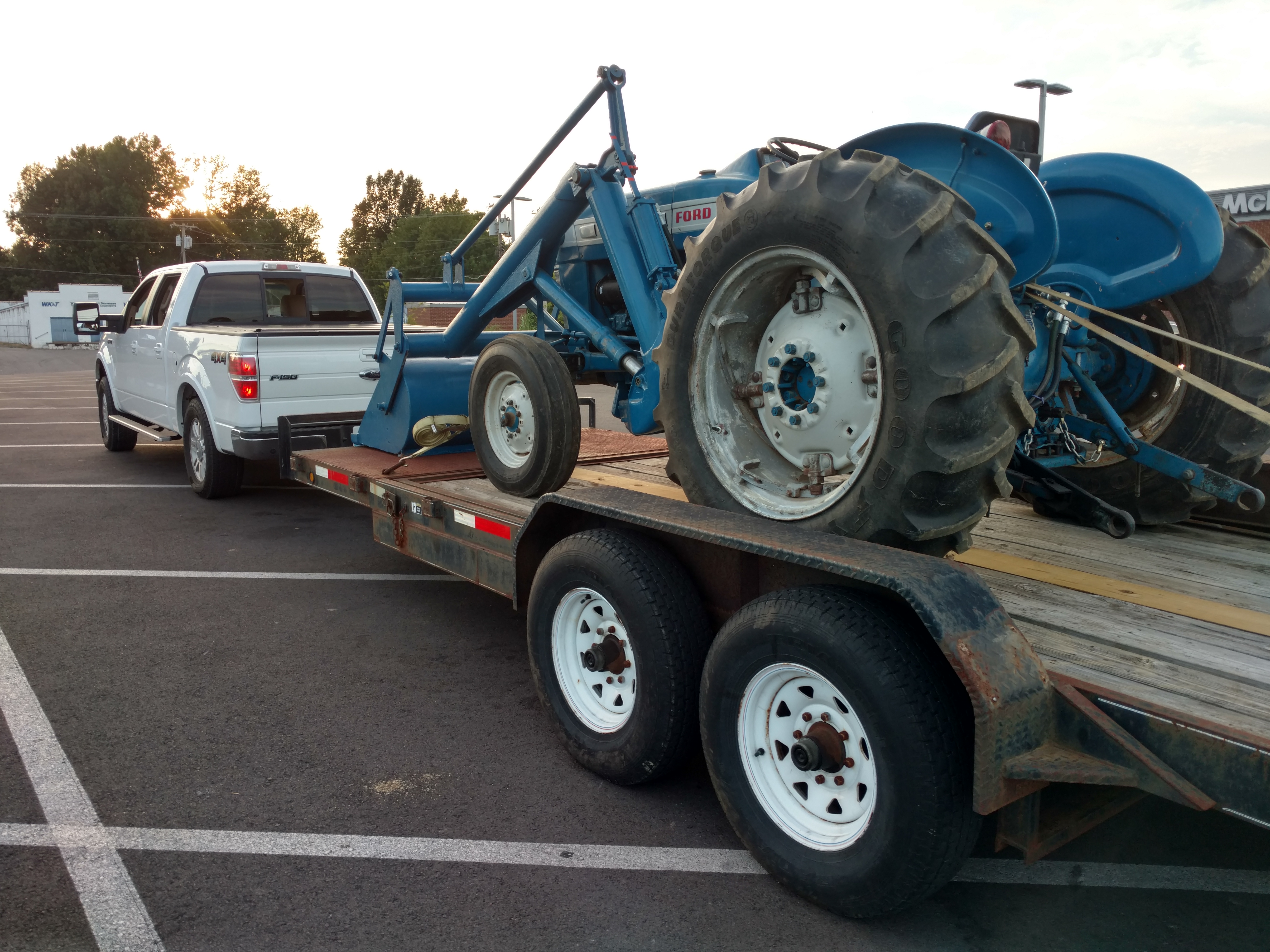

This is the 2008 22' with 18' tilt bump pull trailer with two 7K axles that we picked up last Monday in Goreville IL that will be Ford Blue in the next 12 months. This was our first trip with the recent 205K mile 2010 Ford F150 with the 5.4 engine and six speed automatic rated to tow up to 11.2K per Ford due to the Max Tow set up at we picked up recently. I just got it back from the body shop for the rust, side wipe and cracked up windshield that it came. I am getting excited about the truck the more I learn about it and its condition. The tractor is the daughter's 1966 Ford 3000 with the 711 Ford one arm loader so we now plan to do the antique tractor show in Paducah KY next month.
I love the No Ramps feature and it handles well. The back up camera in the F150 sure makes a one man hook up go faster. The hitch is going to be white soon so it shows up well in poor lighting.

Nice looking rig and '66 G :thumbsup:
Post some pics of you and the '66 at the show in the Ford section when you can please !

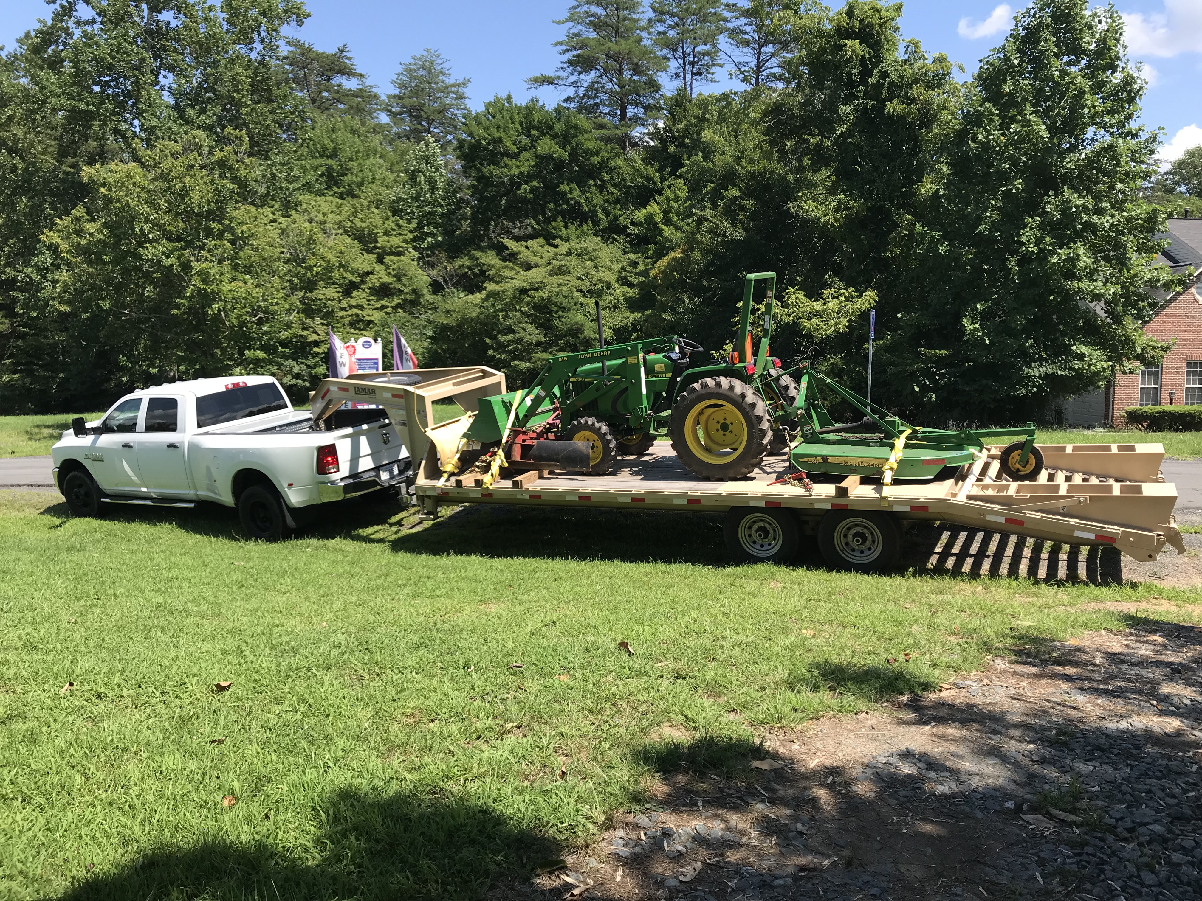

Just picked up a cherry 790 and a few implements yesterday. Only 2xx hours on the little girl. 95983FD2-2F7E-41AA-820F-9FE500CF5E7E.jpeg
