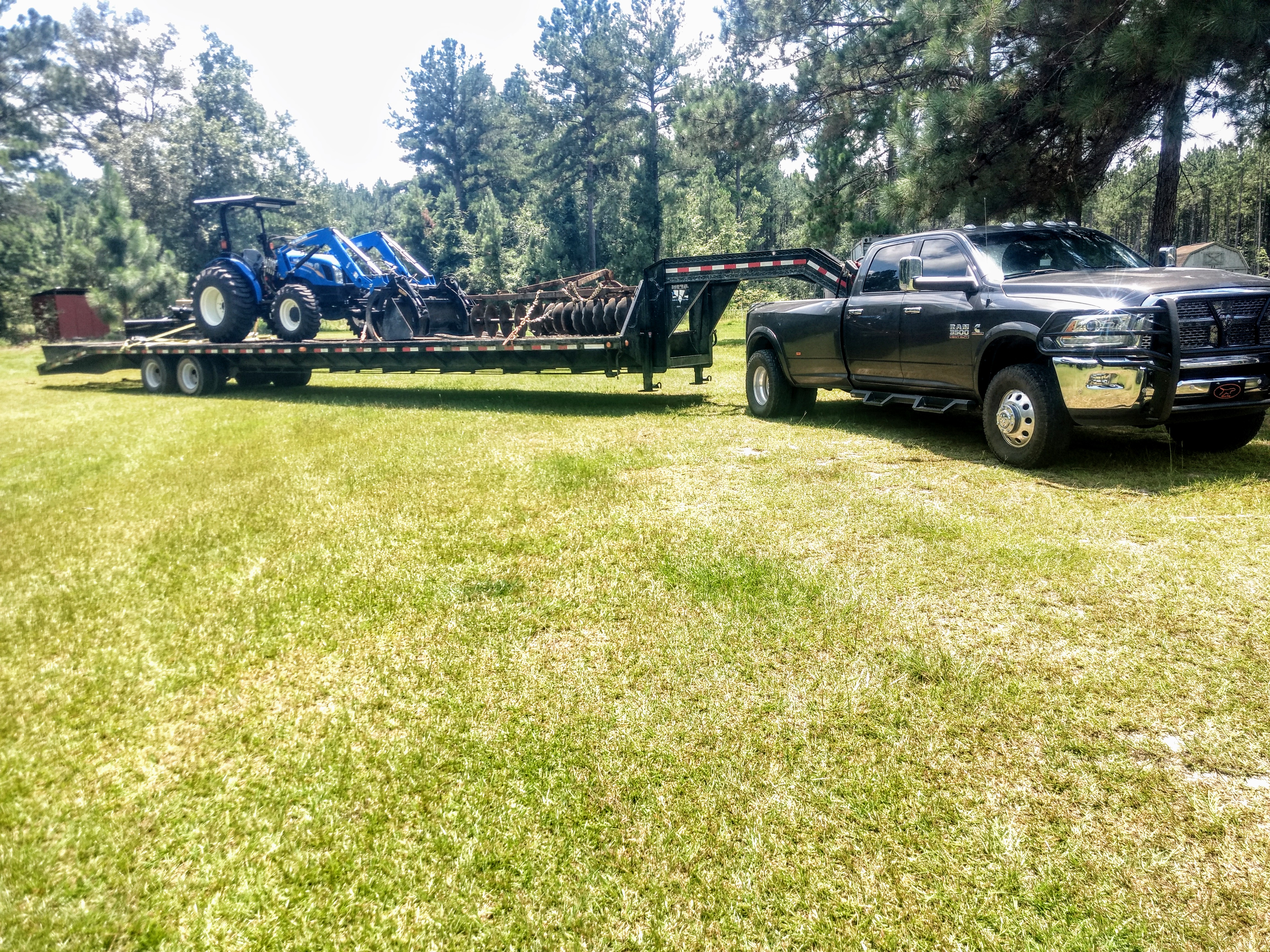

16' Ram 3500 Dre, Aisin transmission, 4.10 gears with a 35' + 5' dove tail, dual tandem trailer with triple ramps.

What does that 40’ trailer weigh? If it has 12k axles, would you feel comfortable putting 20k lbs on it?
I want a 40’ gn, but as the length goes up, the weight capacity goes down.

Taking a quick look at the Big Tex website their trailer with 12k axels at 35+5 long can’t haul 20k. Its payload is 17k and weighs 8900 pounds.

Thanks man, I hope to be driving the same rig 10-15 years from now. Figure buy once cry once. Lol
It's a PJ classic flat deck trailer and they don't list the weight with dove tail just straight deck. If I remember right they said about 8,500 lbs. So that's 16,500 lbs capacity left. The hitch is the limiting factor on mine at 25k lbs max rating.
But, I believe you can get an upgraded GN hitch rated for 30,000 lbs & twin 15k lbs axles which gives you a GVWR of 30k. That would leave you 21,500 of capacity on this specific trailer.
