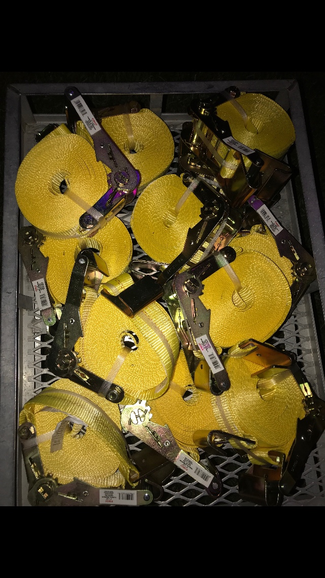

I found 2” straps for $9 each and stocked up. They were $7 when I was at the same place last year. I’m really thinking about putting some permanent mounted strap reels on my trailer like the semi flat beds have. The cost is about $30 each. IMG_4502.JPG

I found 2 straps for $9 each and stocked up. They were $7 when I was at the same place last year. I知 really thinking about putting some permanent mounted strap reels on my trailer like the semi flat beds have. The cost is about $30 each. View attachment 564471
Nice deal. Commercial use here requires the cert tags on them, and are usually not that cheap, unless they fell off a truck ;).
Rgds, D.

Tractor Supply and Runnings both run specials on them in the $7-10 range from time to time.
