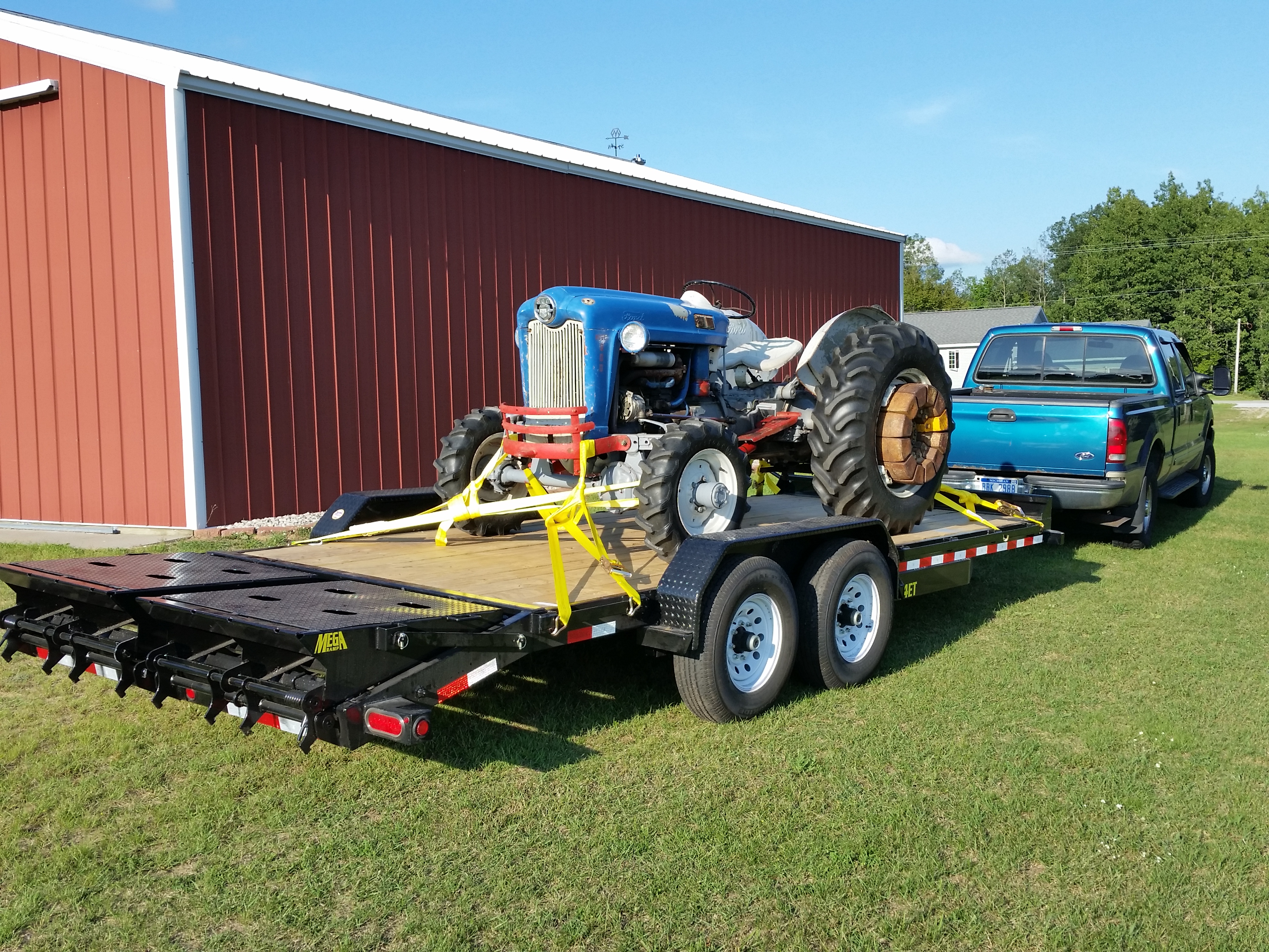

Got a 20 ft Big Tex 14k with mega ramps last spring to go behind a 2001 F250 with the 7.3 diesel. Much nicer hauling tractors now, and really like the mega ramps.
Is that 4wd Ford Tractor your hauling rare?
I don't recall seeing one before...
/ Your towing rigs and trailers #2,966
Yes, it is a four wheel drive. It is a Sherman Napco conversion from the late fifties and is kinda rare.
/ Your towing rigs and trailers #2,967
Cool tractor Michford!
/ Your towing rigs and trailers #2,968
I like it... and the trailer... looks like you can handle whatever comes your way with those ramps.
What is the unladen weight of the trailer?
Manufacturer web site says 2940#. That's likely without the mega ramps though, so add a bit for them.
