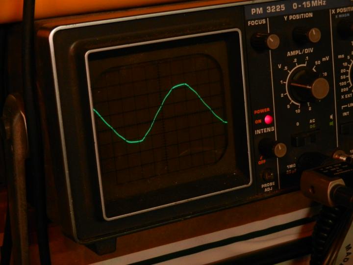

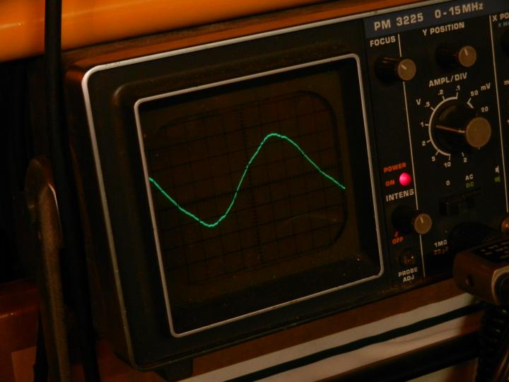

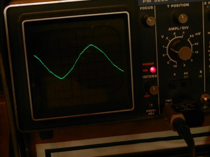

One last update on the Champion 7K dual fuel. After 5 more hours runtime (fast moving thunderstorms knocked out our power again...) I dumped the oil for a second change - no sparkles - no particulates, oil looks pretty much the same as when filled (maybe darker?).
Also, I cranked up the old Phillips scope & took a look at the waveform unloaded vs loaded (used a step down transformer between line voltage & scope)
First - mains power waveform:
Champion waveform, unloaded:
Champion waveform, 12A load on each leg:
Looks pretty good to me...

Looking good on those waveforms Nick.
In the right hands, a 'scope is a useful diagnostic tool, so I find that right at home in a Maintenance thread..... besides, even when I'm OP, I usually don't mind some drift.....
Sounds like you are all set for another 15+ years :thumbsup:
Edit: (Scope newbies - take note of Nick's comment about using a transformer).

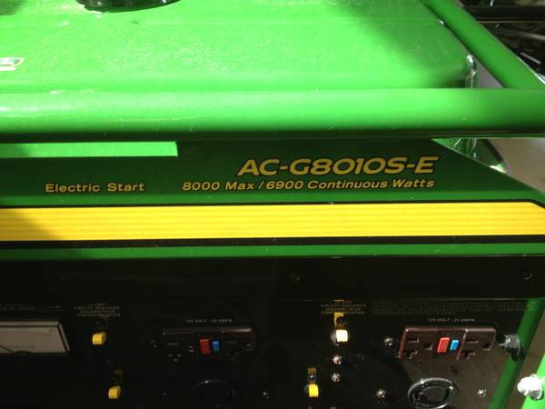

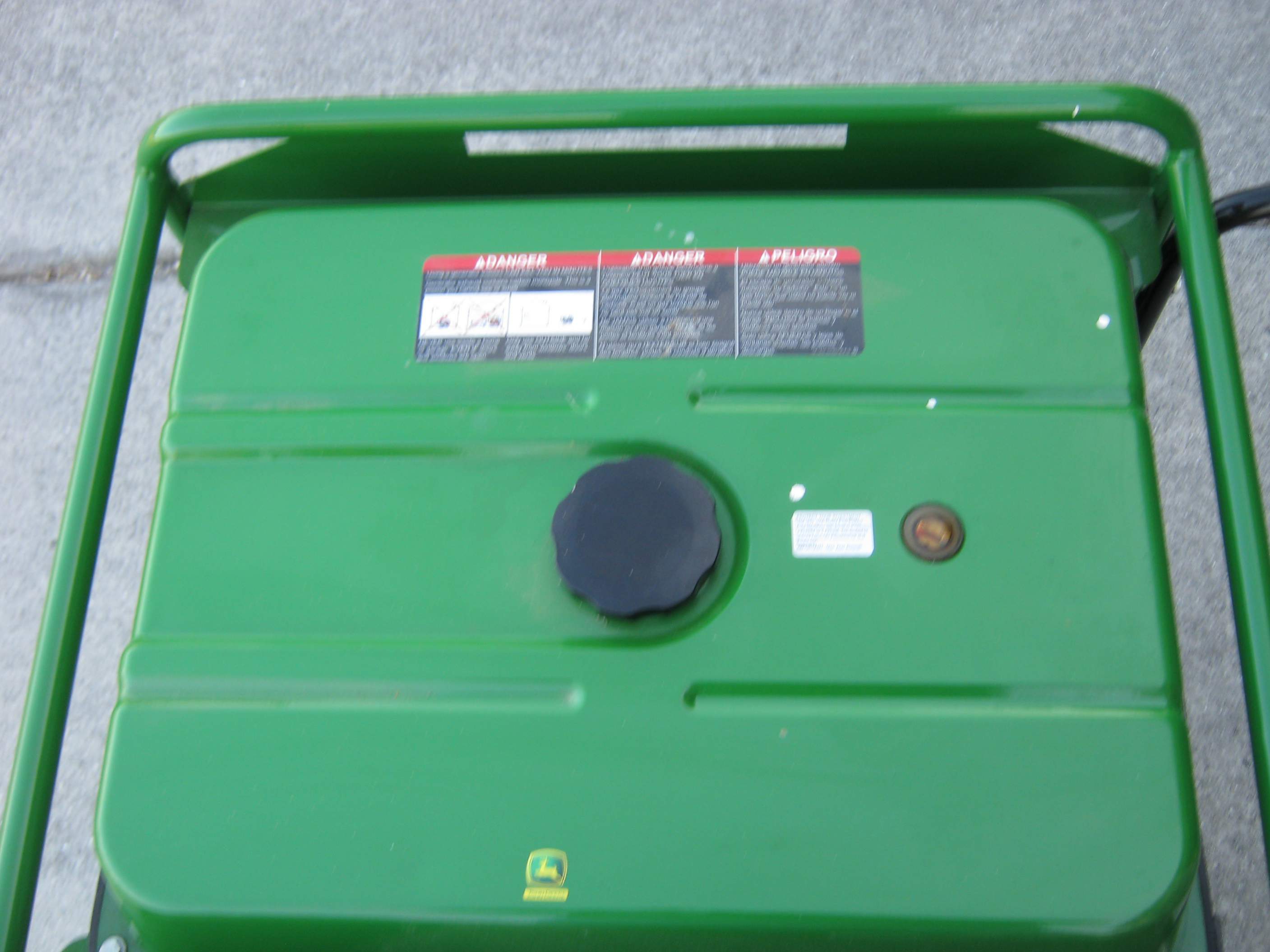

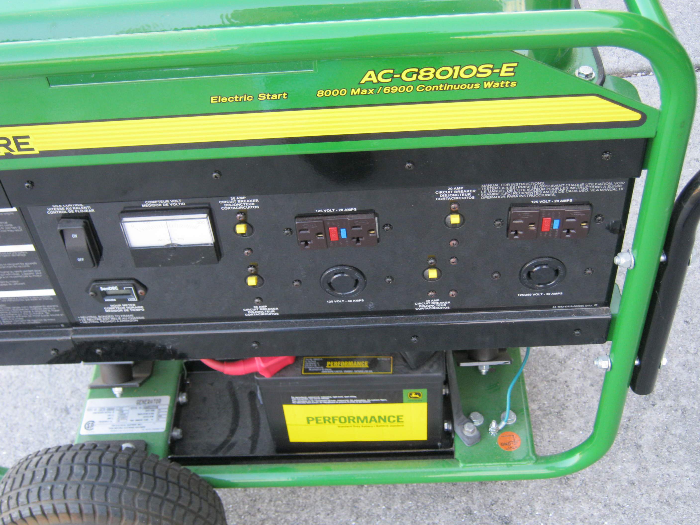

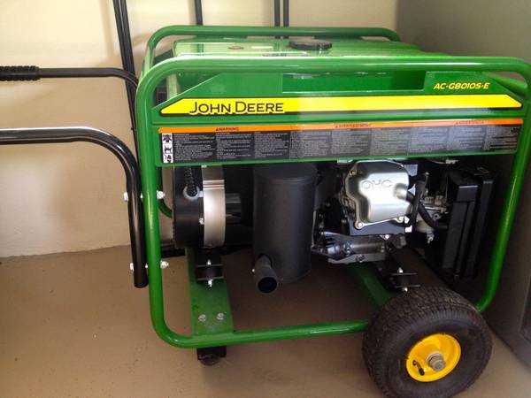

Cranked up my JD Subaru powered AC-G8010S-E genny . It has electric start but battery dead on it . Haven't replaced it , cause one ,two yanks on recoil cord and thing always fires rite up . Ran it for about an hour , ran a small amount of Sea Foam through it . Then closed fuel petcock and ran dry and drained fuel . I have less than 5 hours on this unit. https://www.deere.com/en_US/product...rcial/large_frame_8000/large_frame_8000.page?
The 404 cc Subaru motor appears to be a winner (so far). Like I have said before only negatives I see/hear are unit is kinda noisy IMO compaired to like a Honda motor and no oil filter on 404 cc Subaru.
Bought it cause I got a good deal on it , it came with wheel kit and handles . I have yet to run into someone that has one of these , but I know these units are out there . I really like it so far .
If anybody has had any hands on experience with the 404 CC Subaru , sure would like to hear your opinion/ETC on them .

You don't have a probe that can connect to 240V?
   / Your last generator Maintenance Run #467
If you put a large switching supply load on it, you should see that waveform start to get ugly.
