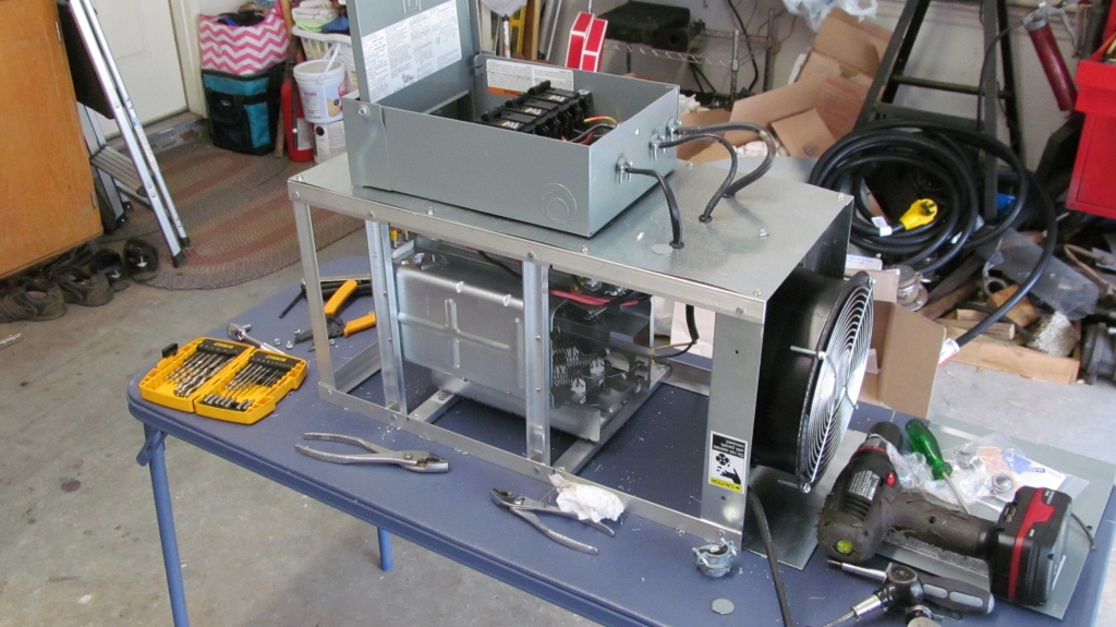

I am setting up a MEP803A Military Surplus generator. These units are designed to deliver 10KW at 80% and capable of running 24/7 in the desert.
I built a load bank using four 5400 watt dryer elements to run and test it with. I used a 100 amp outdoor panel with 6 spaces to set up three 240V circuits. Two circuits are 5400W and one is 2700W. Two of the elements are connected in series to cut the load in half. The fan is 120v and I plug it into the 120v convenience outlet on the generator. I will set a reminder in my phone calendar for regular testing intervals.

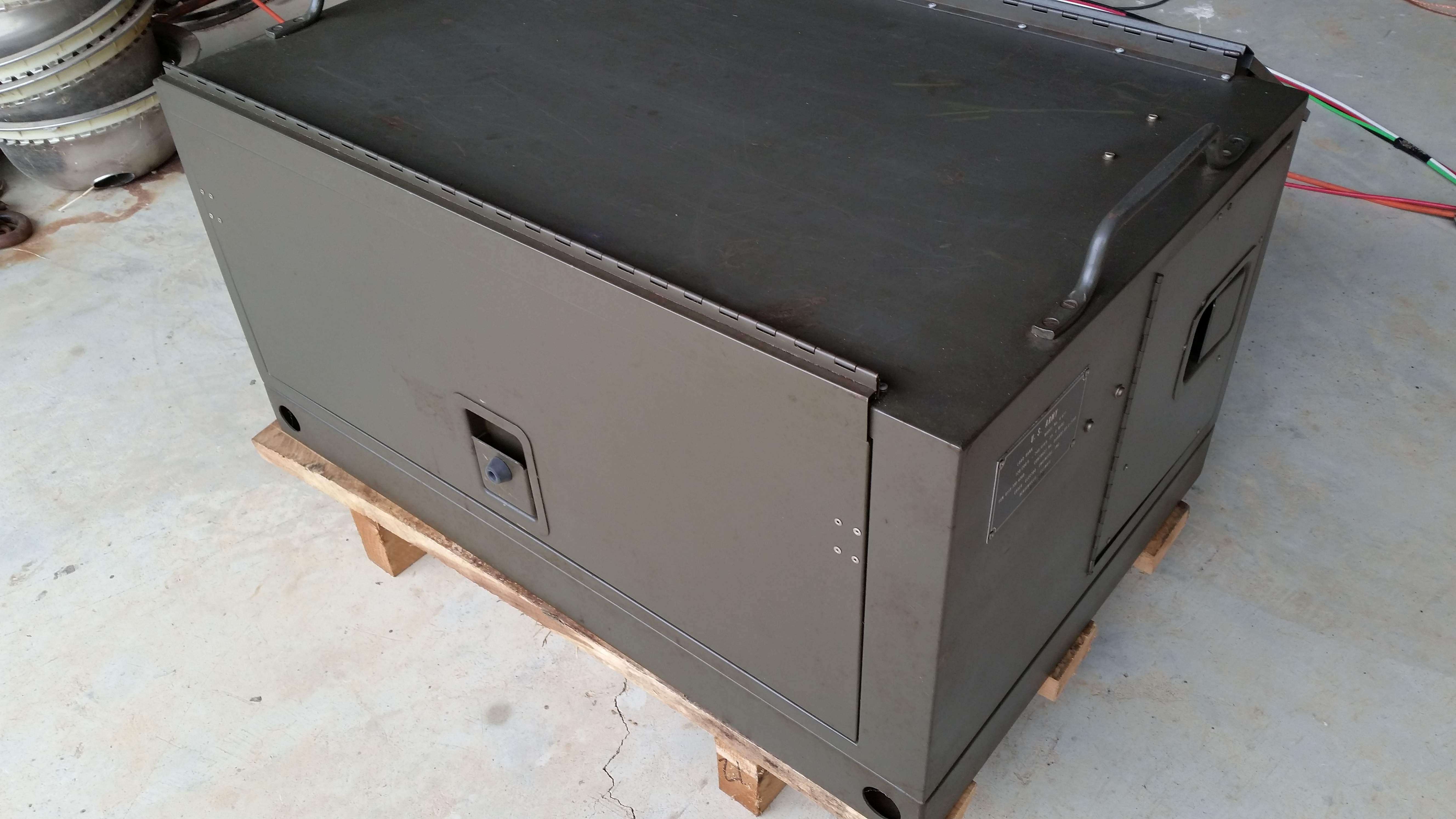

Here is a photo of the genset in it's final resting place with the load bank connected.

I still have a few refinements to make. I have some digital meters ordered to install in place of the flaky analog instruments it came with. The volt and hertz meters didn't read at all on this when I got it. I cleaned out the voltage meter and it works but isn't accurate so I didn't bother with the hertz meter. The percent load meter on the unit reads higher than the actual load so I'm not going to bother with any of them. All accounts are the original meters are junk and not to be trusted. I have a digital generator meter coming that will read the voltage and hertz and a couple more that read voltage and amps. I will use the volt/hertz meter to adjust output and droop. I plan to put one each of the volt/amp meters on L1 and L3 to monitor the loads and see how even they are.
Thanks for the test setup details, and the feedback on the milsurp gen. Nicely done.
