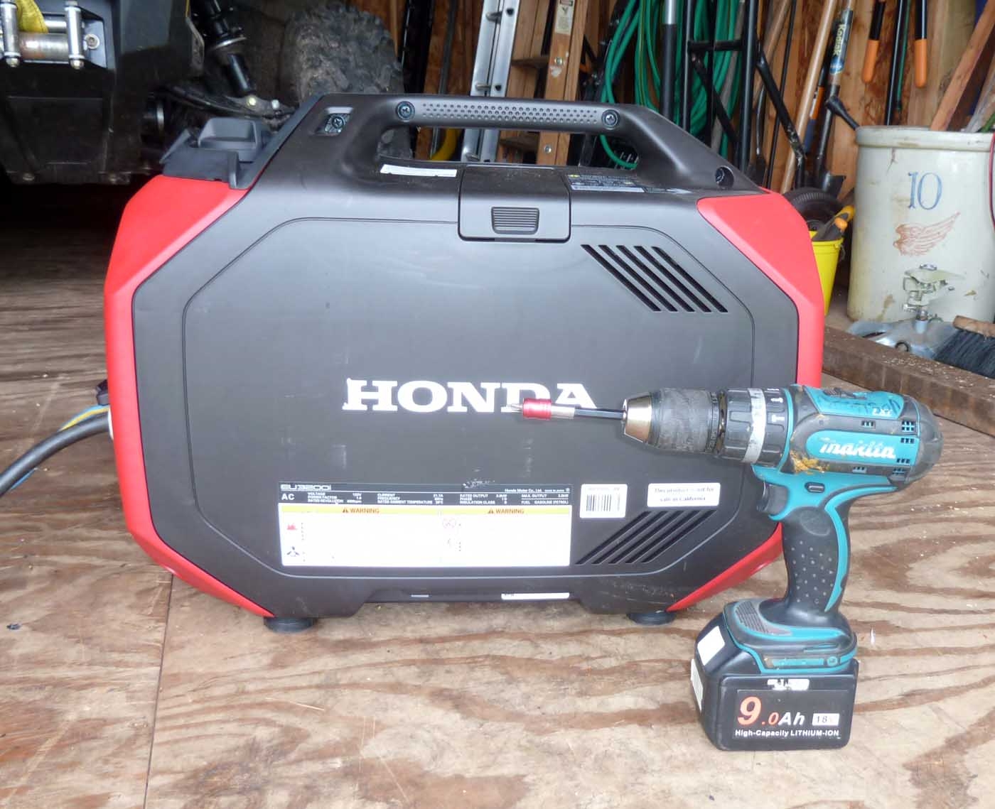

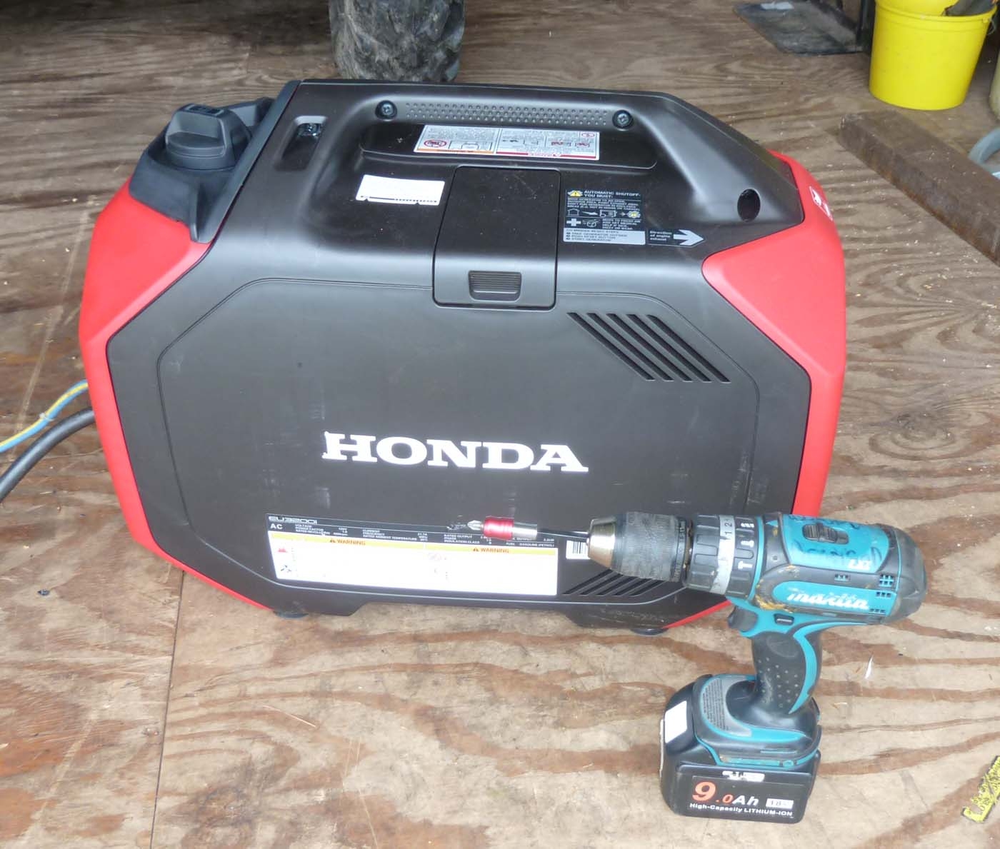

That's definitely a compact 3kw unit.
My Yamaha 3000 is 26.8" x 17.5" x 21.9" (LWH) and 152lbs
The Yamaha 2000 13.3" x 11.0" x 17.9" and 44lbs.
The 3000w Yamaha worked well for the RV, but we don't go out much at all anymore. It's really too big to be manhandling around.
   / Your last generator Maintenance Run #7,762
More pics, might give you idea of its size.View attachment 4068711View attachment 4068712

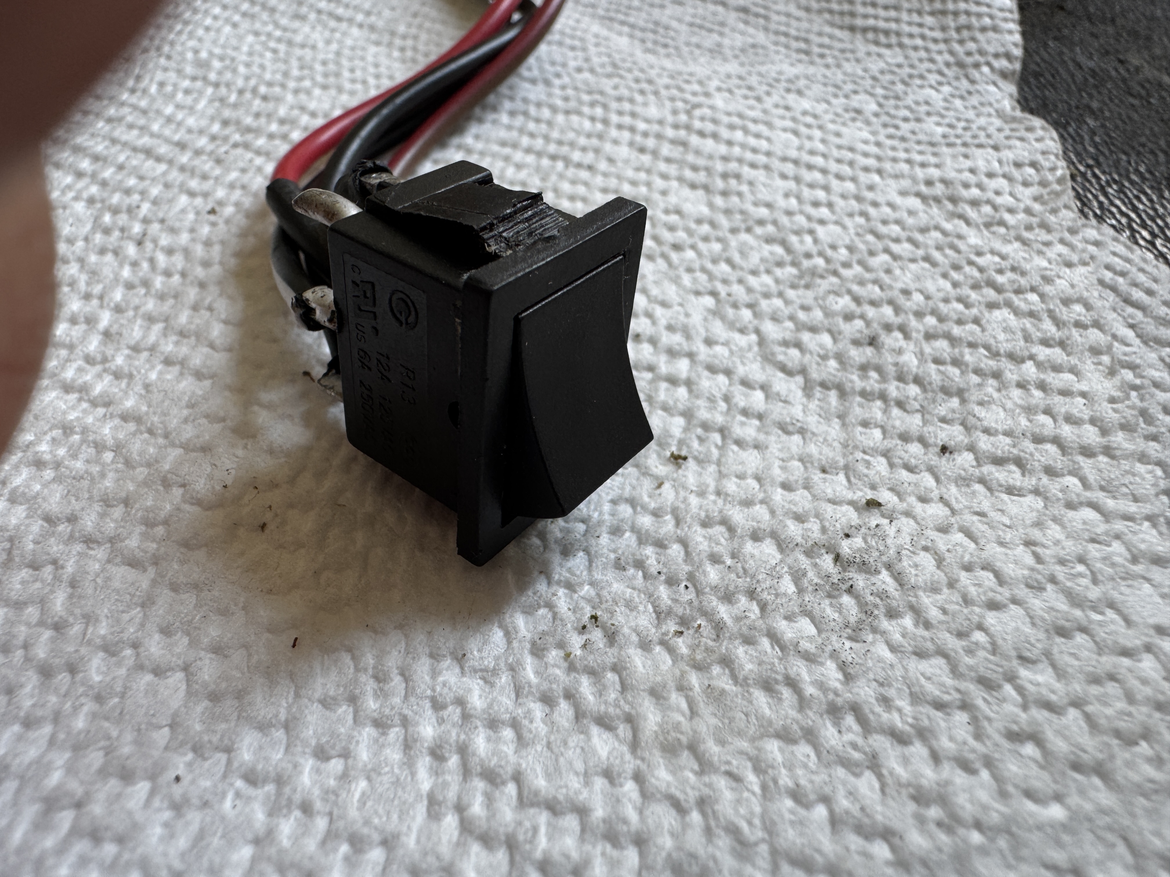

just as I clicked send, I see the gen repair guy walk by returning my Westinghouse gen.
As expected a bad switch, one well known online to fail due to inadequate waterproofing.
Replacement has a plastic front.
if you have this gen, suggest you order a new on/off rocker switch as if this one gets wet, it's likely to fail.
just like the big push button on this model, low bid hardware.
Thanks for posting that.
As you'd know..... good-quality Marine-grade switches are Spendy, so not surprising as a cut-corner....
If you are keeping the GE? you have for now, perhaps a tarp under the unit may help this Fall, if not in place already.... (outdoor-stored, with cover already, IIRC).

I have a good quality gen cover and unless it's blown off, unit stays dry. But on a damp cold morning, I'm sure
it's all rusting away in there.
repair guy confirmed the low oil wire went into this box, wasn't easy to get to, after the four panel screws there were three more, and
it wasn't that anyway.
in a bad storm, these gens are outside and unless in a cover like a generac, they are going to get wet.
no IP68 hardware for sure

one lesson here, I don't think Westinghouse is alone on using low bid hardware.
might pay every couple of years to take the panel off and if anything exposed maybe spray it
with something appropriate. I Deoxit the plugs and receptacles but thinking more of corrosion proofing
inside. Since this is a maintenance thread, should we be be tending to our hardware better?
I wipe protectant on mine and I thought took pretty good care of it, but now not one but two separate switches
on the panel have failed. I think the motor and generator are likely fine; this is switch failure.
if you are a prepper, maybe check out spare switches for your gen...?
I like spares but you have to draw a line somewhere. But if you have a 6-10kw Westinghouse portable, or its clone,
which is a clone of another clone...you might see if your rocker power switch looks like the one above.
of course if it would simply fit in the hole,which the first one I ordered swore would, and didn't, the repair guy's switch he got from
the factory did fit. And was sealed with plastic. Amazon screws up again. Box is even labeled for right gen but wrong part in it.
worth buying from factory to avoid aggravation of doing it all twice
sure that part fits
only ten minutes with a Dremel sir
what's the big deal?
