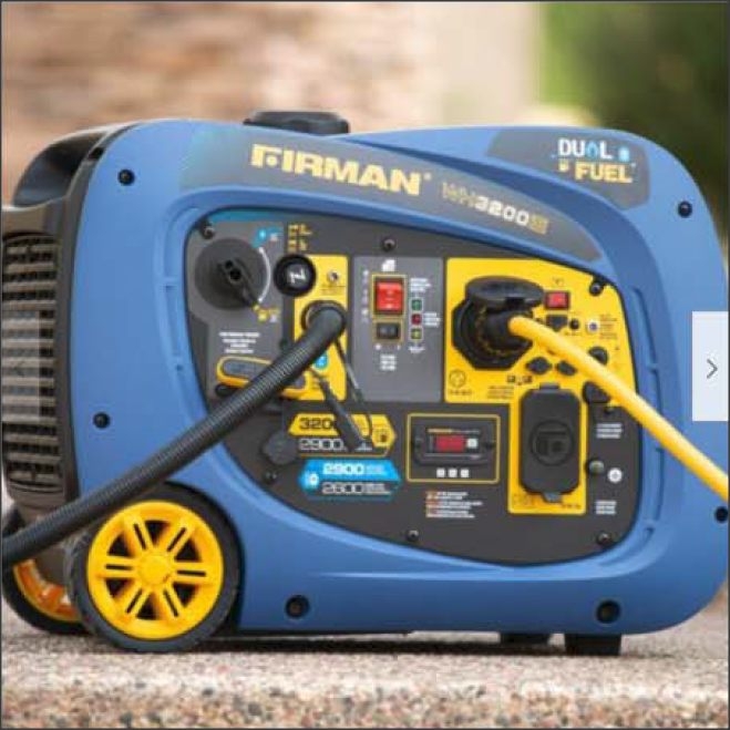

Warming up the genset for an oil change as I write this. We've been running every day for over three weeks now. This year the rain season has started a bit early and with more than average precip.
To the subject, I don't even bother keeping track of hours. I just make a rough note of the aftermarket hour meter reading and when the oil (Mobile1) gets darker than opaque it gets changed. It's certainly more often than needed, esp for full synthetic, but it's only a bit over a quart. So what?
Not sure if that method would work well with propane or natural gas powered generator?
The oil is staying pretty clean in my little dual fuel generator so it gets changed based on hours used, or once a year.
I keep few 100 lb and 30 lb propane bottles in the barn and have no intention to put gasoline in it, if I can avoid it...
