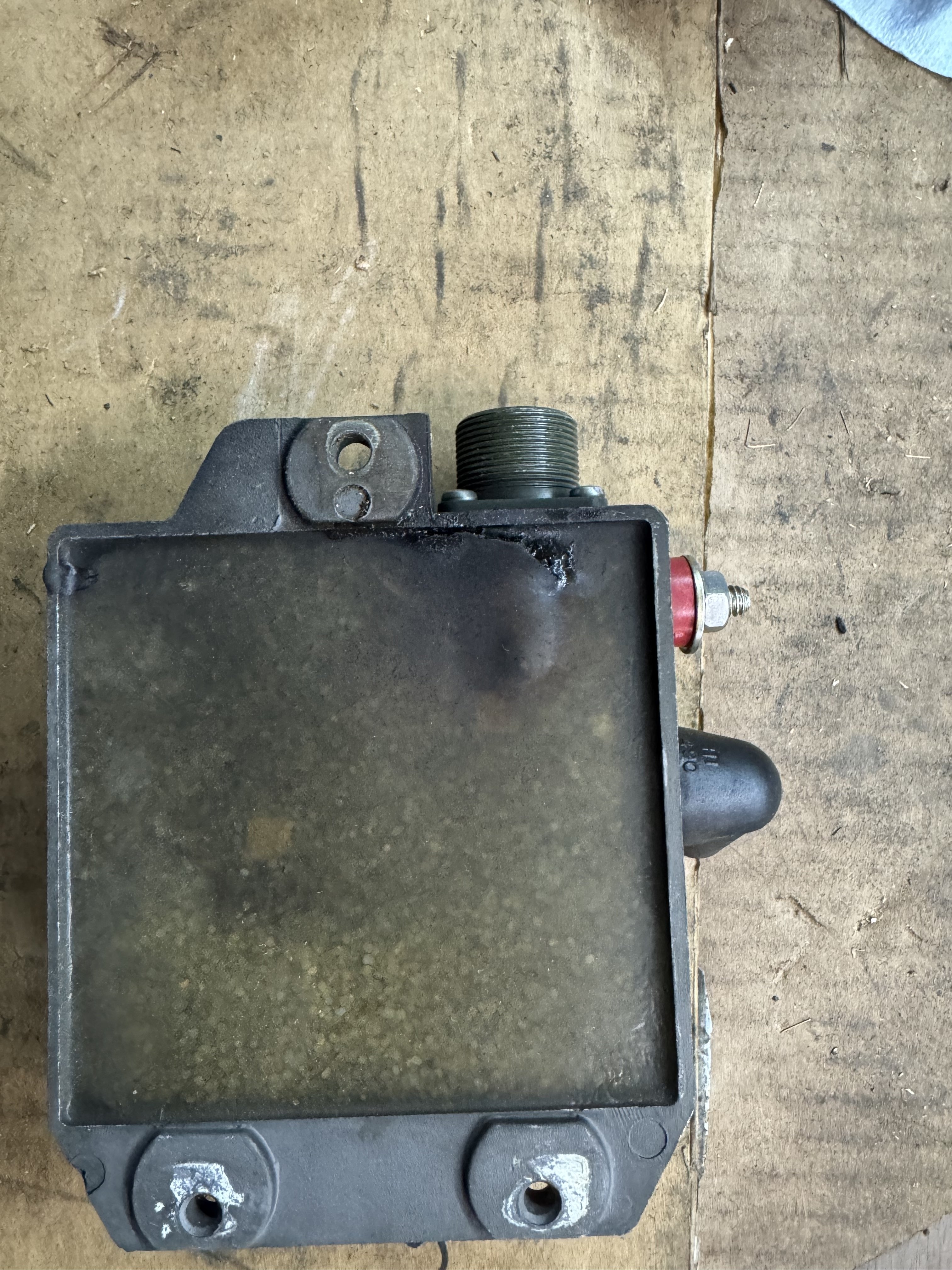

I removed the regulator from the alternator today & confirmed it’s failed.

You might even have a spare in stock ! Looks like some overheating (?) near connector.....

Nothing is stock for this gen.
I’m leaning towards removing this unit and installing my 4kw ac generator with the L70 Yanmar.
That engine is a special military version with extended 2qt sump, intake air heaters and bypass filter system.
This generator will work nicely with my auto start controller.
I can then work on a solution for the defective regulator.
This is the season for inside work.

Found one supplier claiming to have the regulator CE Niehoff Voltage Regulator 28 Volts DC Fits Cat 1 & Cat 2 MRAP
   / Your last generator Maintenance Run #7,812
Nice find Thank you!!
I have the repair manual for this unit & it may have an electrical schematic I could use to integrate an aftermarket regulator.
But that’s down the road a bit.
90cummins
