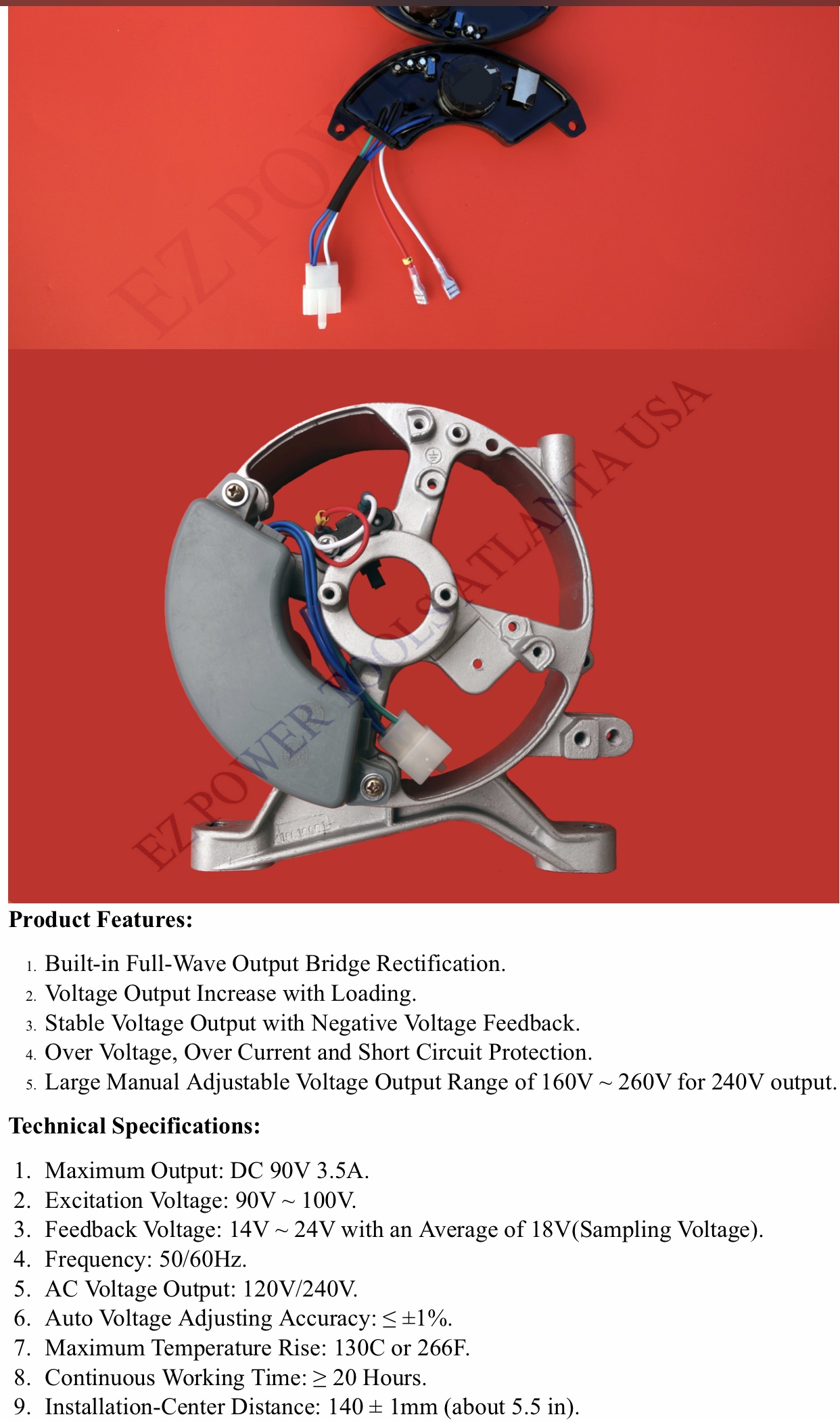

There are many generic voltage regulators for generators. As long as you know the voltage range of your rotor. Most VRs have a pretty broad range and will put that voltage to the Rotor that will create 120 or whatever you set it for on the output.
I was hoping for an AVR that is powered from the separate excitation windings and only references the output terminal voltage .
The typical generic AVR both uses power from the main output terminals to excite the rotor and take the reference voltage from the output terminals .
On a small 5500W machine . That is giving up a lot of the generator’s capacity for excitation that will not available to carry electrical loads .

Here is a description of how the typical six wire AVR specs . It senses a range of 14-24VAC and typical operation of 18VAC to the sensing leads will make the AVR regulate the rotor excitation to obtain 120VAC from the stator windings.

Thinking about how to approach the VR issue with seperate winding.
EDIT: Flight Systems (A great company) sells a model 480 with seperate sensing input. Not crazy prices but not chinese pricing either.
