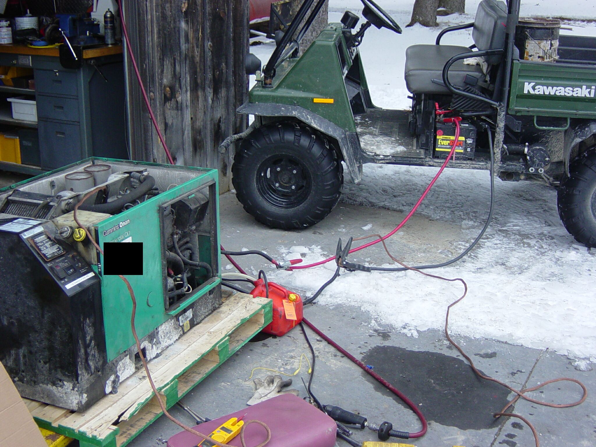

I lay in bed last night and realized I was totally confused. The DELAY in my ASCO switch is NOT a dwell. The switch is designed to only have two positions, no inbetween (OFF). You could throw the main switch and turn it on manually after a brief off period, but that kind of defeats the purpose of the ATS.
Chilliwack, you were absolutely correct. the battery (I was told was "Good") was in fact defective on the Onan 7.5 Quiet Diesel. Found that glow plugs work and starter gets power but no cranky. Will mess with starter a bit. Keeping fingers crossed that maybe when unit fires up, there won't be an inverter issue.

Thanks
My little horror show
I know better than to celebrate prematurely, but I do kind of have a smile on my face.
Took starter out and bench tested it. Worked fine!
Reinstalled, no-go.
Found I had a bad ground (somewhere) which would explain those very high charging voltages before. Jumpered a ground onto the motor frame.
Finally got it primed, started, smoked like crazy and worked itself out. Makes power:thumbsup:. Although I have to figure out the numerous wires for a 110 output?
Curious where the ground may be bad.
I would like to put the output into a transformer, but I see the one I have handy is only good for 3750 VA and is 50HZ. Wonder how lossy that would be?
The machine is kind of dirty and I'm thinking I would probably be foolish to try and pressure wash it. What a crying shame that they use that garbage powder coat on these! A little wire brushing and some enamel would have done the trick Now what?
What an incredibly quiet little machine!
