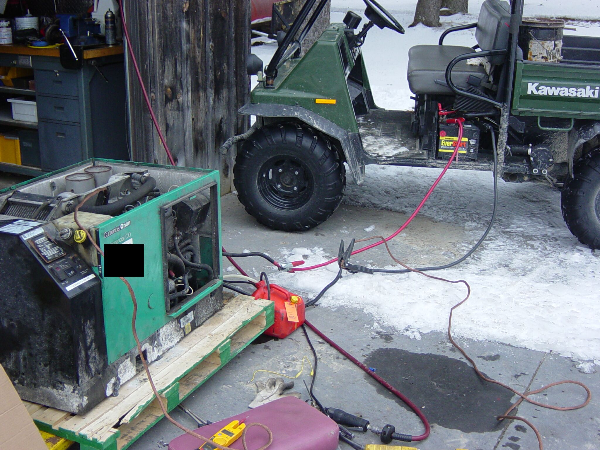

I lay in bed last night and realized I was totally confused. The DELAY in my ASCO switch is NOT a dwell. The switch is designed to only have two positions, no inbetween (OFF). You could throw the main switch and turn it on manually after a brief off period, but that kind of defeats the purpose of the ATS.
Chilliwack, you were absolutely correct. the battery (I was told was "Good") was in fact defective on the Onan 7.5 Quiet Diesel. Found that glow plugs work and starter gets power but no cranky. Will mess with starter a bit. Keeping fingers crossed that maybe when unit fires up, there won't be an inverter issue.

I'm figuring out how best to deploy this thing.
First get 10KW transformer to make 110/220. Then mount the generator on a frame and house a battery, the transformer and fuel tank underneith. That makes it top heavy. How to get it somewhere, where it's needed? It does have a lifting eye, which is kind of cool. Trailer mounting it, makes it bigger than it needs to be, plus tires rotting and needing air. Plus it makes it more stealable. I can load it on my 3/4 ton truck, but how to get it off (and back on again) let's say at my lady friends.
