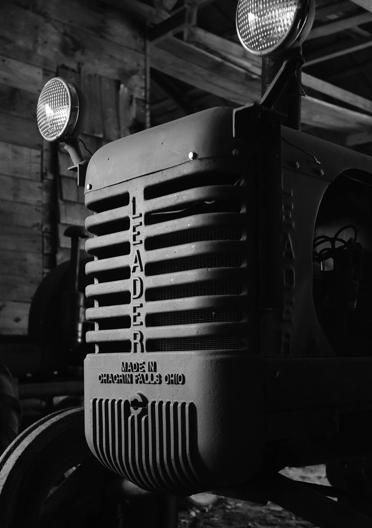

I can offer no info on the rebuilding. I met a collector who owns a Leader tractor. He said it was built in the 40's and is quite rare. What struck me was that the grill was SOLID cast iron. It was an interesting looking machine. Here is a picture.

That's a neat picture EasyGo. I see the tractor was made in Chagrin Falls, Ohio; the same town Tim Conway's 'Ensign Charles Parker' in 'McHale's Navy' was from.
Thank you mjncad.
