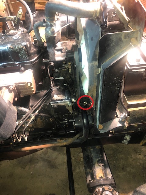

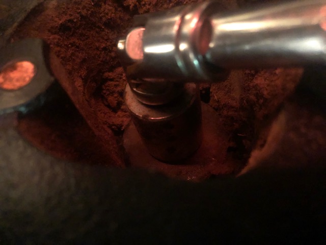

After working to gain access so I can turn over the engine, I can't help but thinking I'm doing something wrong. From what you all have posted, this shouldn't be as hard as I'm making it out to be, but I can barely get a socket on this nut and when I do, I can't move my strong arm at all.
From the pictures, can you tell if I'm in the right place? The red circle is where I can access the nut. The nut is way back and surrounded by everything.
Of course, it doesn't help that it looked like it would be a 17mm and I was too stupid to buy the whole set of deep wells since that would cost me $35 instead of $5 for just the 17mm.... when it turns out to be 19mm....I should have bought the set and saved the gas money and time. :confused3:

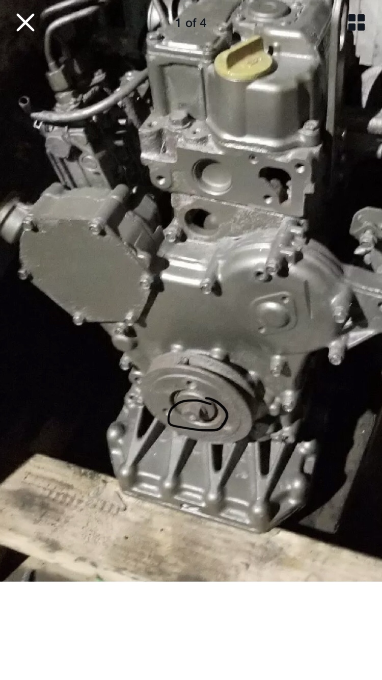

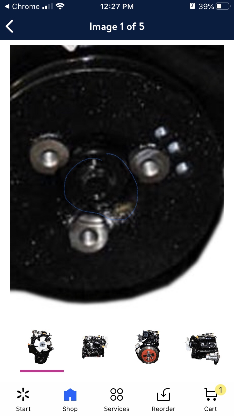

I can not see much from your photos on my phone, but I suspect you are not on the right spot. Your crank bolt that you need to turn the motor over with will be in the center of the lowest pulley on the front of the engine.
Deep well and extension have been recommended because it is a dish type of recessed bolt. Follow your belt(s) down till they start to go back upward then look for a bolt head recessed inside that pulley.
Not a terribly good photo but the very center is where you want to be.

Hi Munere, Not sure what that bolt is in the picture but to rotate the crank and therefore everything else the bolt will be as CoyPatton has shown in the center of the bottom pulley. Not that I'm trying to make a big tough job harder it doesn't look to me like there is sufficient space to do it without taking the rad out of the way, perhaps there is but just be careful of the rad and your knuckles!

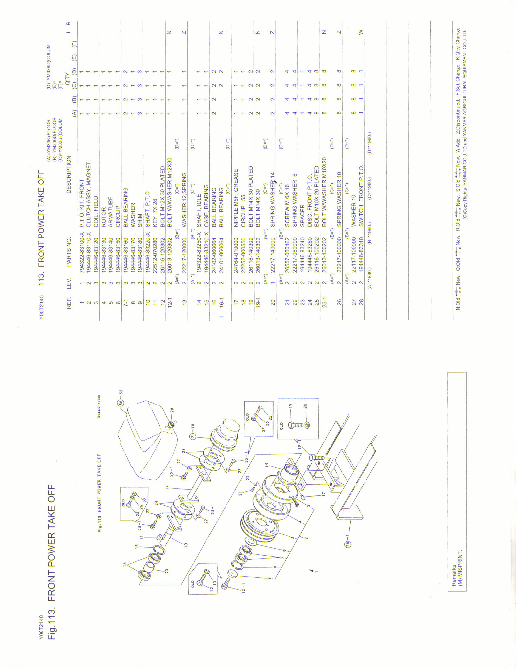

Not that it makes any difference setting the valves but after viewing one of your pictures I have to wonder if you possibly have a front auxiliary pto?
/ YM336D bad knocking engine
#49
Yes, I took the nut off, unnecessarily, so I could check that the rod was straight. Boy, I wish I hadn't done that now.
Winston, I do not have a front PTO, but shortly after I moved away to college in '86, my father had hydraulics added to the tractor and a Great Bend FEL. I guess we didn't need a FEL as long as I was doing the shoveling/lifting. :laughing:
