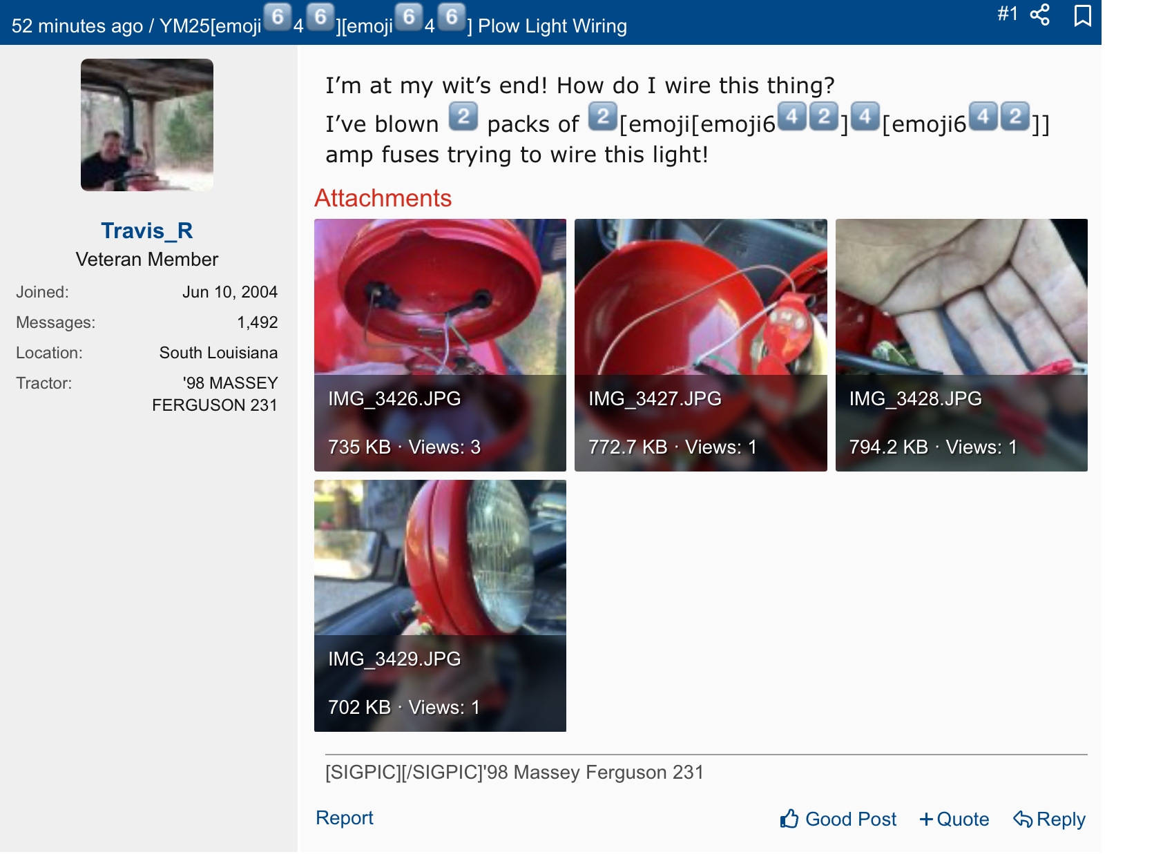

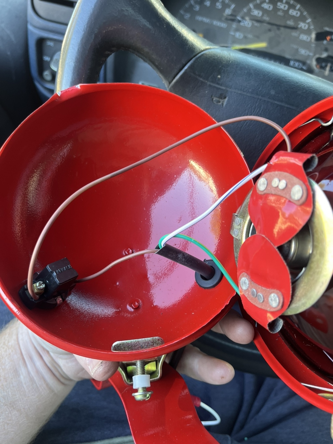

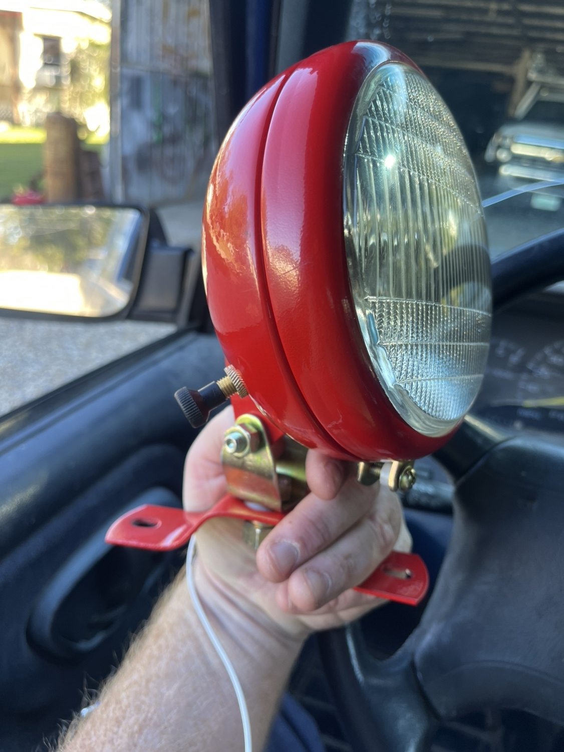

I’m at my wit’s end! How do I wire this thing?
I’ve blown packs of [emoji[emoji6][emoji6]] amp fuses trying to wire this light!

/ YM2500 Plow Light Wiring #3
With the 3 wires I'm thinking that it has a low beam and high beam. I'm wondering if they are switching the ground wire (brown) to turn it on and off. The green or white wire will be powered depending how much light you want. Powering both may draw too much amps. Any instructions with it?

Zero instructions with it.
With brown to ground and white or green to hot, the light is staying on, regardless if the switch on the light is on or off.

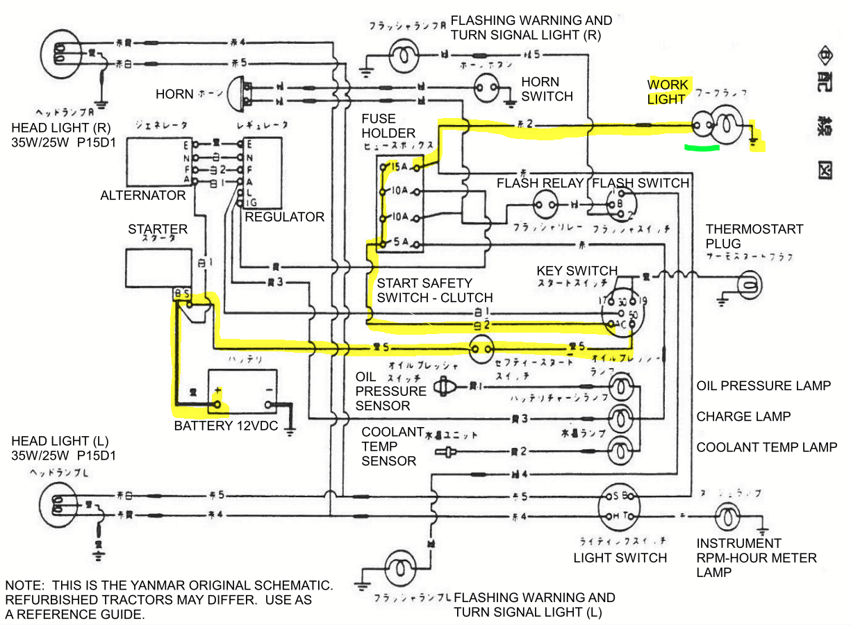

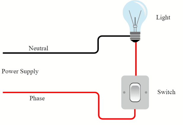

I thought Steve shared my link on how to wire this already?
The one wire is HOT and goes to a switch, then the fuse box to the + on the battery.
The ground just gets grounded to the fender or run it down to the chassis.
This is the schematic for your YM2500. The green marking is an on/off switch.

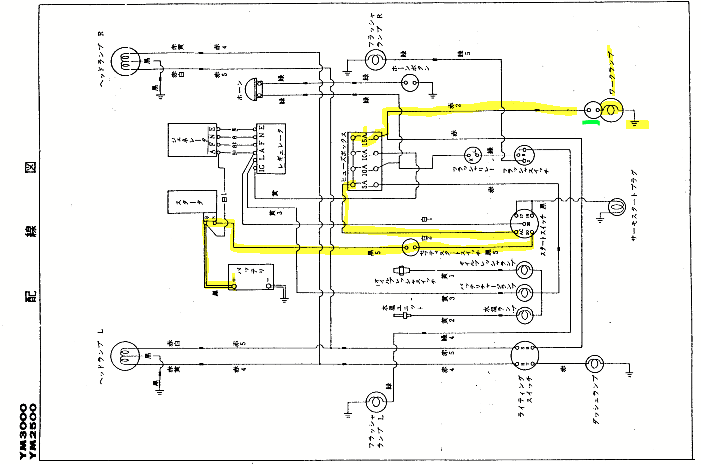

/ YM2500 Plow Light Wiring #8
And the YM2610 basically has the same schematic. I had translated it into English.

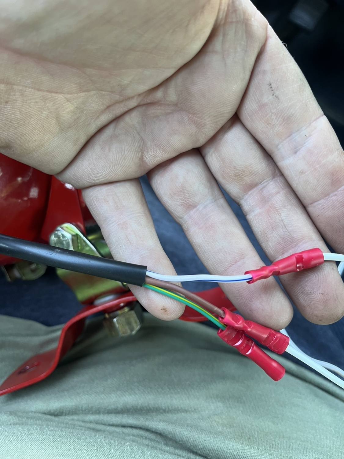

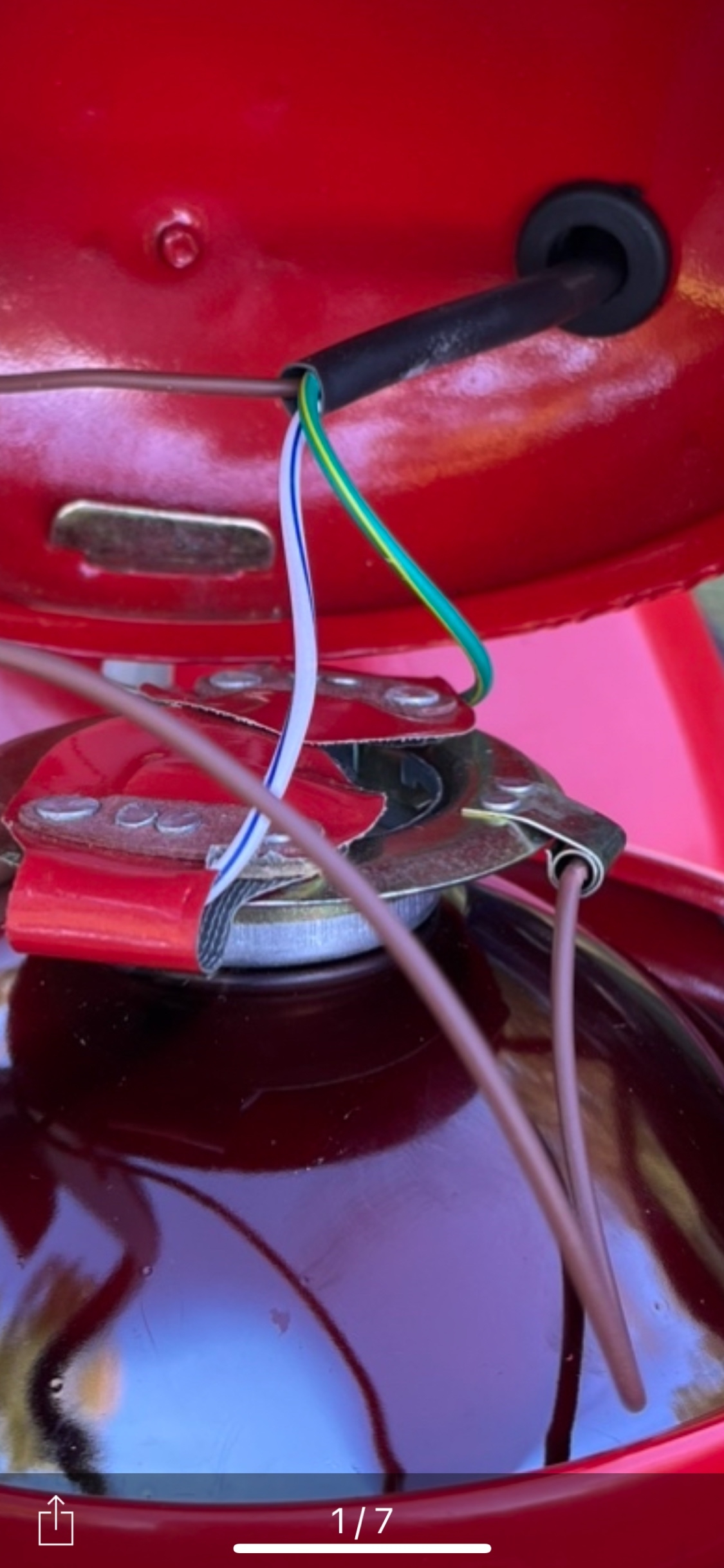

Coming off the plow light, there’s a White wire, a Green wire, and a Brown wire.
The Brown wire is a ground.
The White wire is high beam.
The Green wire is low beam.

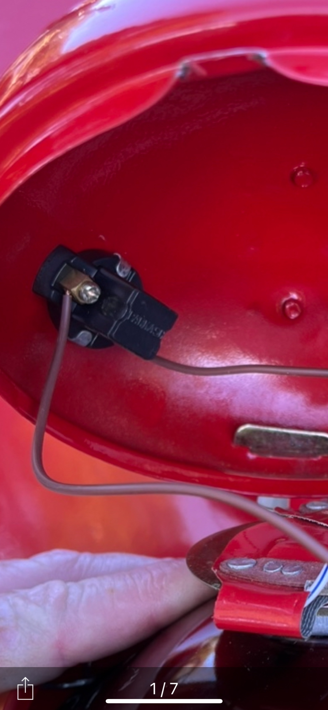

With the light mounted to the fender, the Brown wire grounded, and the White wire running to a 12v wire on the tractor (with the key on), the light is staying on, regardless if the switch on the light is on or off.

Cap off the green wire. Only use HIGH.
Is the switch in the shell wired to the light wires to the bulb?

The Brown wire (ground) is going to the on/off switch on the plow light.

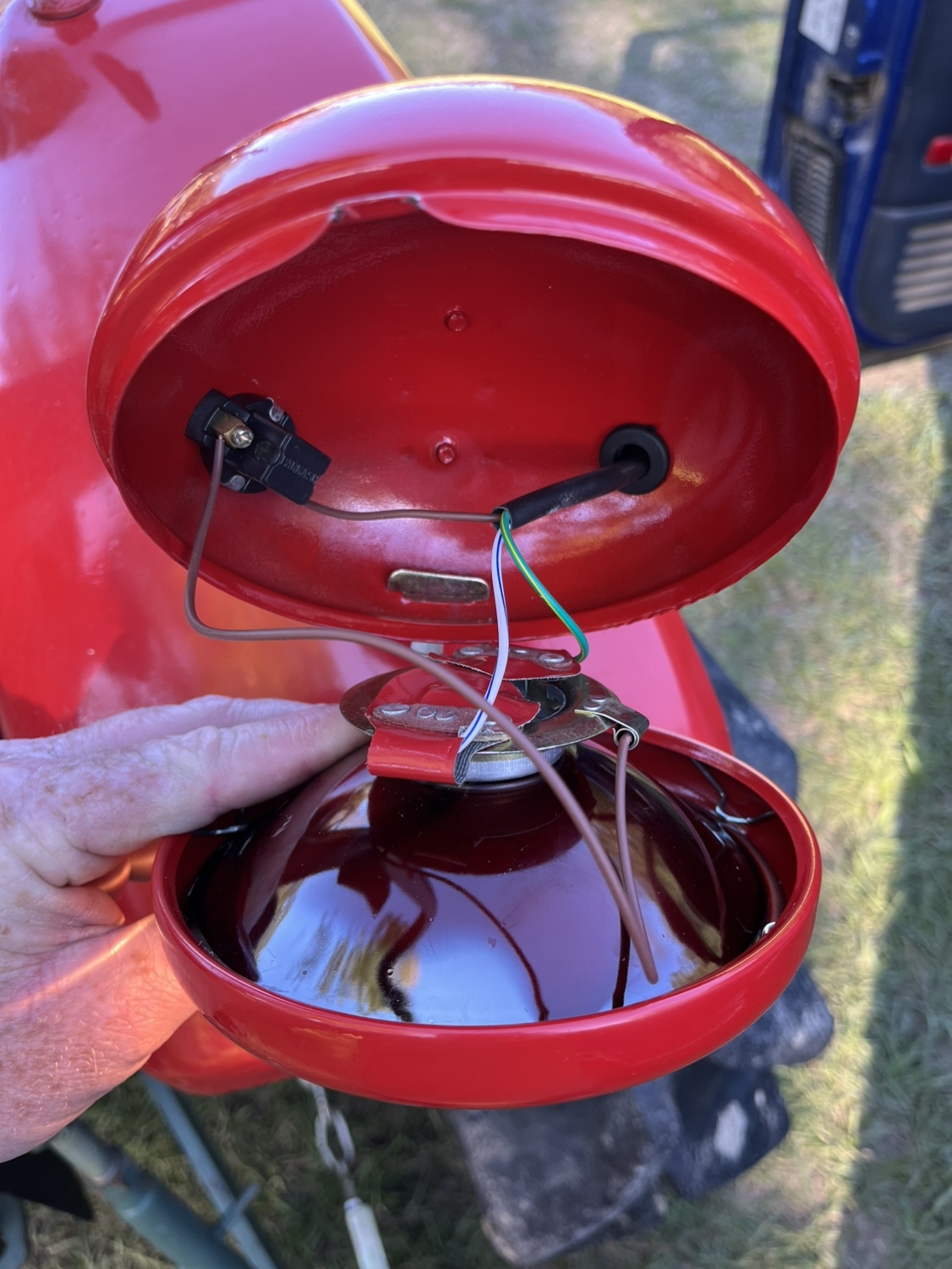

#16
Post the make and model of that light.
Right now we must guess. The red backing on the sealed beam on my Massey Ferguson 135 has a purpose. There is also a small clear bulb behind the sealed beam. When it's on it shines through the red lens for road driving.
The switch should be on-off-on/ 3-way switch to turn on either the red lens, off, or clear work light.
The ground is just that, ground, not switched, and is green.
I wonder if it could be a defective plow light or bad wiring on the tractor? The switch on the light is either on or off, it’s not a 3-way switch.
I hooked it directly to a 12v battery and it worked fine.
This picture isn’t showing the wires that my light has.
/ YM2500 Plow Light Wiring #17
see the simple wire diagram above. Just cap off the LOW beam wire.
