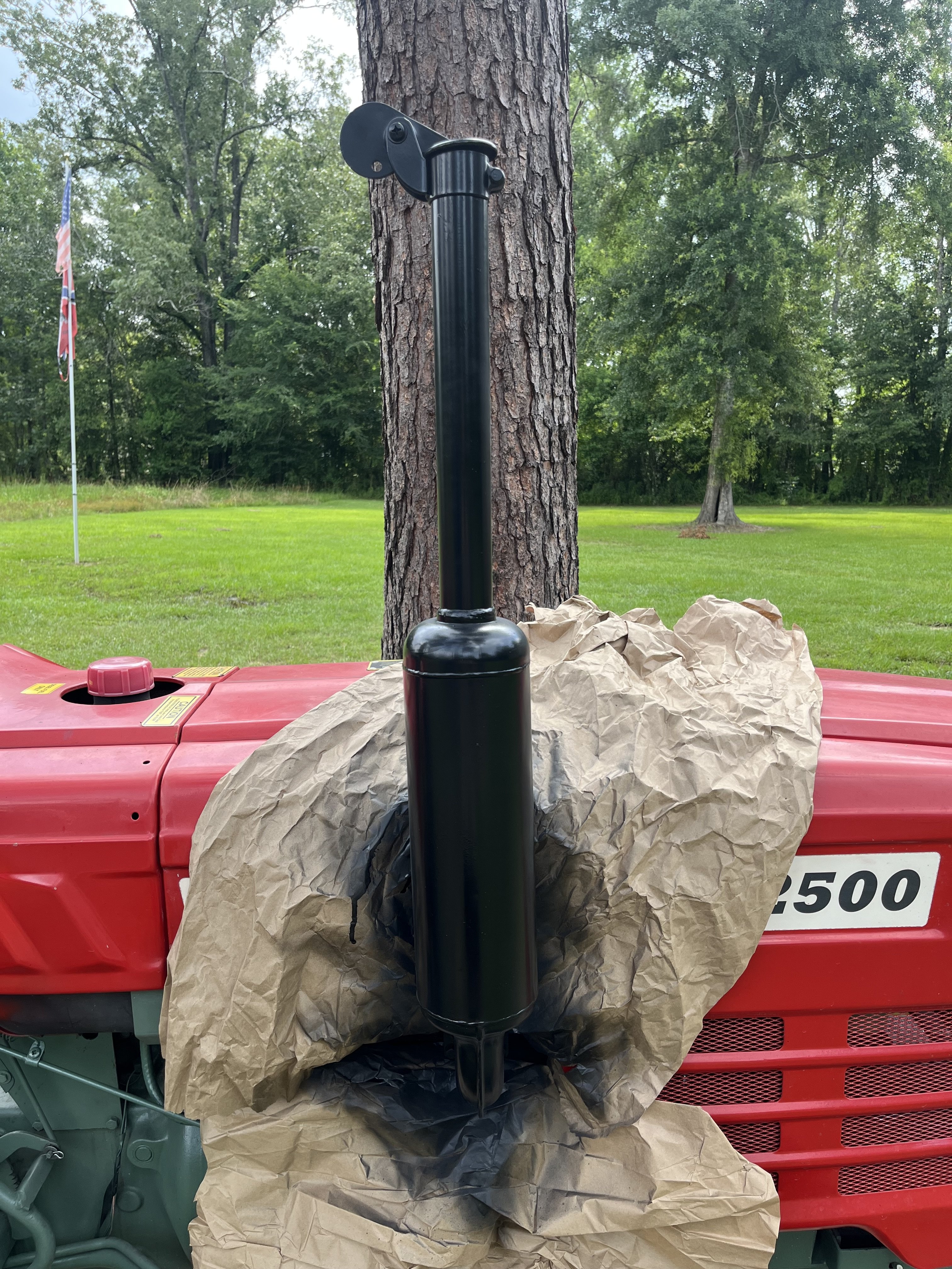

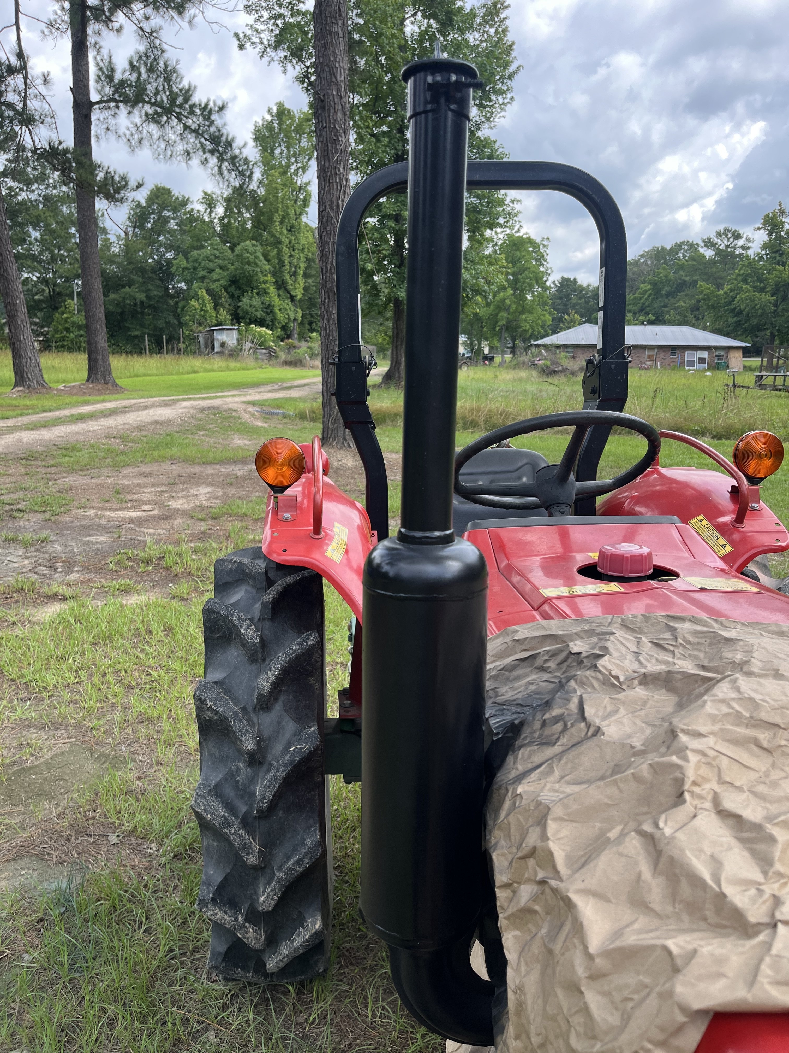

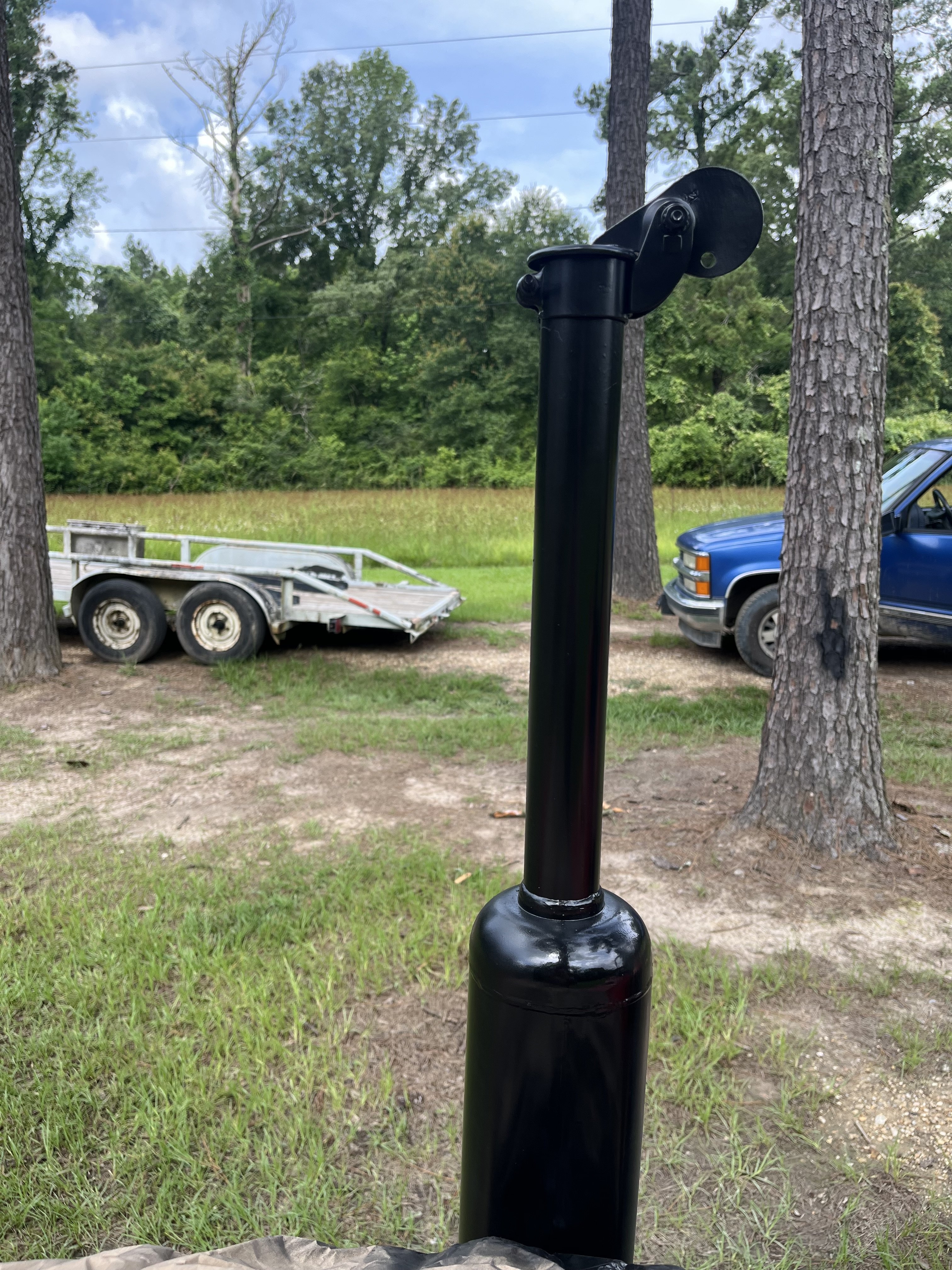

Well, I just couldn’t resist.
Very glad I made the decision to paint the muffler a more glossy black!

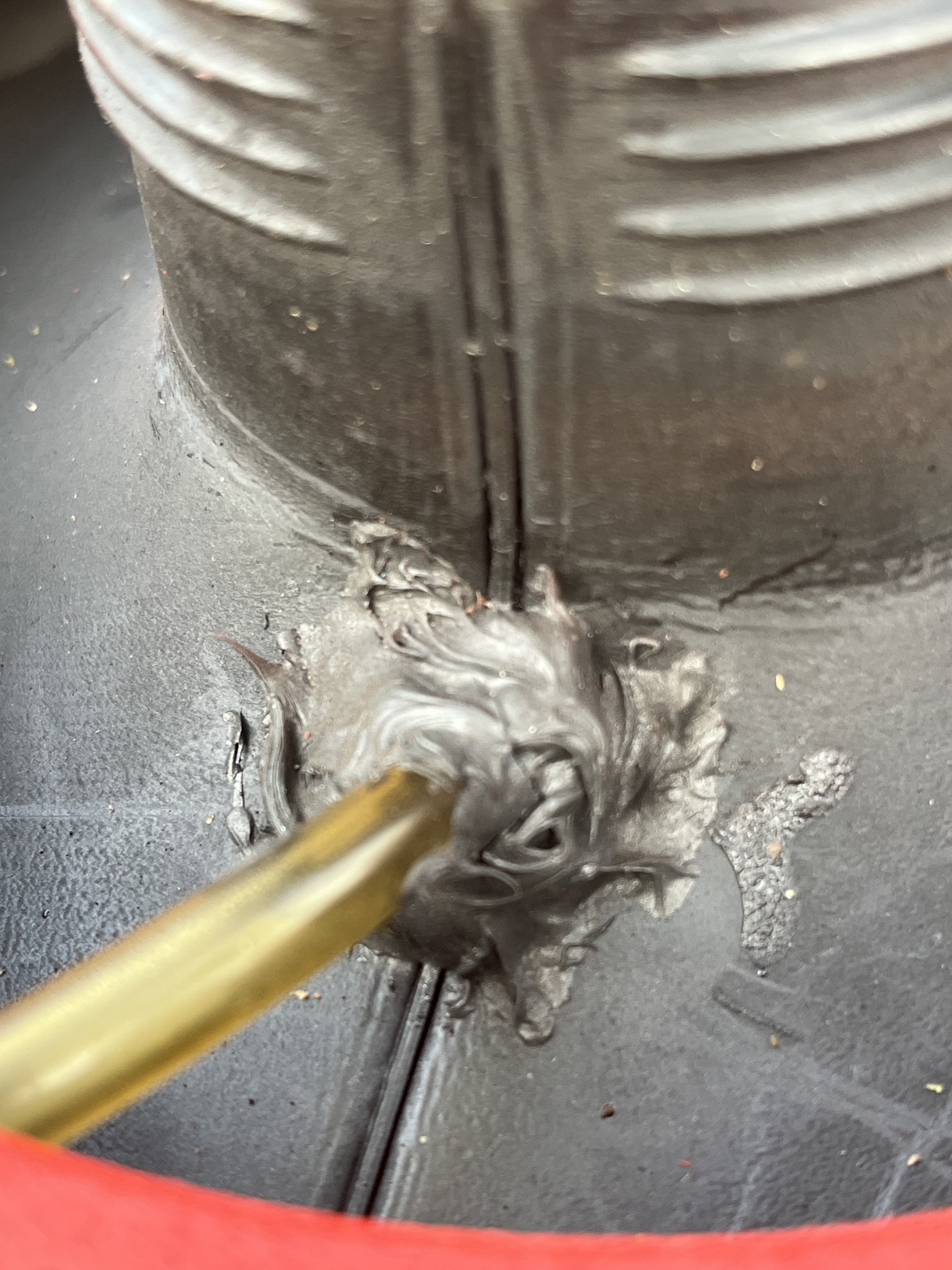

#73
I tried to stop a leak with RTV Silicone on the side of the fuel tank, but was unsuccessful.
I emailed Danny at Fredricks and he is sending me a new fuel tank and a new fuel cap with gauge.

I used a piece of vacume hose the smaller return line fit into. I was able to keep the Org. tank. I had to do something. Major leak Esp. close to or a full tank of fuel.

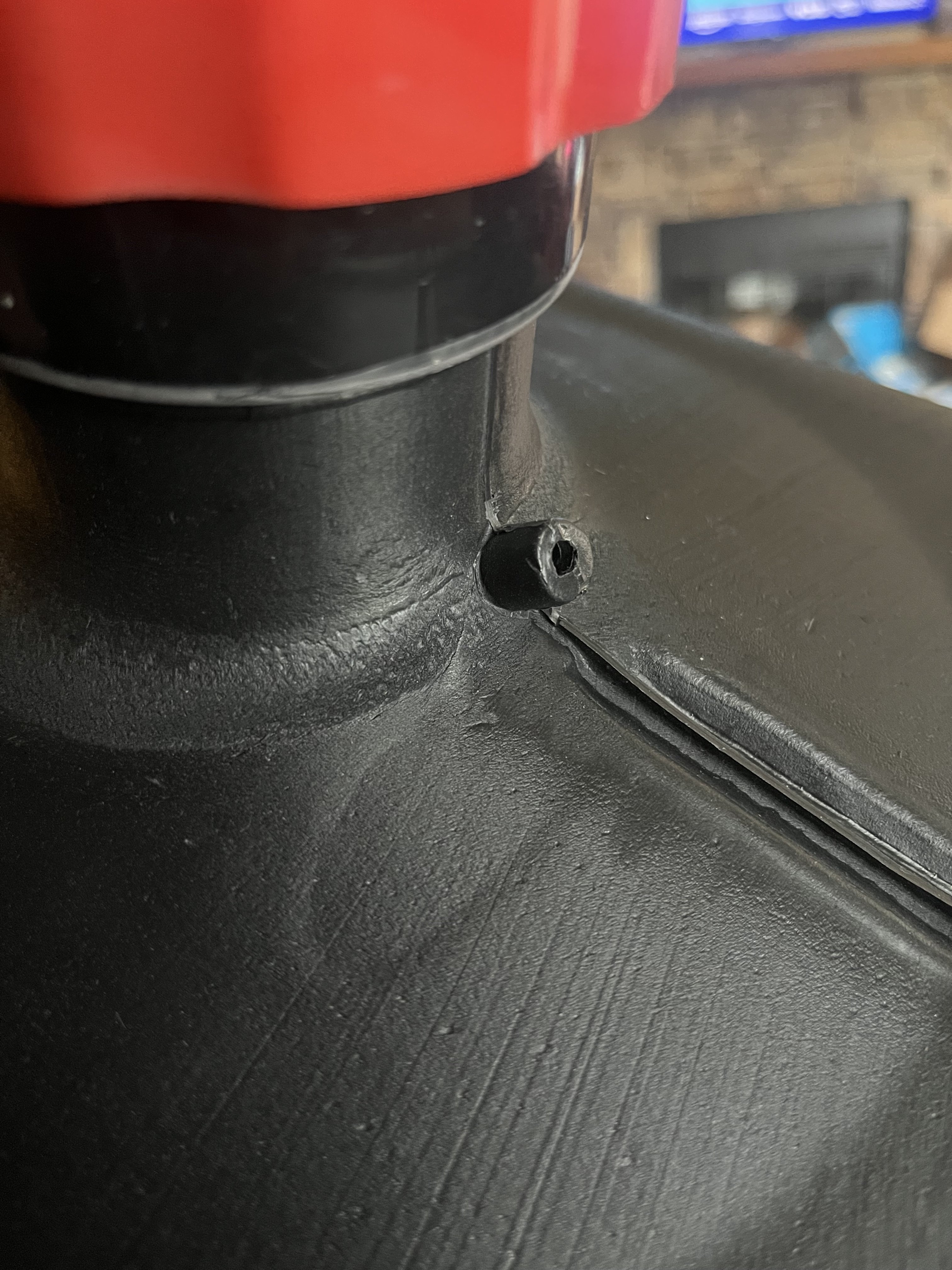

Here is a picture of the new tank with a hose barb “tit” for the fuel return line to go “on.” The tank that’s on there now has a “hole” for the fuel return line to go “in.”
It’s a major difference.

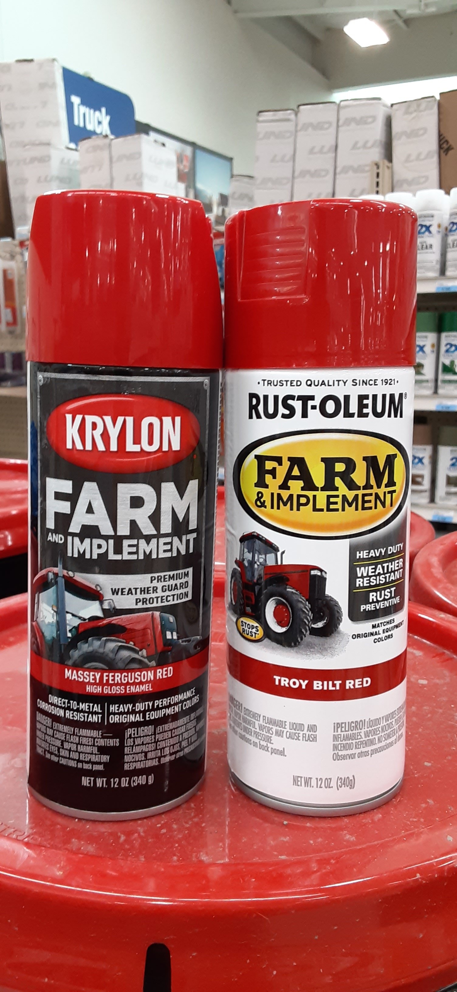

   / YM2500 Pushing Coolant Out the Radiator #79
As for red, Hoye and Fredricks have mentioned Massey Ferguson red is very close. It can be used for touch up. It is one pantone shade brighter.
There is another red one pantone darker and should match Yanmar red. Troy Bilt red.

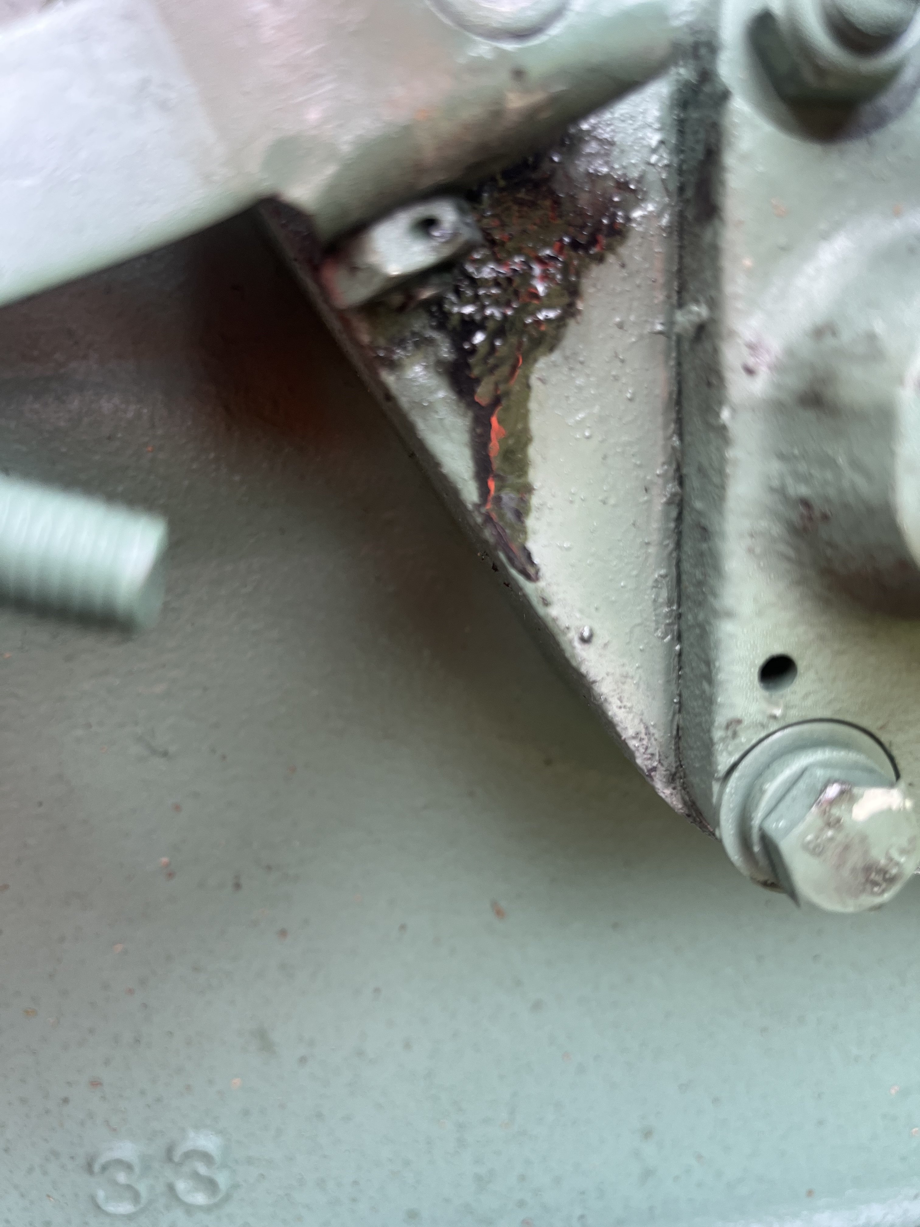

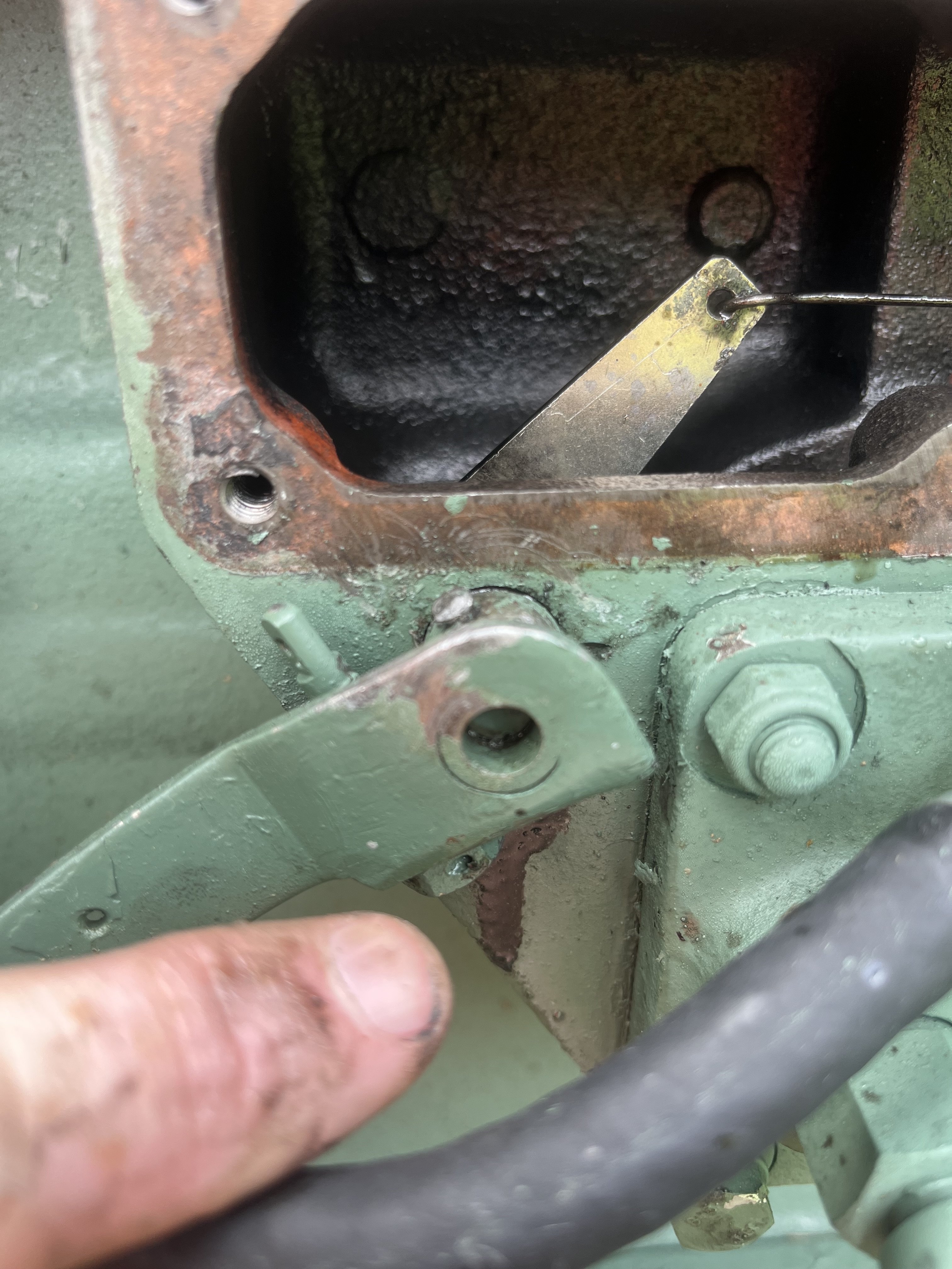

2 new problems.
Too much slack, or “play” in the throttle shaft where the throttle shaft linkage goes into the engine and it’s causing a significant oil leak.
PTO Shaft Seal is leaking. The seal was replaced 1 time at Fredricks’ Service Center the day I purchased the tractor, but the Wear Collar wasn’t replaced.
I sent an email to Fredricks Equipment. Danny replied back stating he is waiting on the General Manager. I should hear back anytime now.
