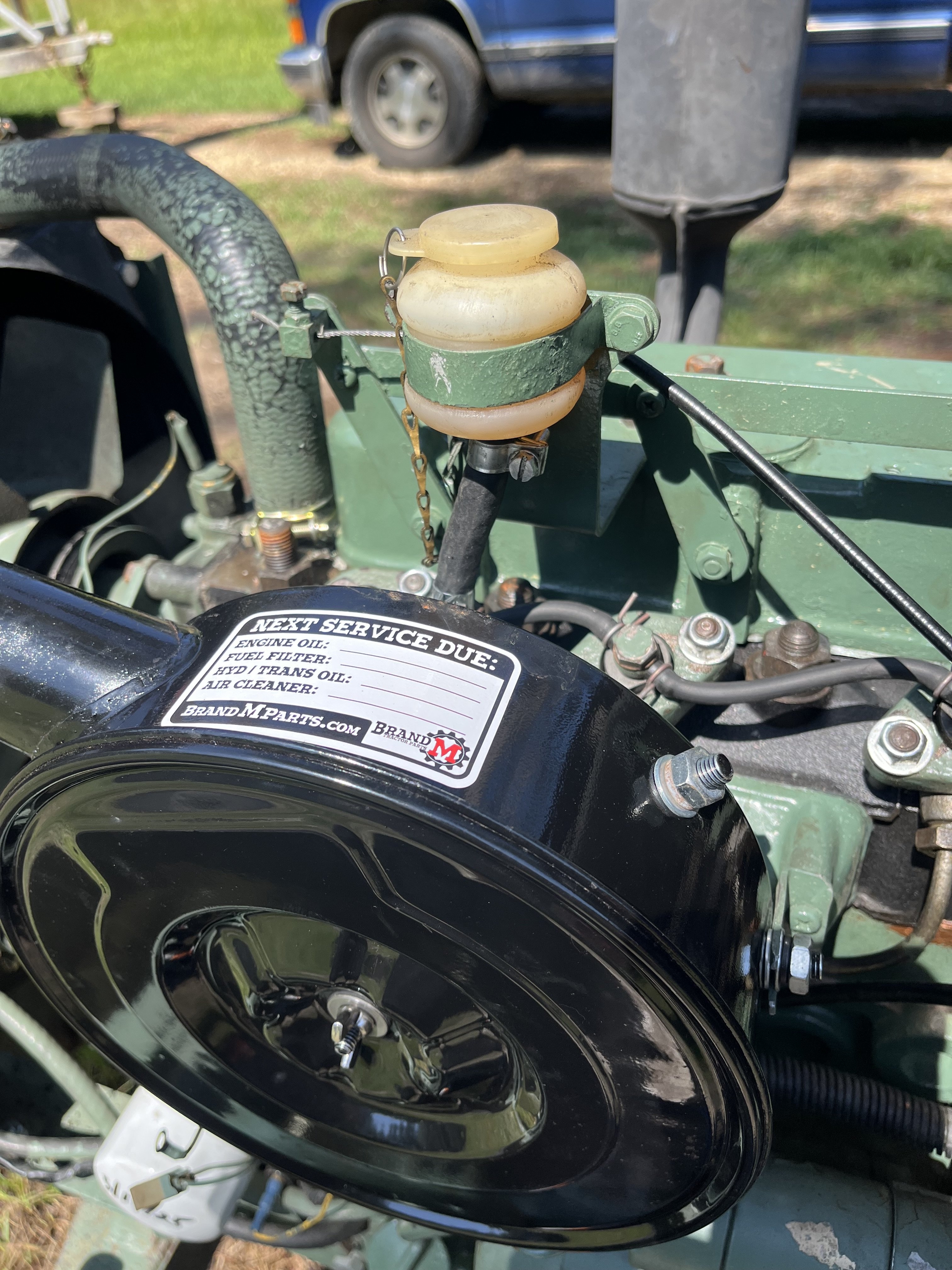

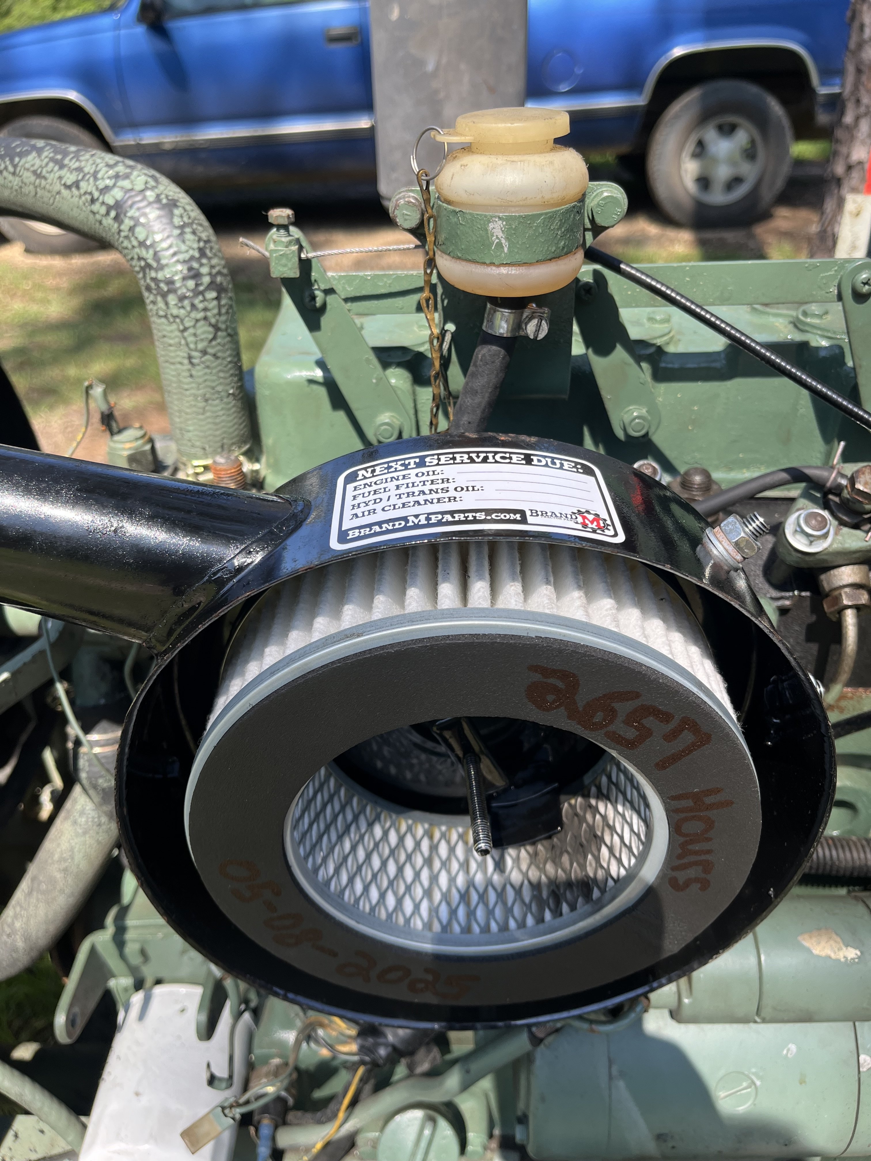

UPDATE 05-09-2025 Friday
The bad news is I can’t find the new exact “Mitsubishi Japan” alternator anywhere online, or at O’Reilly’s, that Bret posted.
The good news is Danny at Fredricks emailed me back yesterday morning early, and sent out another alternator and belt. I’m not sure if it’s new, used, or remanned. According to FedEx, they will be here this Saturday (tomorrow).

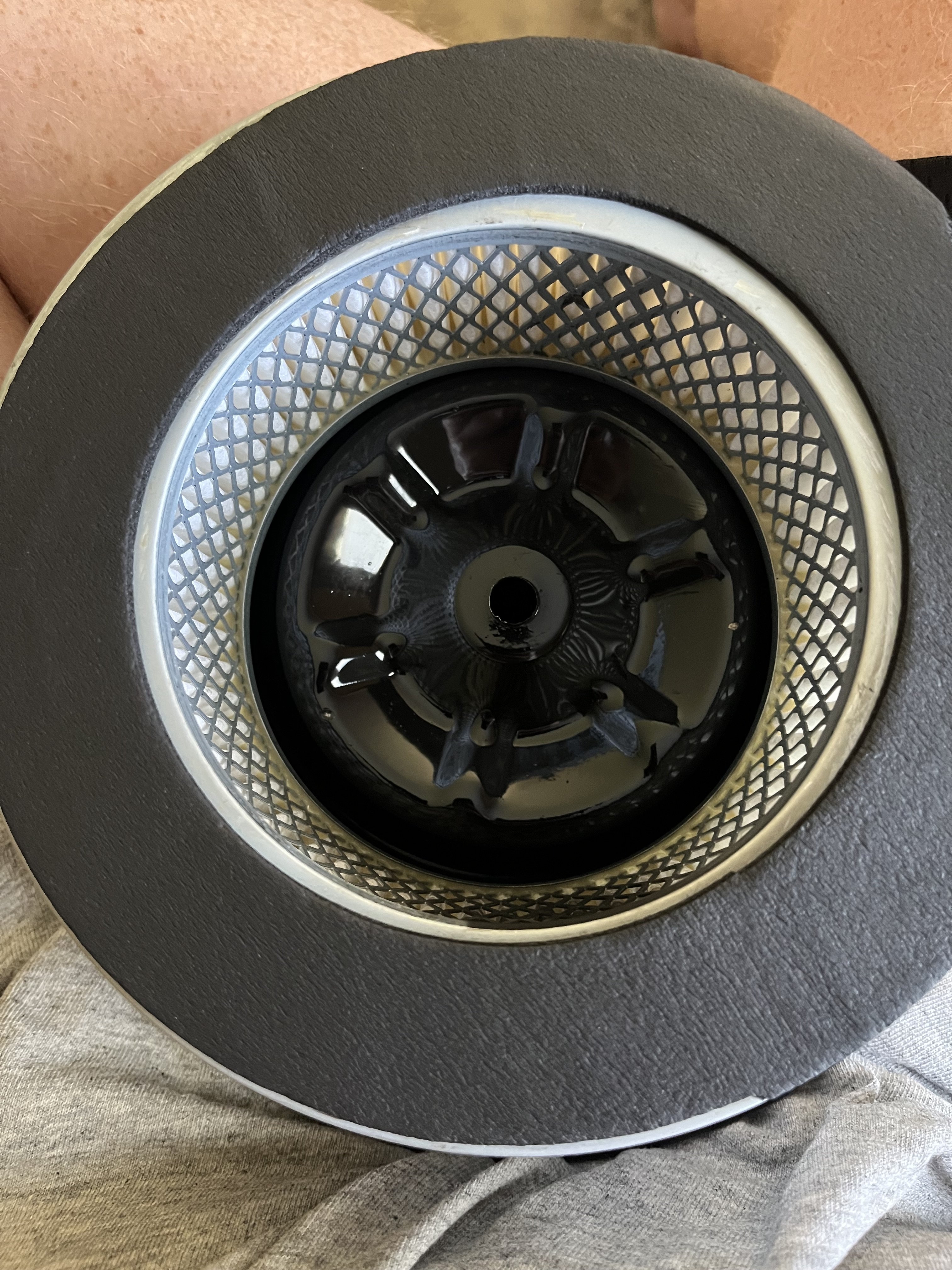

I got the correct air filter and air cleaner installed yesterday. I HIGHLY RECOMMEND the 2 seals that stick to the inner side and outer side of the air filter from Brand M Parts in Texas!!

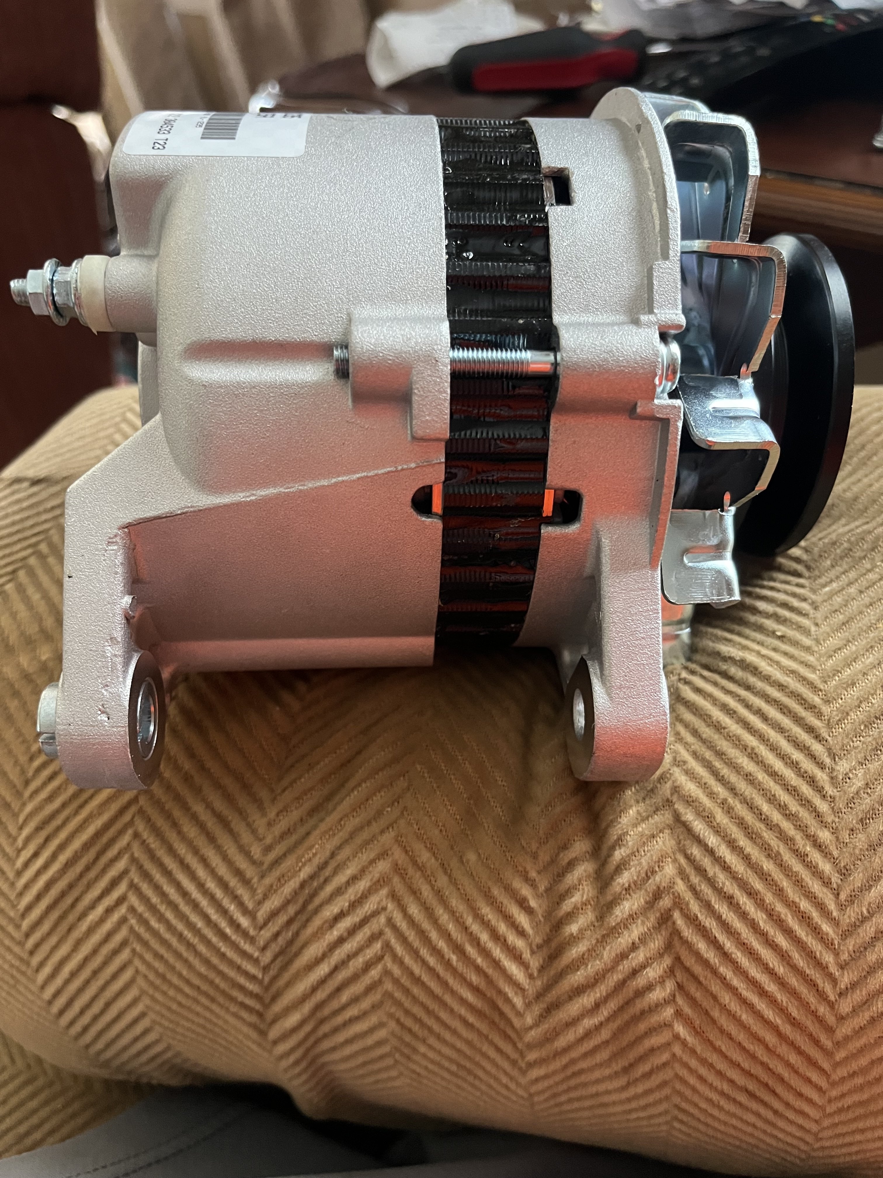

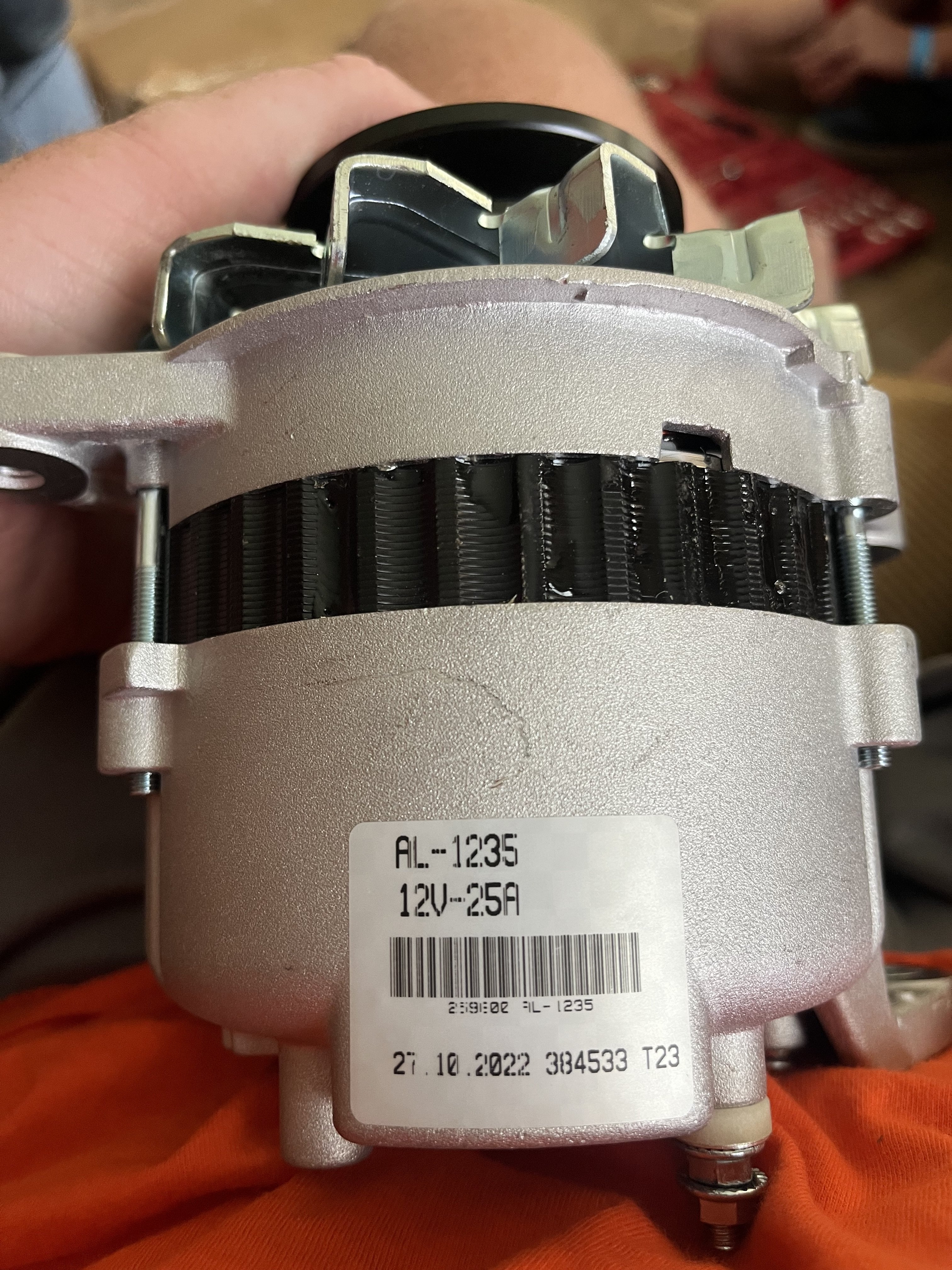

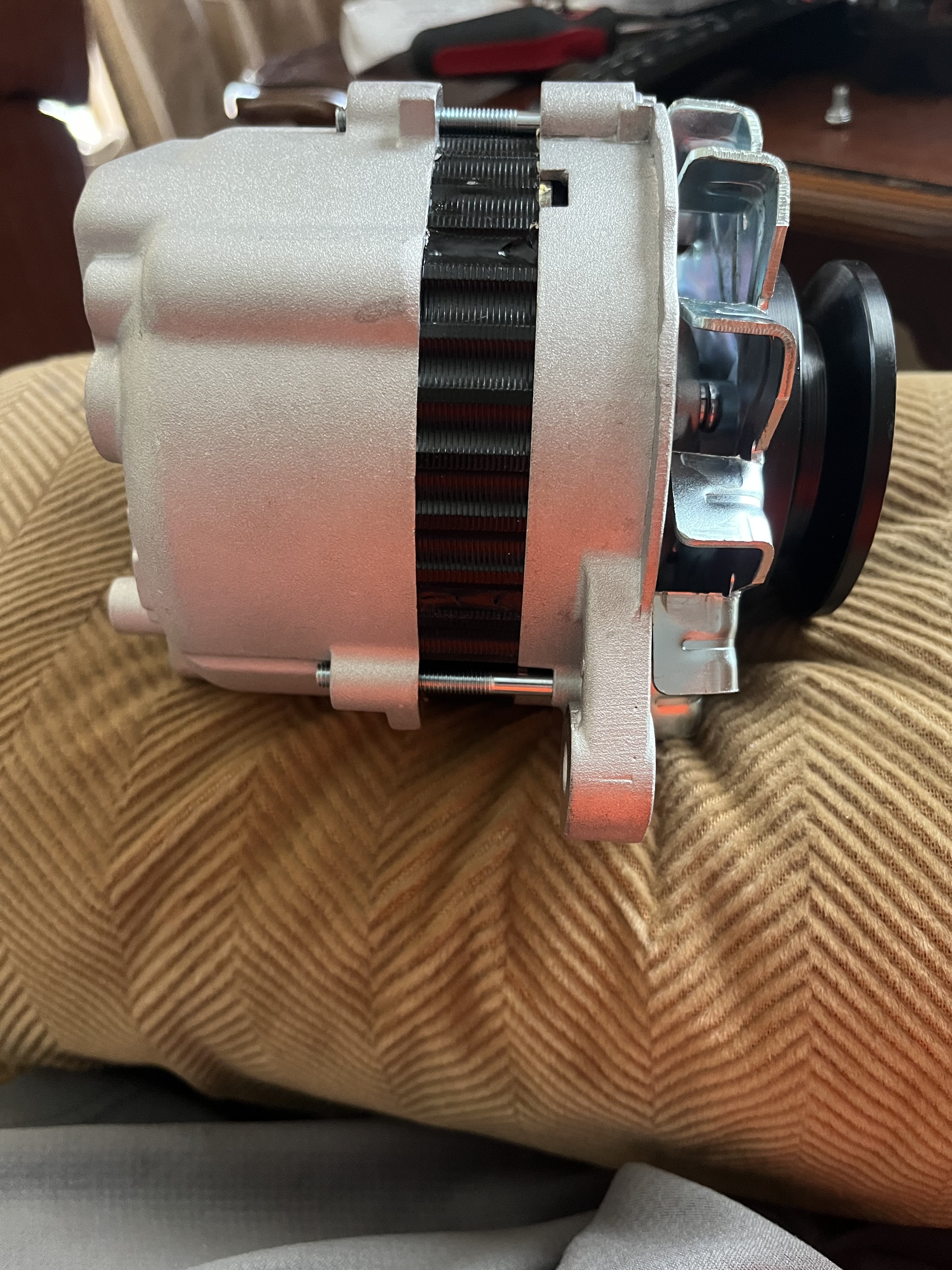

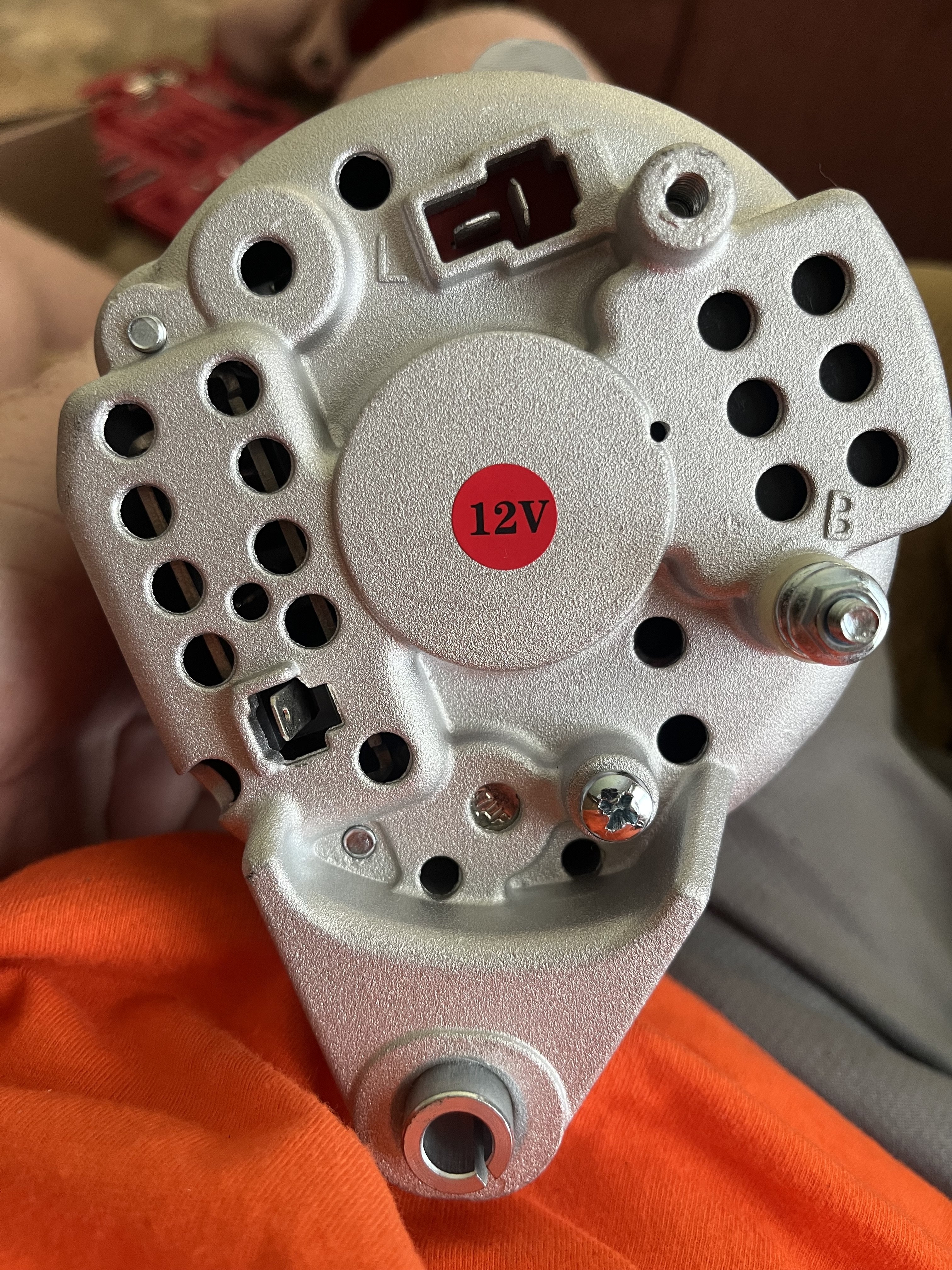

Look at this fine electrical specimen that arrived today!
Alternator AL-1235 from Fredricks Equipment in Hartselle, Alabama. This alternator fits the YM2500, YM2610, and many other models.

   / YM2500 Pushing Coolant Out the Radiator
#55

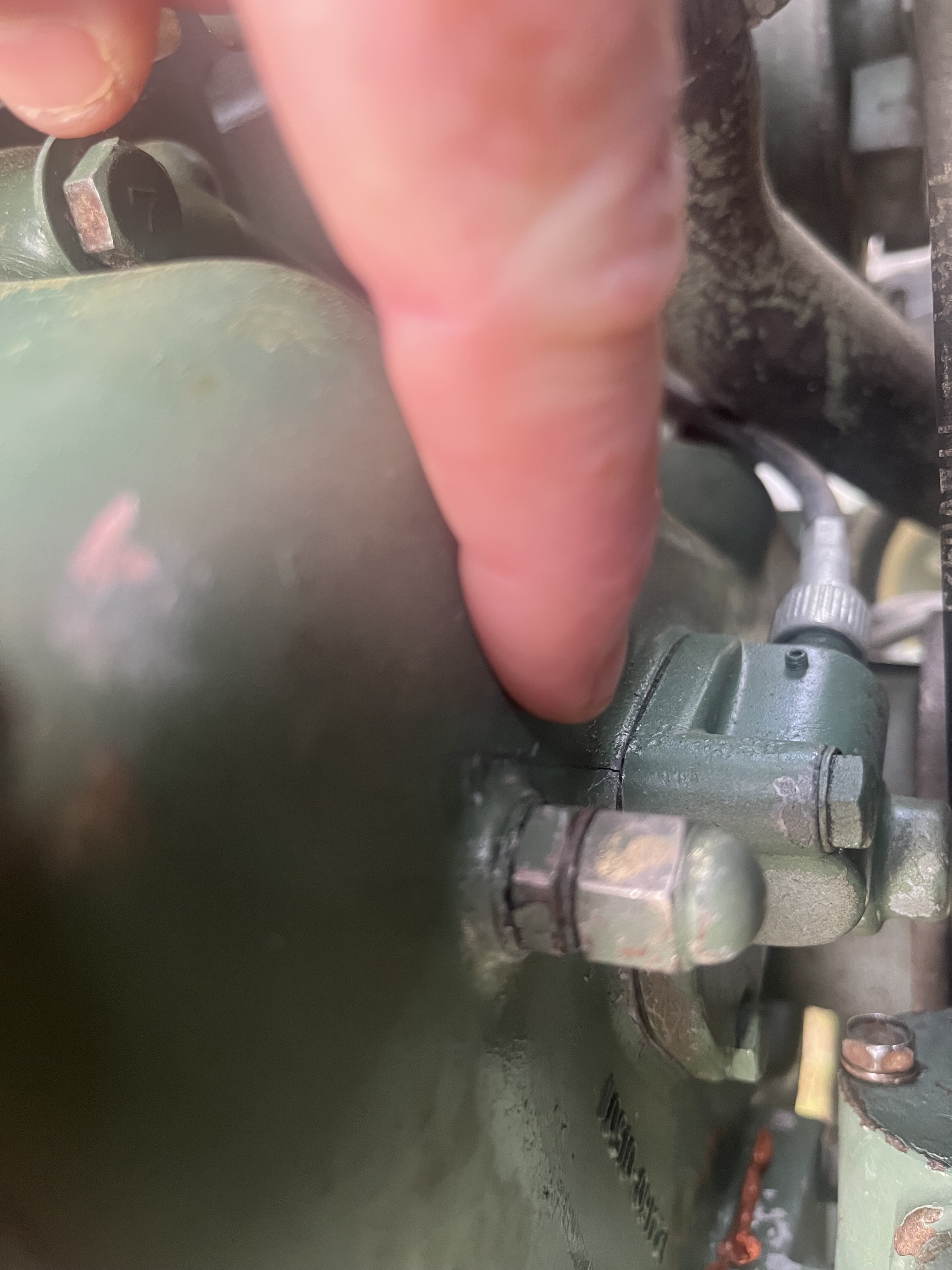

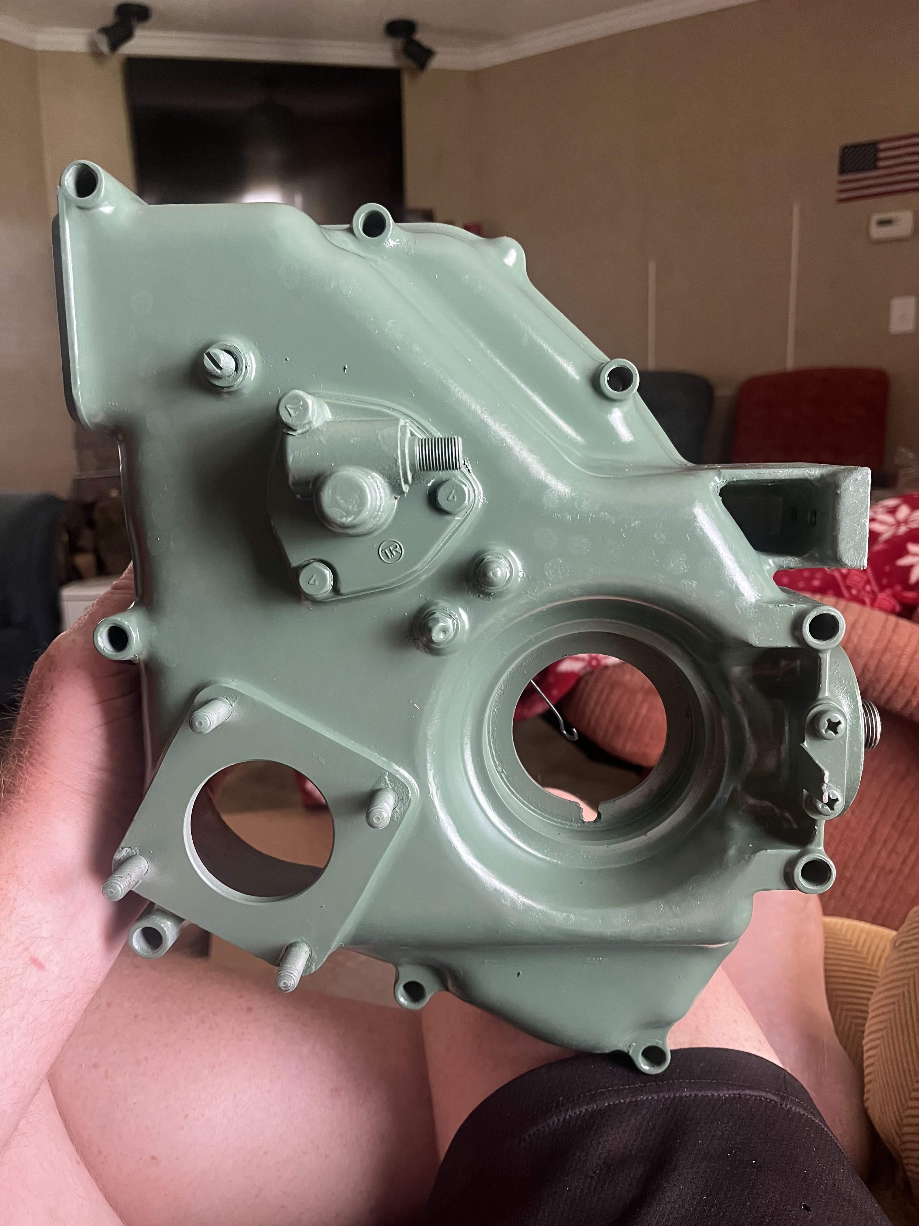

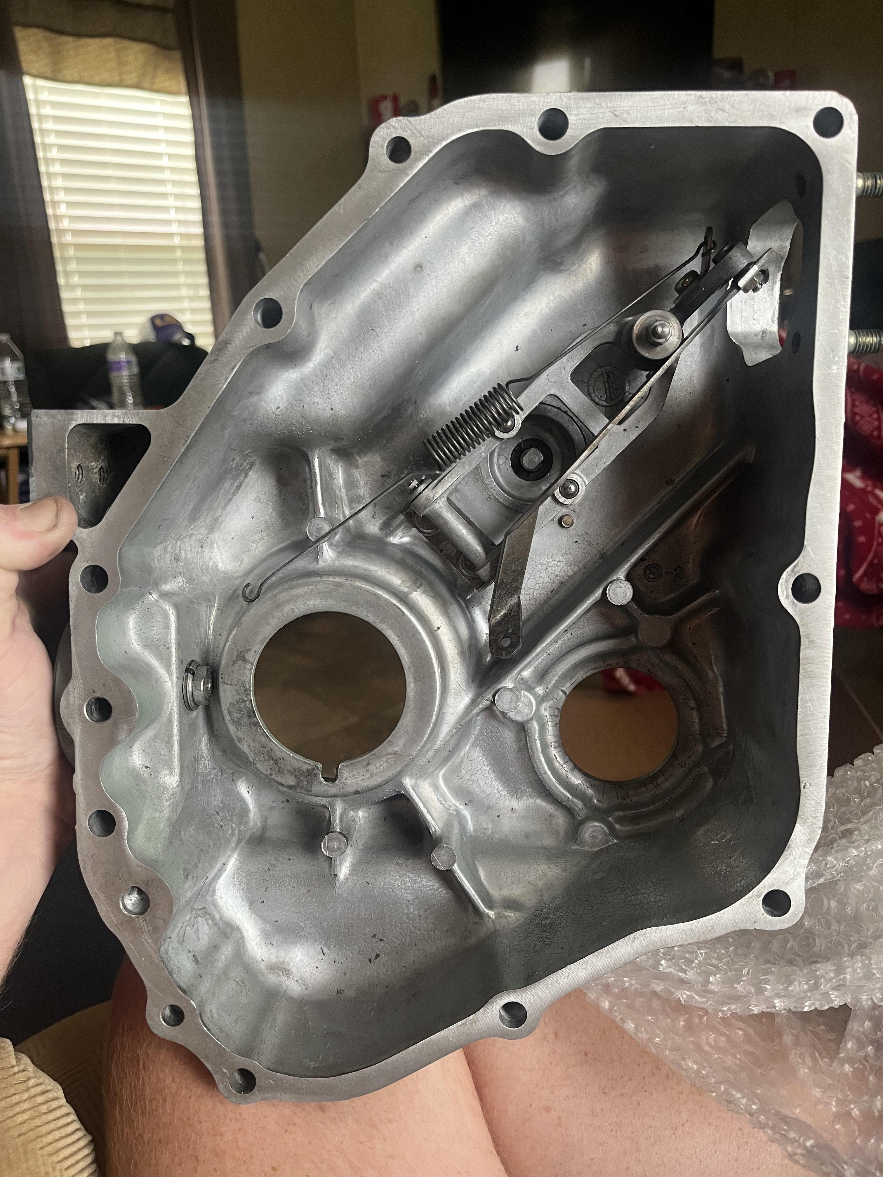

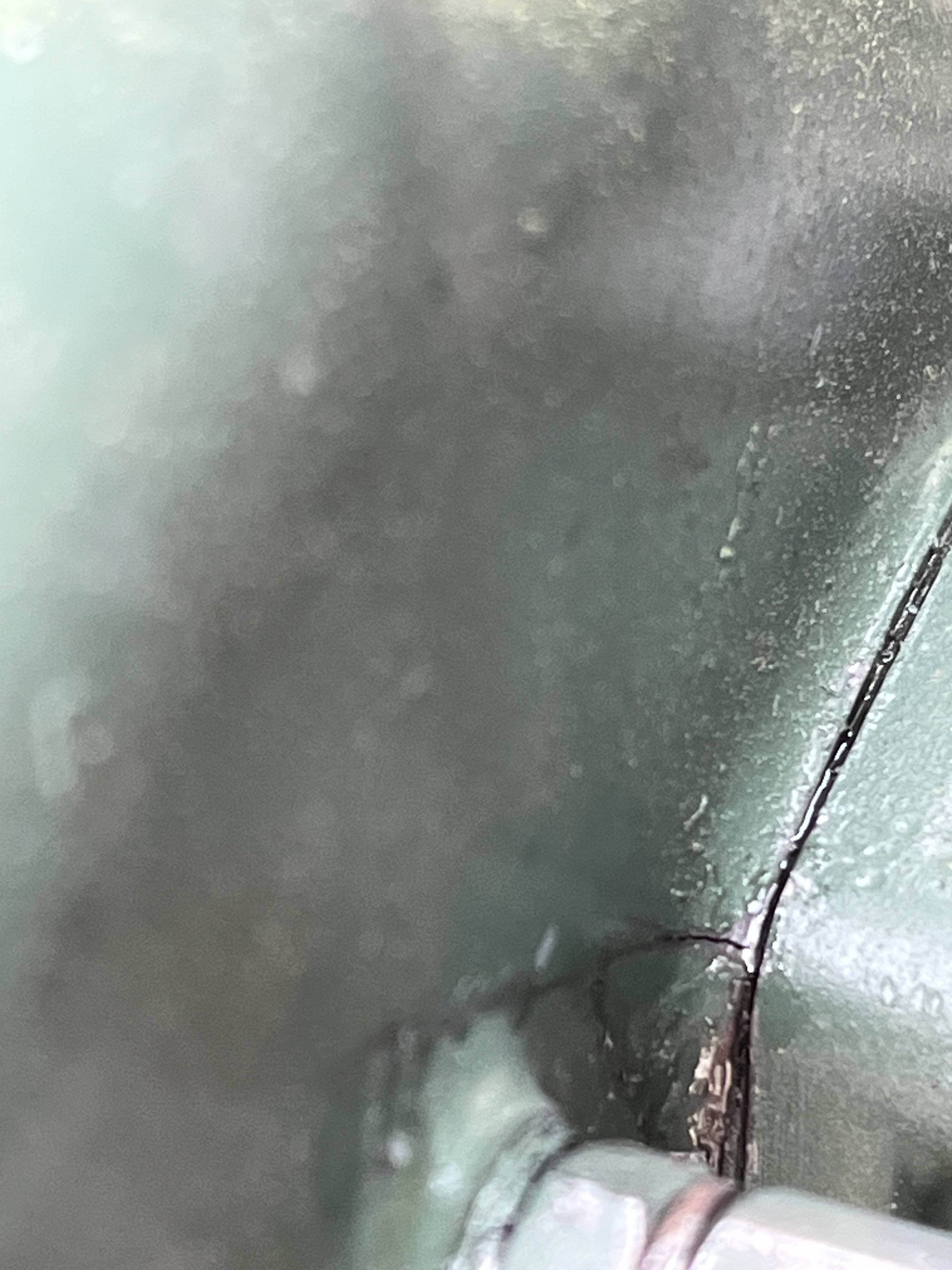

I’m sorry, I guess I forgot to post about the timing cover. I’ve been trying to keep updates about my experience with this tractor on 3 different websites.
The timing cover had a hairline crack coming from one of the bolt holes where the tachometer housing mounts and it was causing oil to leak.
Fredricks sent me another timing cover, free of charge. They also paid a local repair shop the labor cost to replace the timing cover.
Great customer service from both Fredricks and Mobiltech (my local repair shop).

#60
I attached 4 pictures. 2 of the cracked timing cover and 2 of the replacement timing cover.
