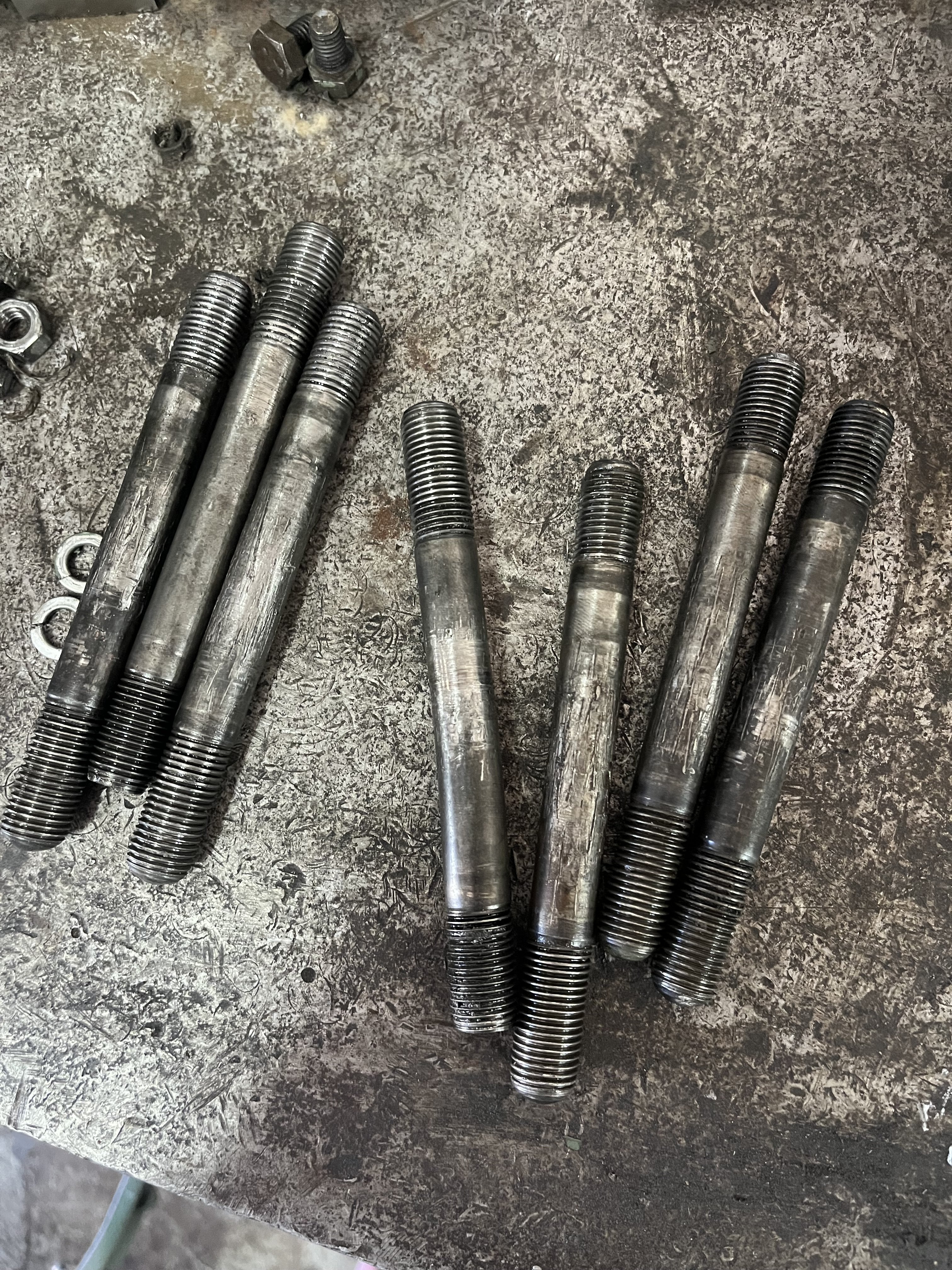

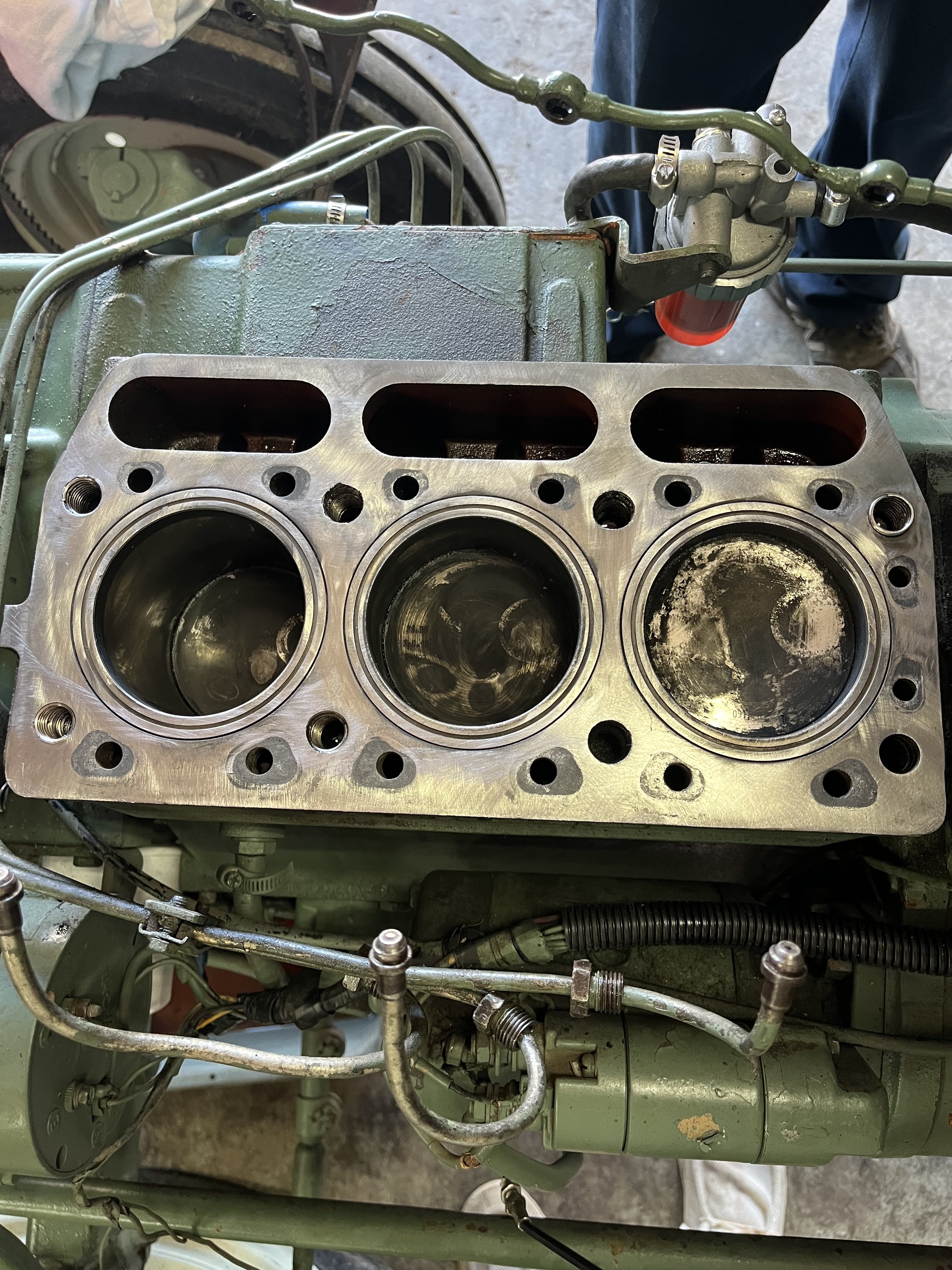

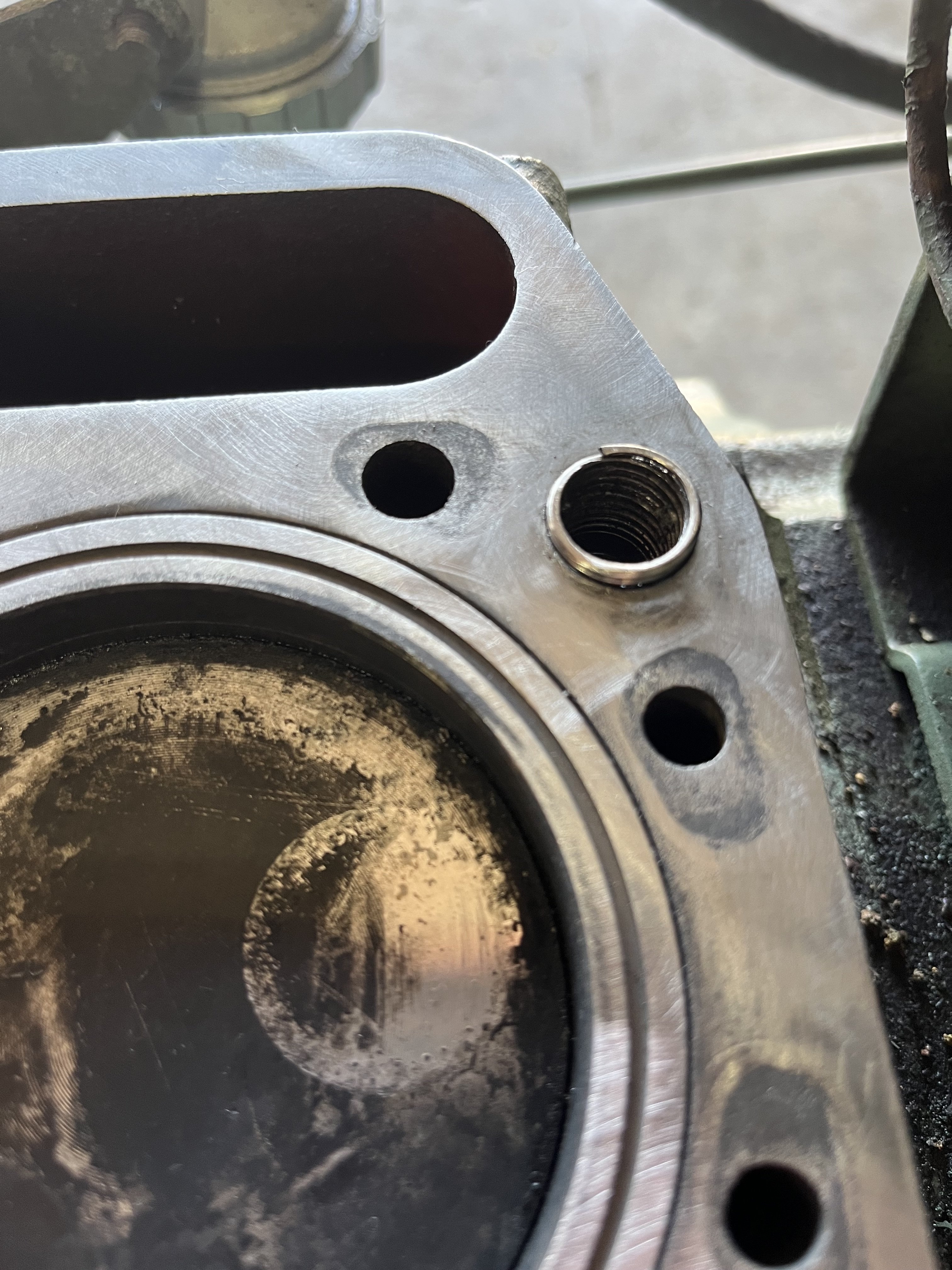

My mechanic was able to work on my tractor some this morning. He was cleaning the block up and found bent head studs and a helicoil sticking out of the block!
I called Fredricks and spoke with Danny. They are sending a used set of studs and a helicoil set.
I hope you and all of your families have a Blessed and Merry Christmas 2024!!

   / YM2500 Pushing Coolant Out the Radiator #36
   / YM2500 Pushing Coolant Out the Radiator #37
Had them stay inserted but the bent stud it pretty much didn't stand a chance removing it and the Threads staying in.

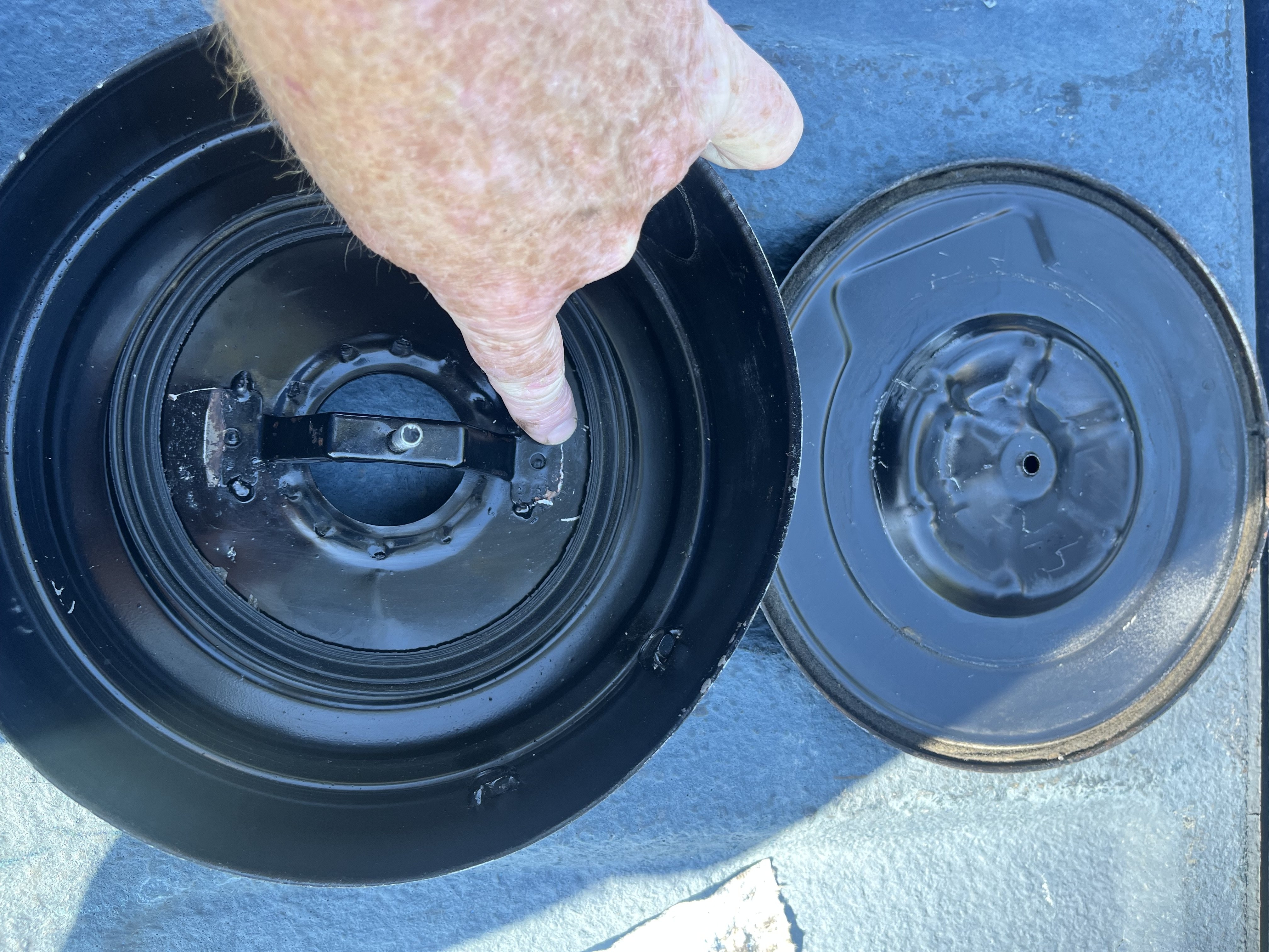

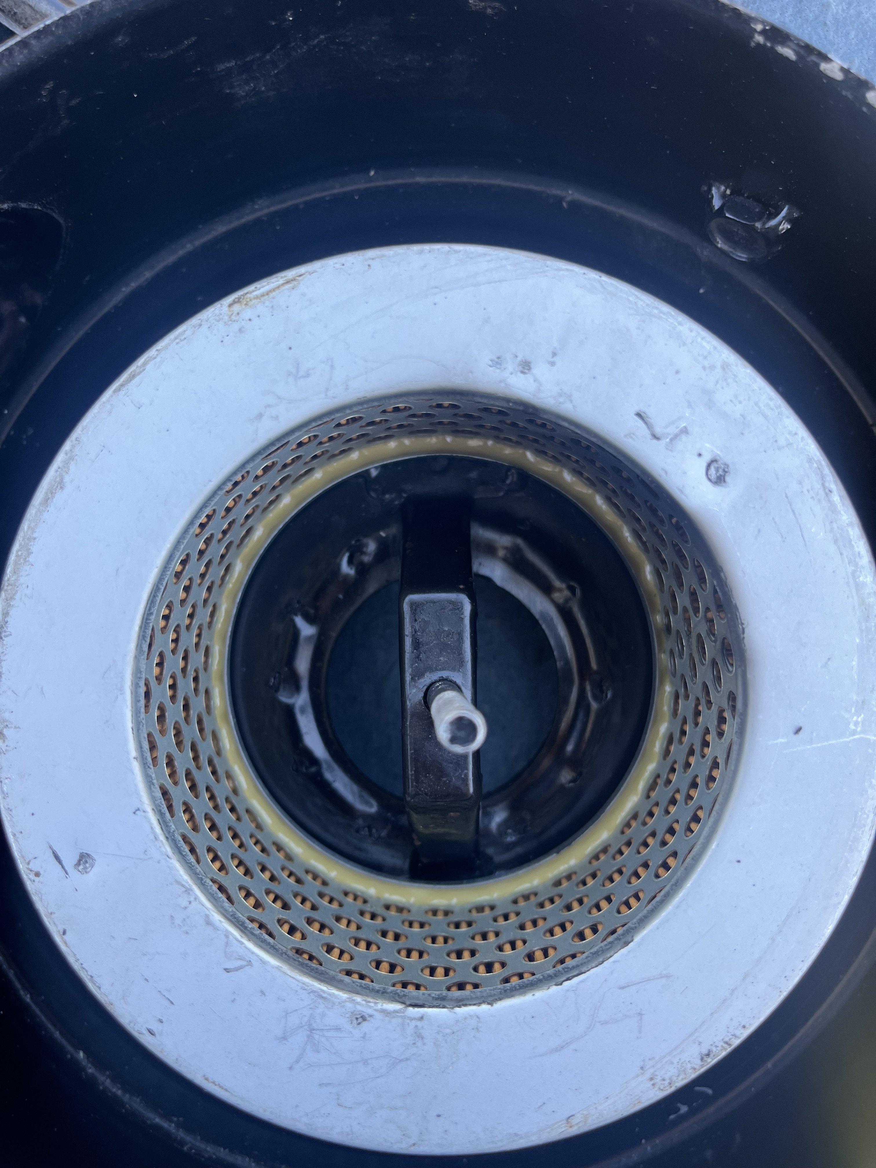

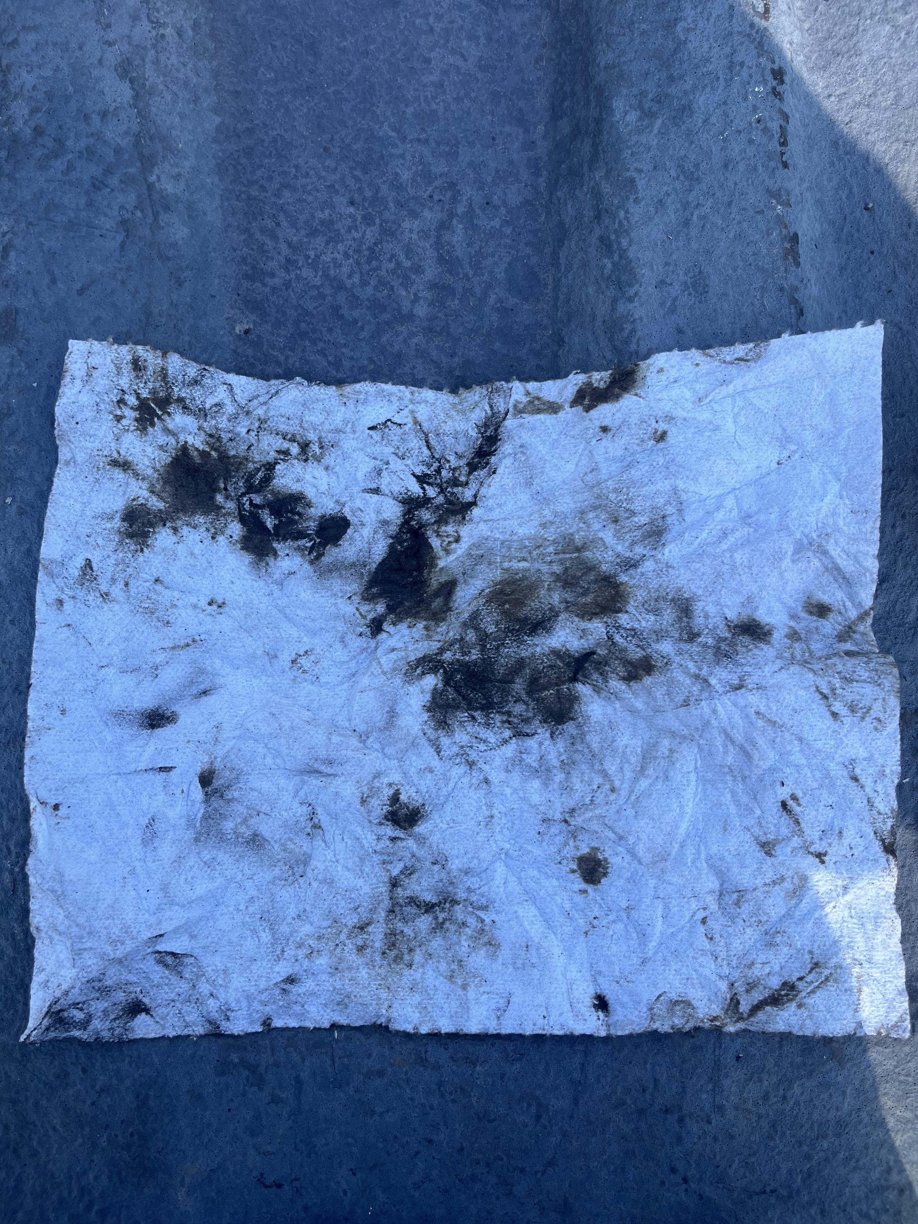

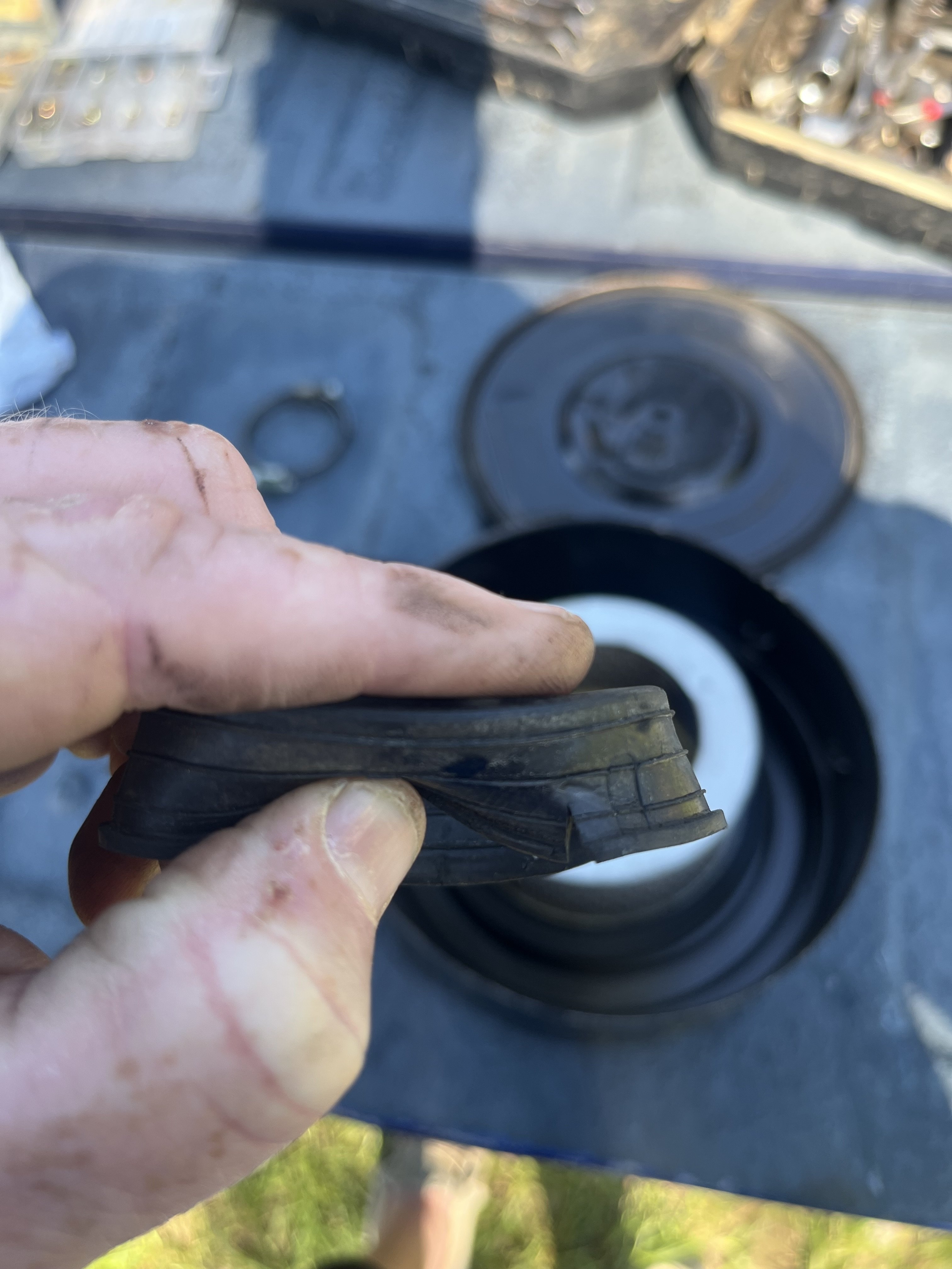

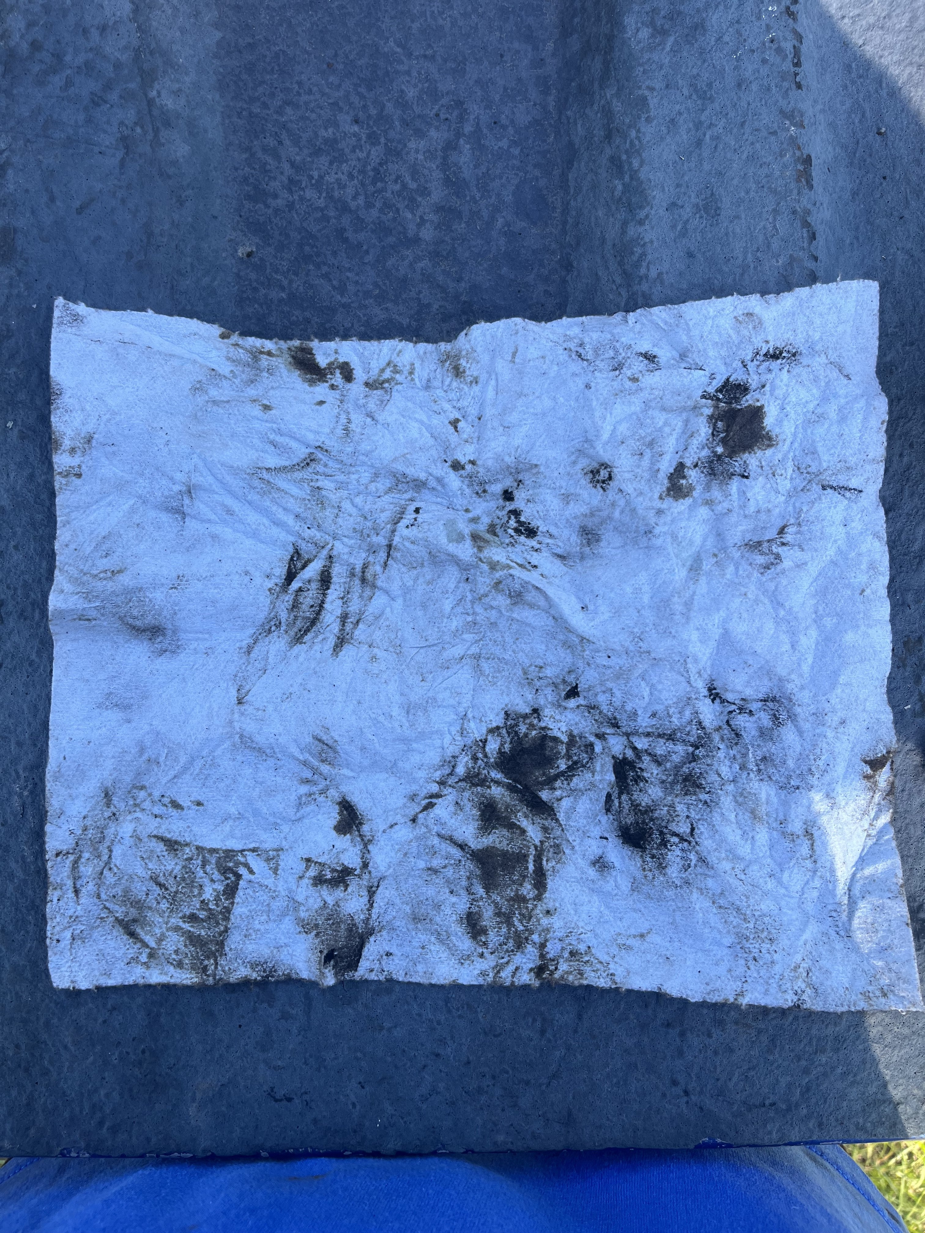

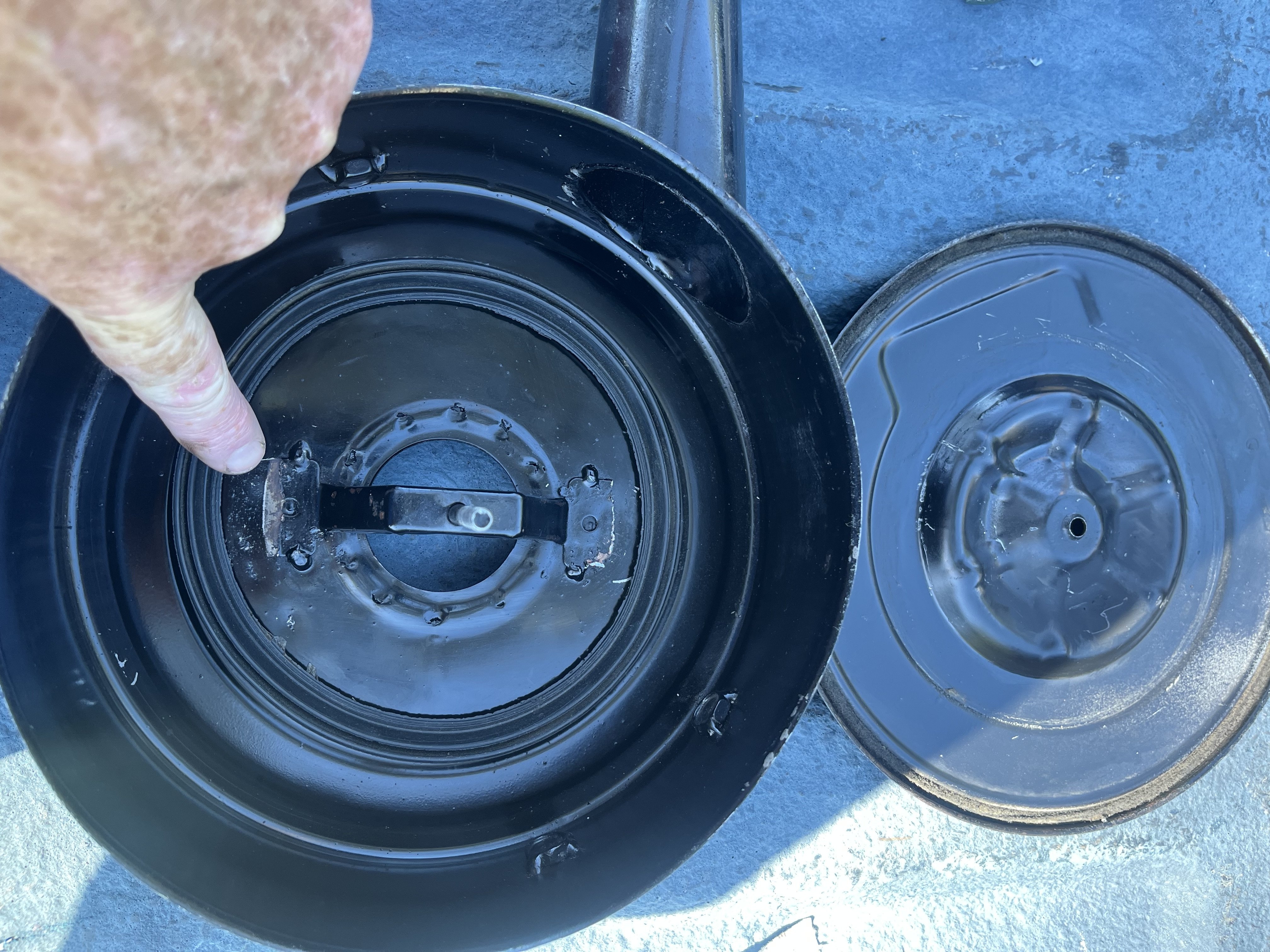

***UPDATE 05-05-2025 Monday***

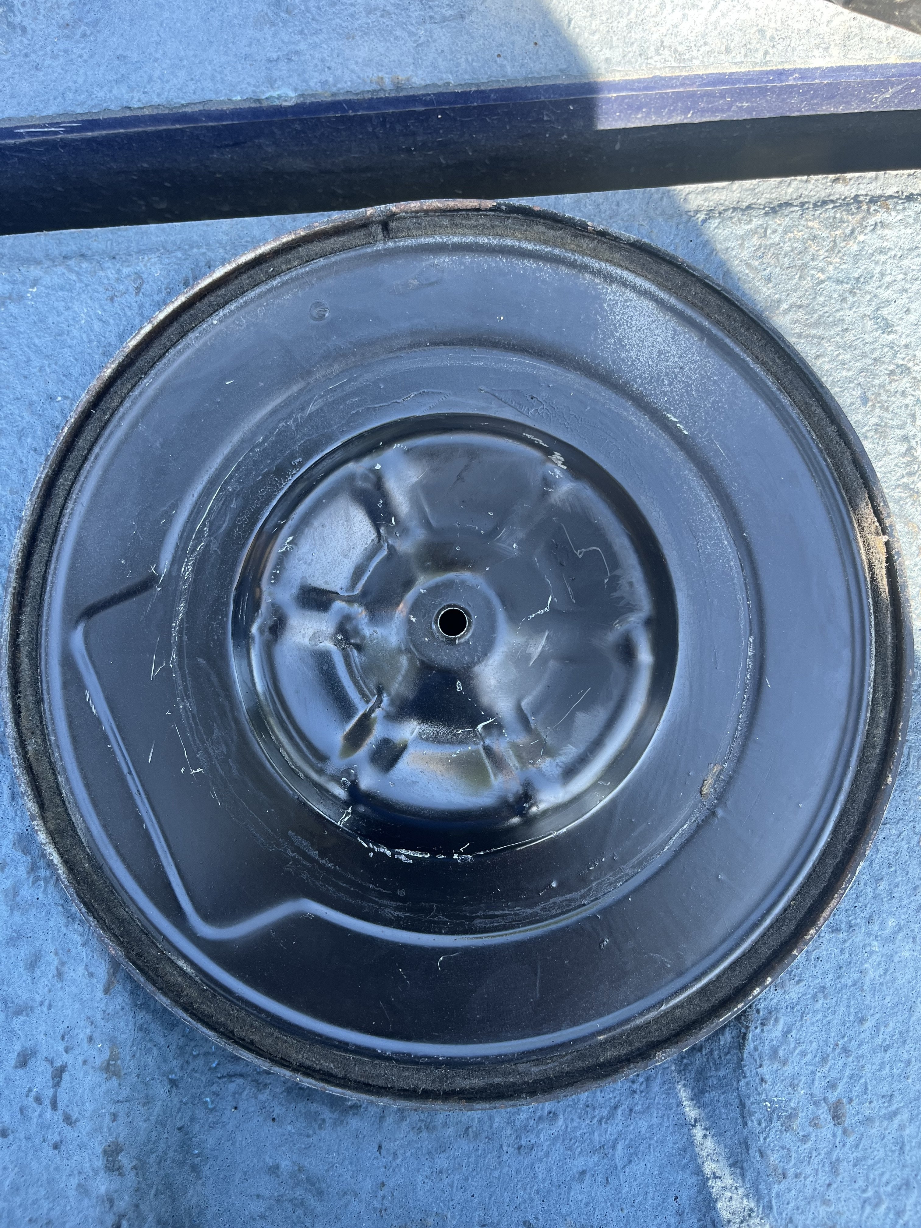

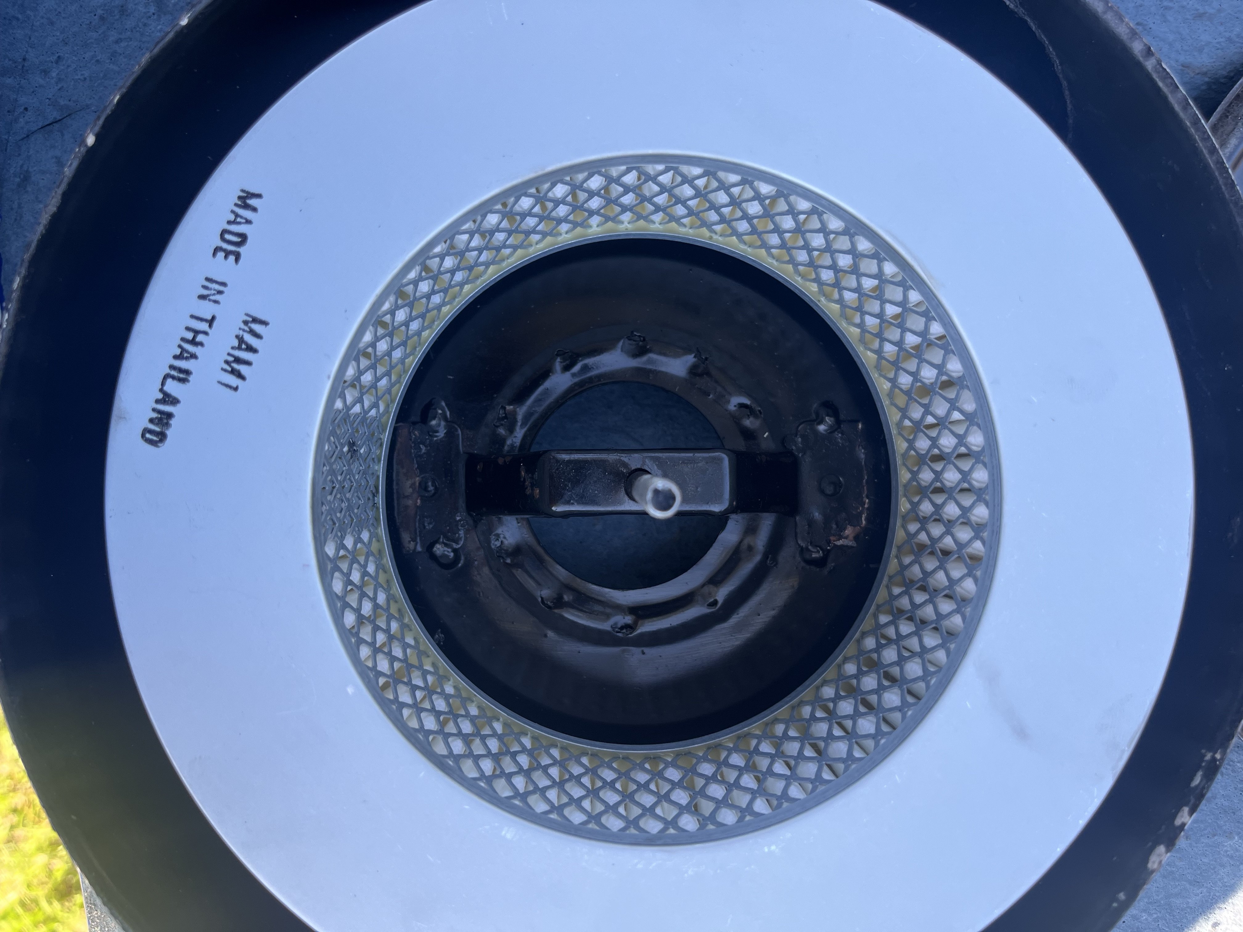

I was going to install the new air filter yesterday and found a big problem with the air cleaner housing. The inner tabs were broke off inside the housing that holds the air filter in place!
The reason the tabs were broke off is because whoever installed the small, incorrect air filter, broke the tabs off to try and make the small filter fit inside the housing!!
It came back from Fredricks like this after the engine rebuild and I’m not happy about it.
Also, it was plumb filthy inside the air cleaner housing and this was a freshly rebuilt engine!! I wiped the inner filter housing out with a new blue paper shop towel. See attached pictures.
With that said, I sent Fredricks an email with pictures yesterday explaining everything I found. I didn’t get an email or phone call back from them this morning before noon, so I called them.
Danny said things were very busy. Said he’d read the email but didn’t see the pictures. He opened up the email while I was on the phone with him and looked at the pictures. He said he would be shipping out a filter housing to me. I told him to include a return shipping label and I’d ship the old housing back to them.
I received a notification from FedEx this evening that I’ll be receiving a shipment from Fredricks in a couple days.
Again, I’m not happy at all about this, but at least they’re standing behind the tractor they sold me.
