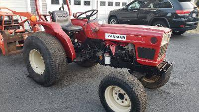

I've been searching all over for various options to keep this project moving forward and have found little as far as tractors/engines for sale go. I've been checking ebay, craigslist, tractor auction sites all over the country and then this just popped up for sale and is less than an hour from me.
It's the exact same tractor (ym226d) and visually is in way nicer condition than mine. I spoke to the guy selling it and the engine is currently being rebuilt but he has everything to complete the rebuild. The story is that the previous owner used starting fluid to get it going and cracked the rings. I was told the injectors and pump were just rebuilt and that he has the new pistons and rings to put in it. He said the cylinders were fine, although it doesn't seem like the sleeves are hard to replace, and as far as he knows everything else works. The tractor has 400ish hours on it and he is asking $4500.
Compared to spending over 3k in parts, this seems like a way better deal but I'd love some outside opinions if anyone has one. If I purchased this tractor my plan is to make my current tractor the parts tractor and get this new one running. I would move the hydraulics/loader over to this one and end up with a ton of spare parts to either keep on hand or sell to recoup some costs. I think I would come out ahead as far as being invested about 5k into a complete and running ym226d with loader and rops plus a parts tractor, but I'd love some feedback. Thanks!

I would do it. Those tractors are hard to find, especially as nice as your combo tractor will be.

At the present time, tractors have increased in value. Seems the tractor forums across the web and into other countries have people looking for a machine. Having both machines would be a sure win and even better should one sell both together years down the road. It's better than insurance, it's like a vault of gold.

Looks like I'll be pulling the trigger on this. Hope to have the new tractor by the end of the weekend. Thank you all for the feedback.
