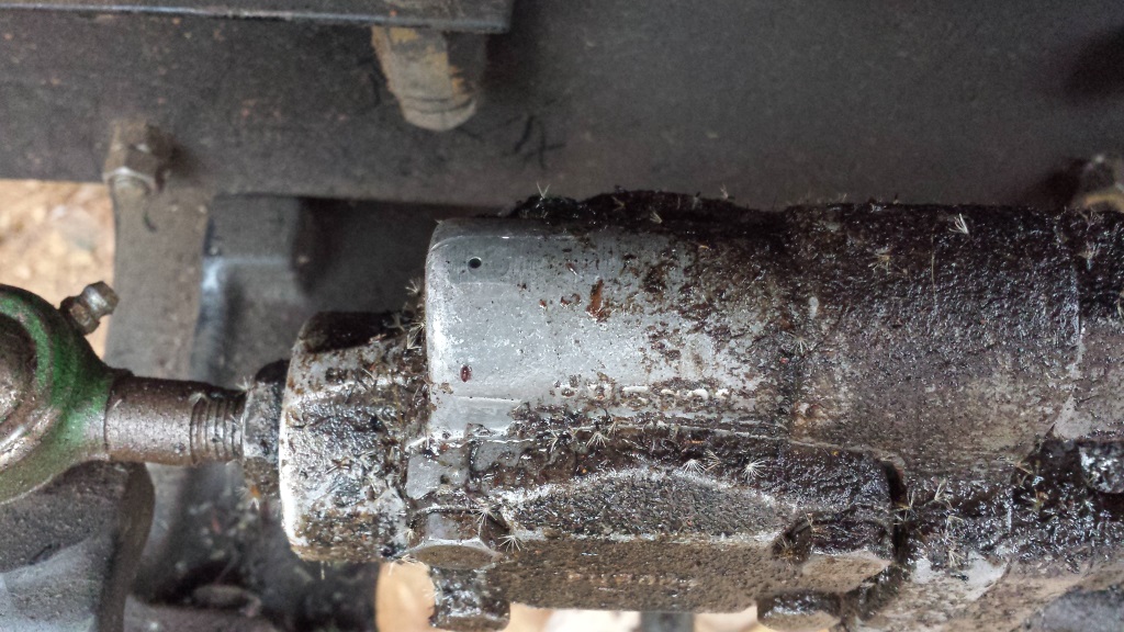

Hi Everyone, Hope you all had a Merry Christmas.
I have a project I need to do on the Yanmar, my power steering has been leaking fluid for awhile now and is getting worse. It drips and also shoots hot fluid into the air when I turn a certain way, there is a small pin hole on the top of the valve where this happens.

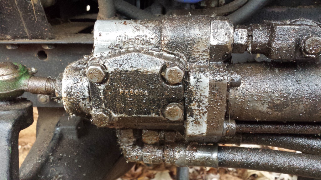

The markings on the cylinder are, main housing "PH5001" and on the side "FM5004". I was hoping someone has tackled this project or knows what type of power steering unit this is, Yanmar or After Market? I just probably need seals/orings for it, hope they are available.
Any help identifying this is appreciated. I attached pictures for reference.

If the fluid is coming out of the pin hole "were it's nice and clean" that looks to be a vent hole. Which in my unexpert opinion is a cyl leak. and prob just a bad Seal. I can't see why a Hyd.Shop can't go through it. Doesn't look like there's much to it.

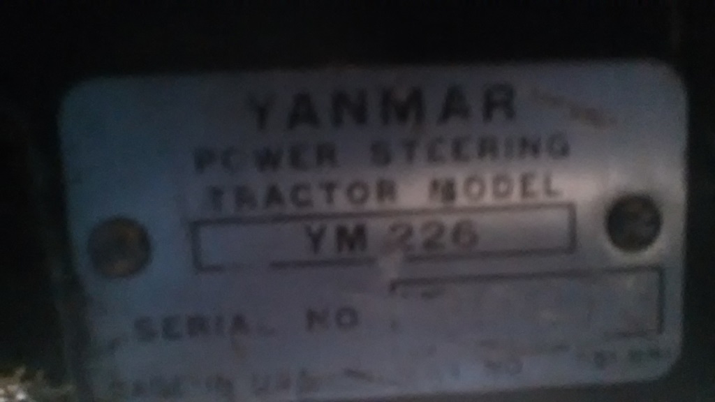

I spoke to a yanmar parts dealer and was told there are no factory yanmar power steering units, even the US models were equipped with after market. But I am not so sure that is a true statement, I cleaned it up a bit and found a tag on the back of the unit, its facing the tractor so it would need to be removed to see the serial number on it, but it does appear to be a yanmar model. I managed to get a pic best i could, don't have time to remove the cylinder today.
Was hoping to fix it myself but may just take it to a hydraulic shop if no one has any advice / experience fixing one of these.

Look at the bottom right PH5074-1 seal kit. Someone should have it. I can't find it so IMO. Hyd shop.

When I bought the second YM186D a few months ago I had the same problem on the same PS unit. (Maybe the 226 kit has a longer linkage or other external attachment differences but the cylinder is the same.) The manual in the thread linked by Winston covers this system. My research indicated that old threads here are the only documentation available anywhere aside from that original manual, and that the supplier of the kit disappeared decades ago.
The problem, documented in an old thread, is that the control piston driven by linkage from the steering wheel has that vent to let air escape beyond the piston. But the O-ring sealing the control piston wears out and lets fluid leak to the atmosphere side of the piston. This fluid squirts out the tiny vent hole when you turn right (left??) and the piston moves forward.
One of the old threads here said it is simple but time-consuming to remove the kit and replace that o-ring. The process is documented in that manual.
However I looked mine over and the project looks more difficult than I expected. You need to somehow grasp the delicate aluminum body casting while applying 100 ?? ft lbs of torque to the big nut at the back end of the primary piston, before you can remove the little control piston that is the problem. Also on mine I was unable to unscrew the steering link at the front end of the cylinder casting, or the rusted length-adjustment threads at the back end of the linkage, back by the steering box. I decided to put the project aside until I had plenty of time to approach the project thoughtfully. A year has passed ... . The fundamental problem is that the aluminum body casting is irreplaceable and looks delicate, and I don't see how to hold down that odd shape to unscrew components from it.
Another issue the manual describes as critical is that the balance of steer left / steer right pressure is calibrated during factory assembly and requires special equipment. (that probably doesn't exist today). So don't take apart the component containing the balancing springs! O-ring replacement can be completed without getting into this. We just need to remain aware that that sub-component is not to be disassembled.
I gave up and covered the hole with a radiator hose clamp to direct the fluid downward as a dribble, instead of squirting upward into a big puddle in the loader chassis and drenching the side of the hood.
I'll replace the O-ring when I get around to tearing down the kit - probably after someone else describes how they did it.
Anyhow power steering sure is nice. I didn't realize what I was missing!

So I am clear as to what you are saying do not take apart, can you reference it from the diagram in the other thread? Also which oring are you referring? #11?
maybe you are referring to not taking the cover "FM5004" off, from my attached picture above?
lastly, any idea what size that o-ring is?

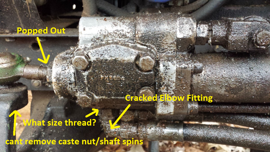

Ok, I have quite a few issues, Please see the picture and any help is much appreciated.
ok, all this happened in a bad spot, behind my house near the creek, so my tractor is sitting back there until I can find a fix. My first thought was to disconnect the hydraulic hoses for the power steering, remove the power steering cylinder, purchase a drag rod/tie rod to connect steering arm to axle, so basically make it like most yanmars without power steering. Unfortunately I am unable to find a drag rod assembly for my tractor (YM226D) I have spoke to HoyeTractor and Fredricks. Not to mention the hydraulic configuration isn't so simple, hoses going from the power steering cylinder to a plate under the seat, to another plate below the 3 point lever then leaving there and connecting at the front loader valve.
Well, to continue the saga, the threaded tie rod that screws into the power steering cylinder stripped out and fell out, resulting in the cylinder falling and cracking the hydraulic T fitting spraying hydraulic fluid everywhere.
So more questions:
1. If the threads are stripped inside the power steering cylinder where the threaded tie rod screws into it, can that be repaired? Hopefully its just the threads on the tie rod itself, I have ordered a new one from Hoye, hopefully it will screw into the cylinder allowing me to at least get the tractor back to the shop.
2. Any idea what size the threads are for the cracked T fitting?
3. I can't seem to remove the old tie rod castle nut, it spins the entire shaft going into the ball joint, whats the trick?
I attached a photo to help with my questions.
