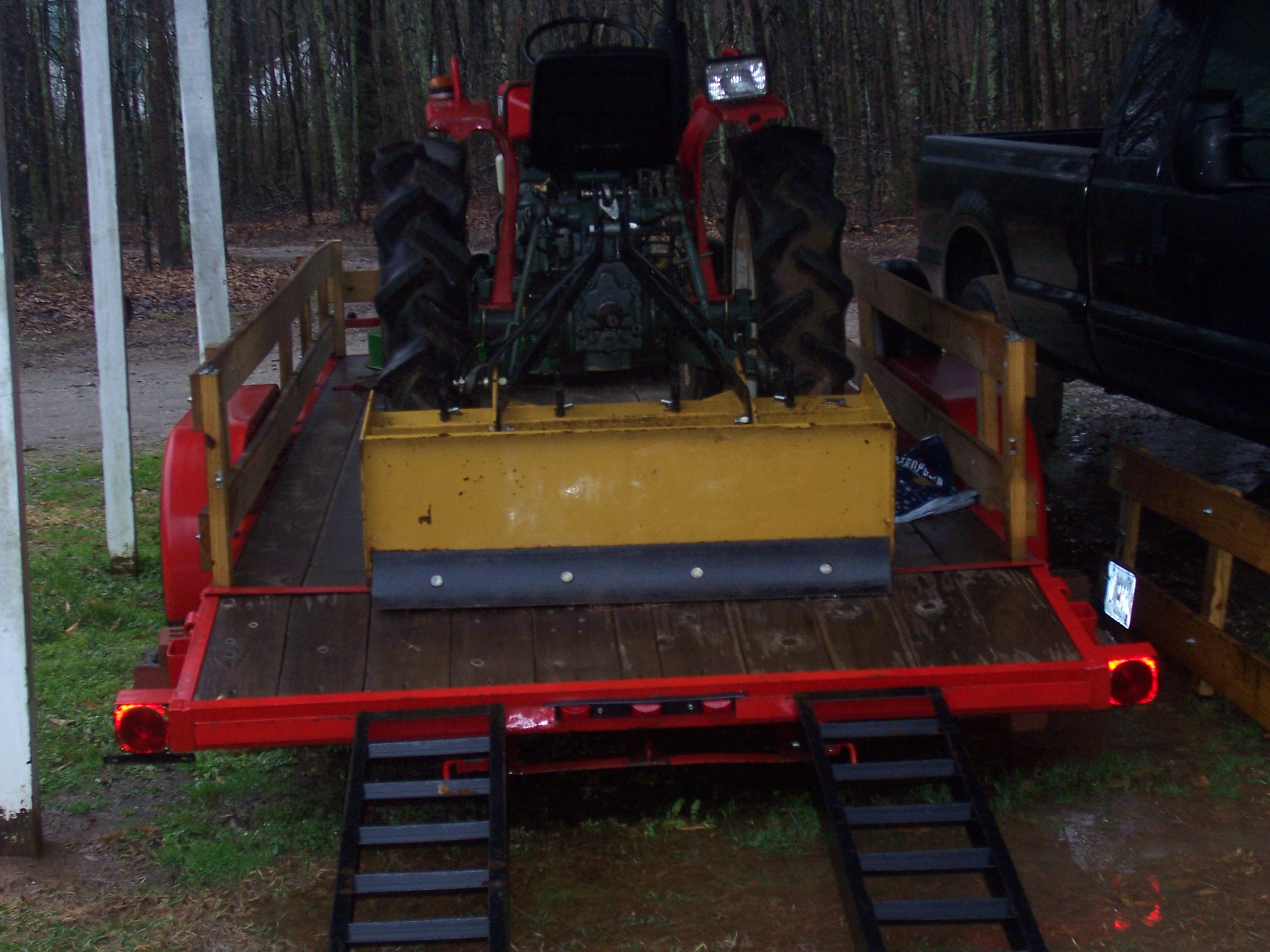

I use a 4' it's the same size as the width of my rear wheels Works Great. being the same width make it easy to use don't have to worry about catching it on anything if the tractor goes by it. IMO. also better to have to much Hp. then Just not enough. I use it mostly to keep up with my 3/4 mile gravel Dr.
Carey
