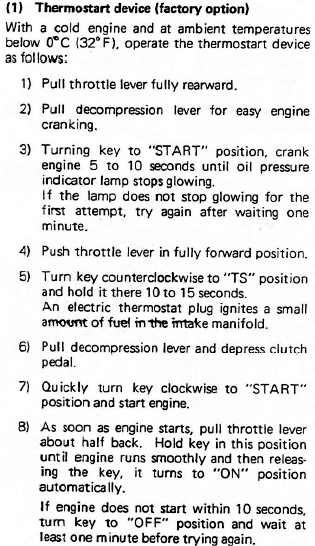

Here's the cold weather instructions that American Yanmar put in their manuals.
(Note the American throttle pushes forward to accelerate, the opposite of the Japan-market tractors.)
[click to enlarge]
Their warm weather instructions don't mention the Thermostart. Just full throttle, use decompression lever, turn the key, then "when starter gives enough rotation to start engine, release decompression lever. Release key immediately when engine starts."
"Important as soon as engine starts, put throttle at halfway. Do not run a cold engine at full throttle."
Then warm up 5 minutes at 1500 rpm and no load.
Below -12C +10F "Use an electric coolant heater."

/ YM1700 Starting Questions #19
Cal. That's the book I have. I was refering to # 6 & 7. Pull decompression lever then turn kek & start engine. I guess I'am just missing something..... won't be the 1 st time :( In # 8 in my manual It states when engine starts turn key back to thermostart position & pull throttle lever !/2 way back. Hold key in this position until engine runs smoothy. Then turn key to on position They aren't exactly the same on some of the stuff
/ YM1700 Starting Questions #20
Yes, they didn't write the cold weather paragraph very well. Yanmar left out the sentence that was in the warm weather paragraph:
I think the idea of that sentence is that cranking against compression *and* getting the heavy flywheel moving strains the starter. It's better to get the flywheel moving without compression resistance, then a moment later the starter will be assisted by the flywheel's inertia when it hits a compression stroke.
