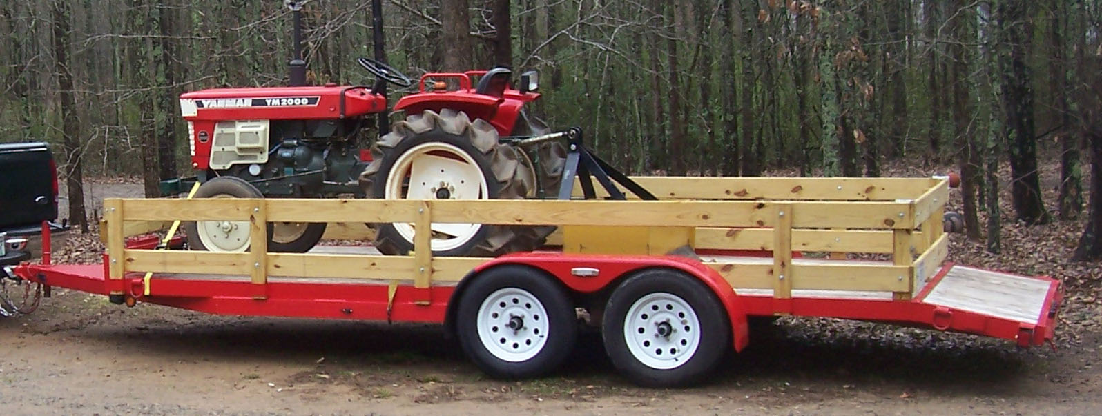

Just had my 2000 out for first full mow of the season. Bought from a UTDA dealer 2008. ASIS. Org. Gladly gave him the asking price.2800$ In the high 900tach, hrs that I put on it! Had to repair/Rebuild the starter. Not much to a rebuild on that tractor or cost. Shop to split my ford was only 1200$.New 2 stage clutch pressure plate and had to repair the shifter. It has a loader on it also. Your only looking at a few hundred dollars in parts and your time. From the posts and replies I don't think that to be a problem. No busted block your most likely good. Ever heard the term Turn a Crank? Repair the crank shaft! Not hard to do. Worst case most likely. Like to see the damage to crank shaft! Pics. My of YM2000 then and now all Org.. Gladly repair/rebuild this one if I had to. If it's repairable busted block Etc..

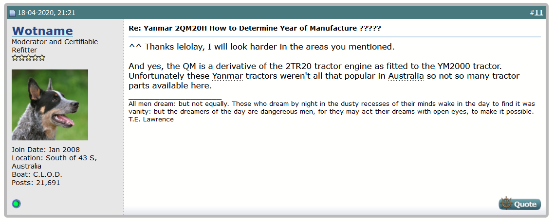

I mis-spoke above. 2QM-20 marine diesel, is the marine equivalent of the 2TR-20 (YM2000) engine.
From an experienced person in a boating forum:
Google shows several listed for sale in the boating world.
Another application of the basic engine was ThermoKing semitrailer reefer units, 40 years ago. That might be the cheapest source for a rebuildable core.
