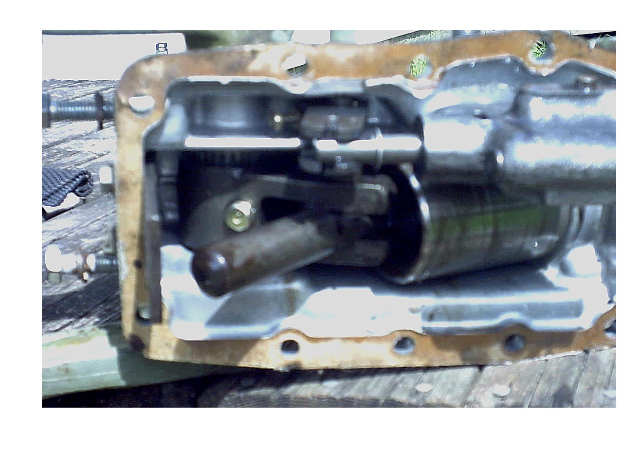

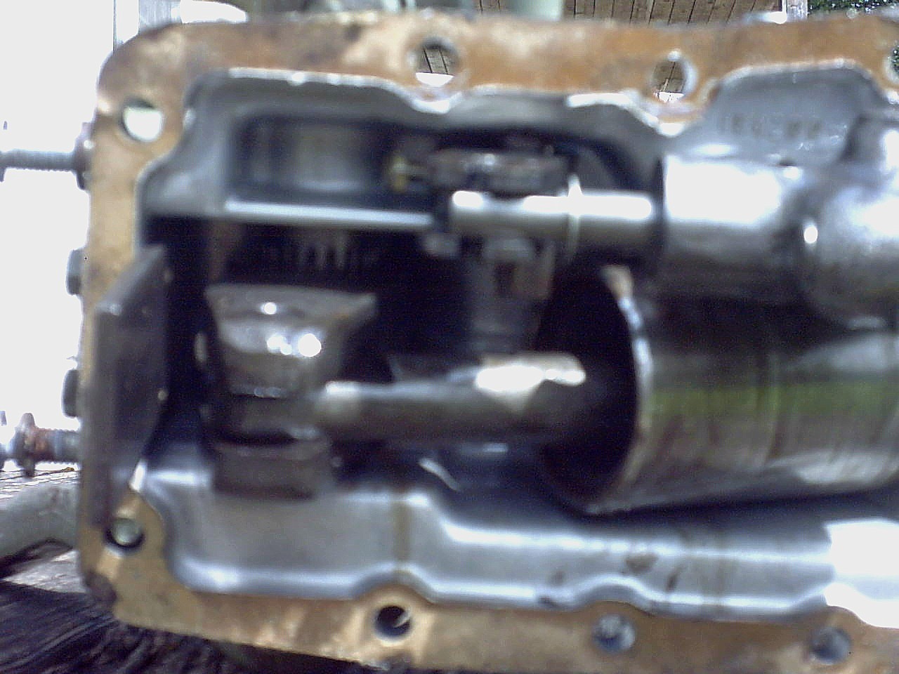

#13
Problem Solved!
The problem turned out to operator/assembler error. There is a pushrod that raises the 3 point arms that fits into the dished top of the lift cylinder piston. When I installed the lift cylinder assembly into the housing, somehow that pushrod slipped down so that it hung loose instead of fitting into the piston like it should. The lift arms would lift slightly because the piston would push on the piece that the pushrod was connected to as the piston reached the end of it's stroke. Hopefully someone will learn from my error. Thanks to all who replied.
