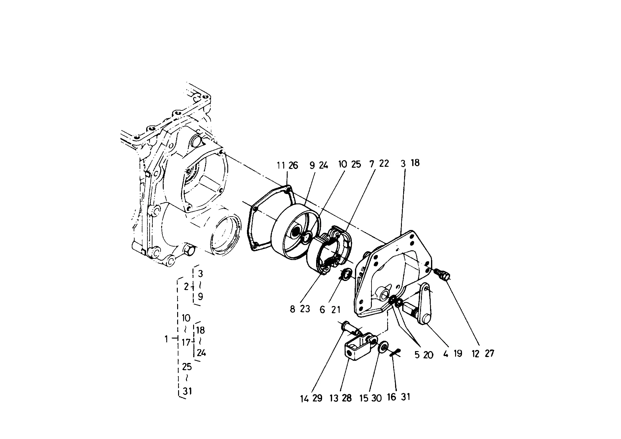

Hi !
I’ve got an old Kubota B7100 that I absolutely love — it’s even older than I am. Today, the control lever for the 3-point hitch popped off at the valve. I can see an O-ring, but I’m not sure how to put everything back together and I don’t want to force anything and make it worse.
Has anyone dealt with this before or knows the proper way to reassemble it?
Thanks in advance!

I’d start by checking the parts diagrams at messicks . Not certain if this is the right link for what you need…
   / 3 point hitch lever repair - Kubota B7100 #3
Using the parts diagram posted above, looks like the bolt #23 may have fallen out and now the lever is not connected to the linkage inside. I imagine you may have to take cover #19 out to inspect and fix it.

Hi !
Thanks for pointing me in the right direction ! The diagram provided on messicks is really helpful. I will remove the cover #19 and inspect.
I will keep you updated.
