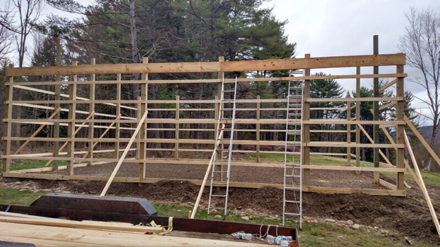

Got in a day and a half on the barn. It was 90 degrees and humid so my uncle and I took it slow but put a descent dent in the siding.
Enjoy the pics......

Woody65...i build pole buildings for a living...putting those 2' on center is a very strong building. Looks like this building is built strong with 2x12 top beam truss carrier. U shouldn't get any racking with your building. A lot of national builders like to use 8' to 12' truss spacing. I guess it works...I usually go with 4' on center truss spacing.
Pole Barn Truss Spacing - YouTube
/ Yet another pole barn build
#53
Woody65...i build pole buildings for a living...putting those 2' on center is a very strong building. Looks like this building is built strong with 2x12 top beam truss carrier. U shouldn't get any racking with your building. A lot of national builders like to use 8' to 12' truss spacing. I guess it works...I usually go with 4' on center truss spacing. Pole Barn Truss Spacing - YouTube
Thanks for the compliments. Especially coming from a builder of these type structures. The trusses were speced for 4' o/c but it was a small bump in the overall cost for me to put them at 2' o/c. And since I am doing all the work ( no labor costs), it made sense. We can get large snowfalls. This is only my third pole barn build, 2 for family and this one for myself. I took the best techniques, of what I thought, and incorporated them into my barn. I think it should hold up for quite sometime. I have been building for 30+ years but conventional residential construction. Different techniques but same principals.
