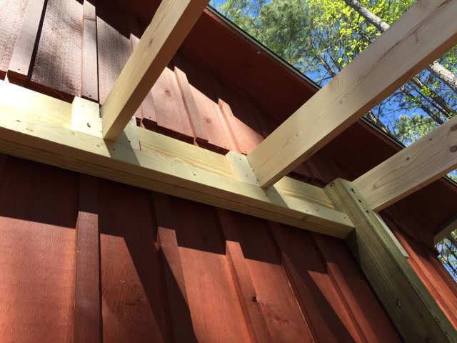

What we did on my barn, and again on the lean-to I am adding, is to notch the post for just one of the headers, and then sister the second to it (with a lot of nails down the length). That way the second header sticks out and is on the same plane as the wall girts and you can attach siding directly to it. The first header has more than enough bearing area on the notched post to carry the roof load on down. Even the picky building inspector was happy with this when I showed him the loads. He was not going to let us just face nail the headers on as is standard practice with pole barns.
S219,
Super idea! :drink:
I really like your approach with the notching and 'sistering' of the headers.

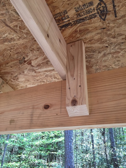

I've done the bottom picture, but never done the top one with the side blocks. I assumed the metal brackets and then toe nailing into the ledger board would suffice. I can see where your method is better, and I appreciate the picture.

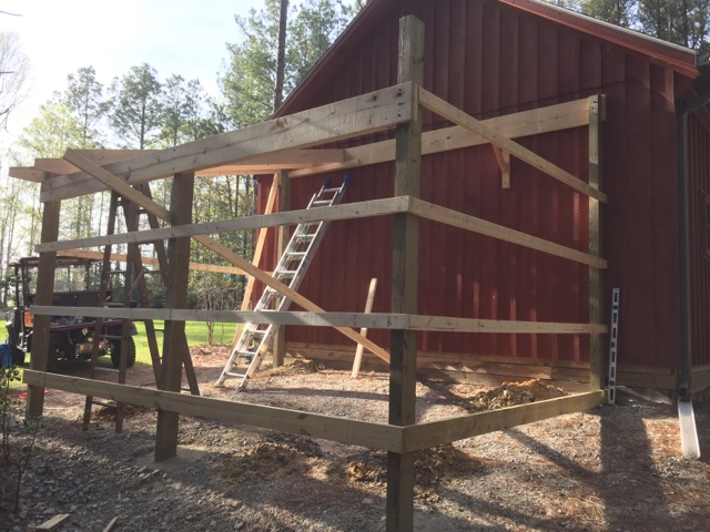

/ Yet another pole barn build #26
Woody65,
What is the length(s) of the 6x6 posts you used to start with?
The upper header I see is 2 2x12s sistered. Is that a 2x8 bottom board?
Is that 24" spacing on centers for the girts?
Lenny
#27
Woody65, What is the length(s) of the 6x6 posts you used to start with? The upper header I see is 2 2x12s sistered. Is that a 2x8 bottom board? Is that 24" spacing on centers for the girts? I'm taking notes here.<img src="http://www.tractorbynet.com/forums/attachment.php?attachmentid=467786"/> Lenny
Lenny,
The eve sides have 16' 6x6's 4' in the ground and 12' above grade. The gable sides have 20' 6x6's again 4' in the ground and 16' above grade to catch the gable end trusses.
The bottom ledger board is a 2x6 acq.
Everything is spaced at 24" o/c
