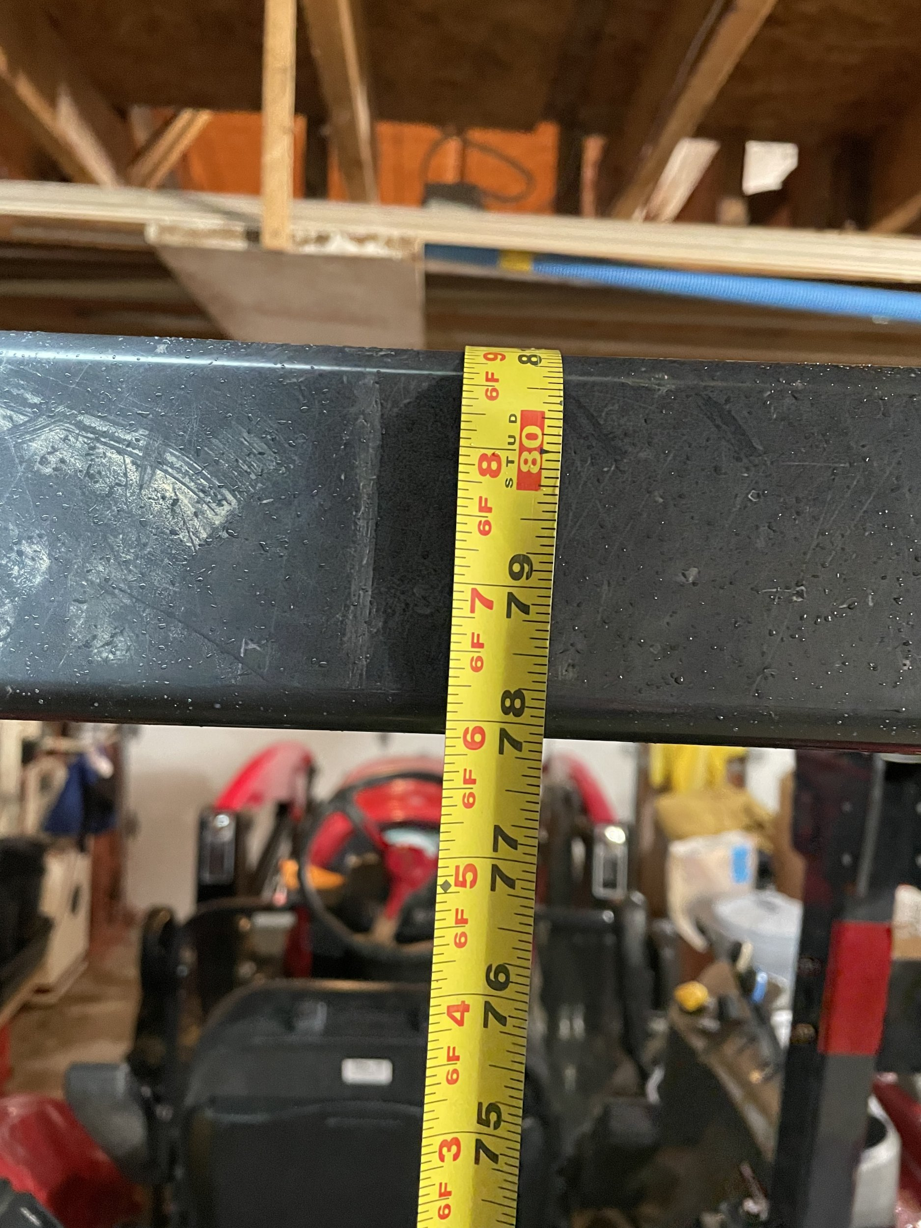

Anyone know what the height of a YT347/359 is with the ROPS folded? Want to know if it’ll fit in a standard 7ft garage door opening.
I’m pretty sure a Kubota Grand L is too tall to fit in a standard garage with the ROPS folded and if the Yanmar does it could sway the decision making process.

R4’s, would be appreciative if any owners or dealers could take a measurement….
/ Yanmar YT3 ROPS Height #4
My YT347 with R4s clears my 7ft garage door with the ROPS folded. I’ll measure mine today and let you know.

Andy
i had to put my tractor in the garage and I remeasured with the ROPS pinned in the down position and it measures 80.5”. Still clears the garage door. 78” was when the ROPS was folded all the way down past the pin holes.

Andy
Thanks for pic and measurements.
