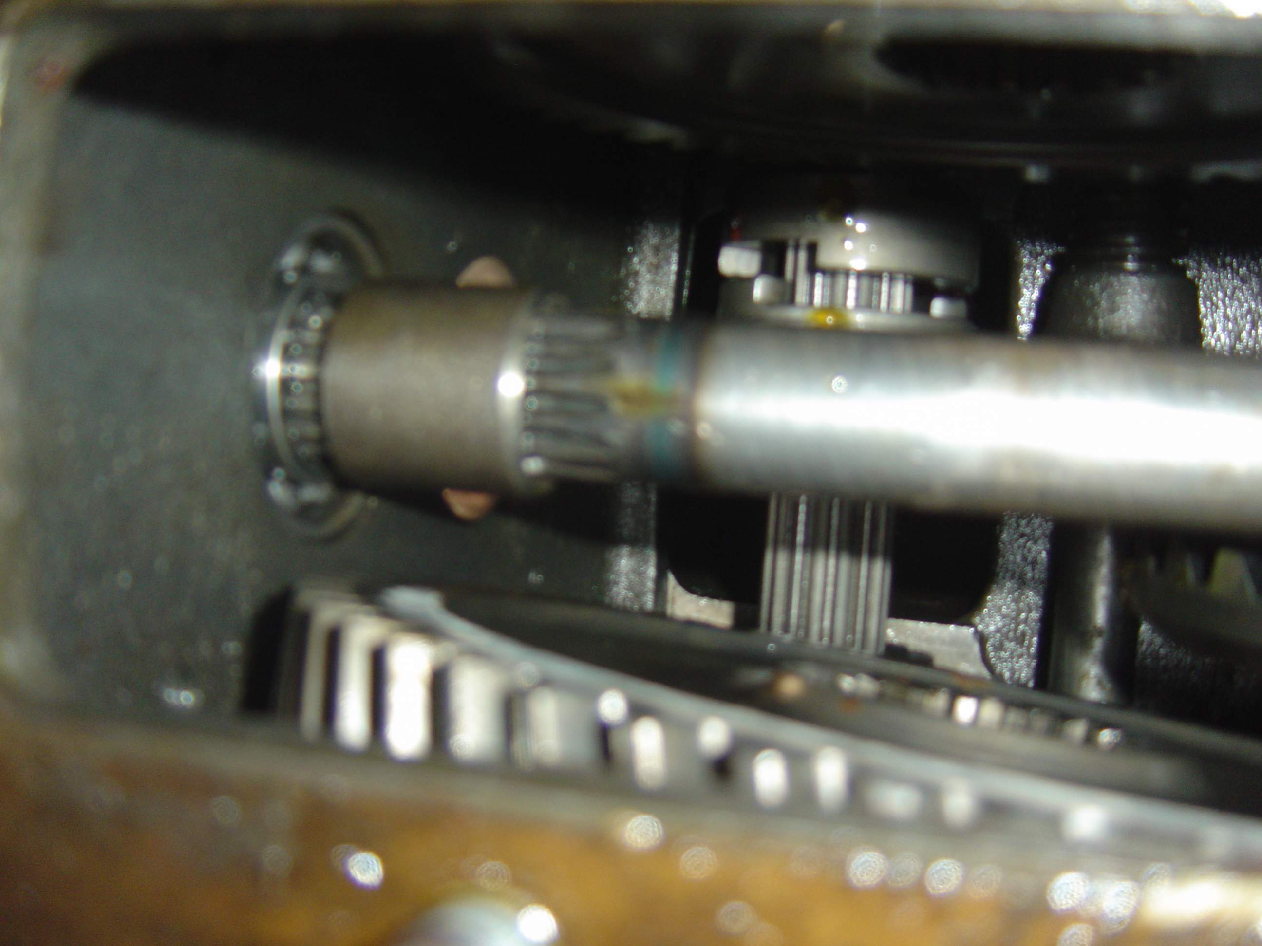

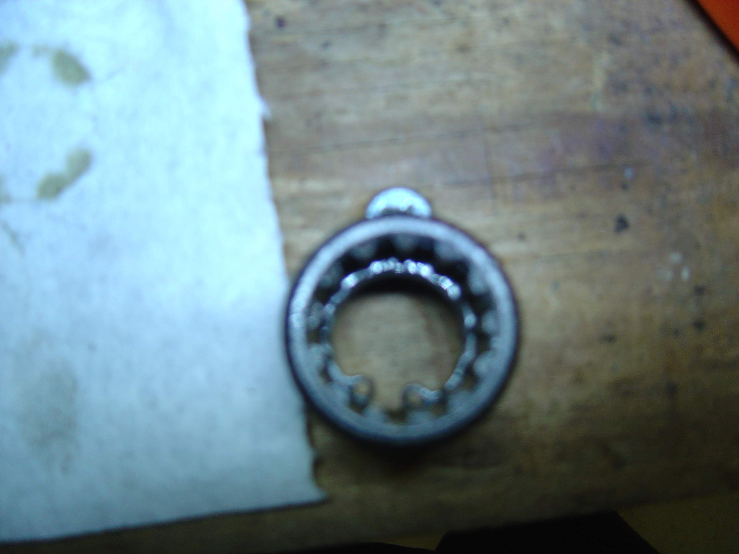

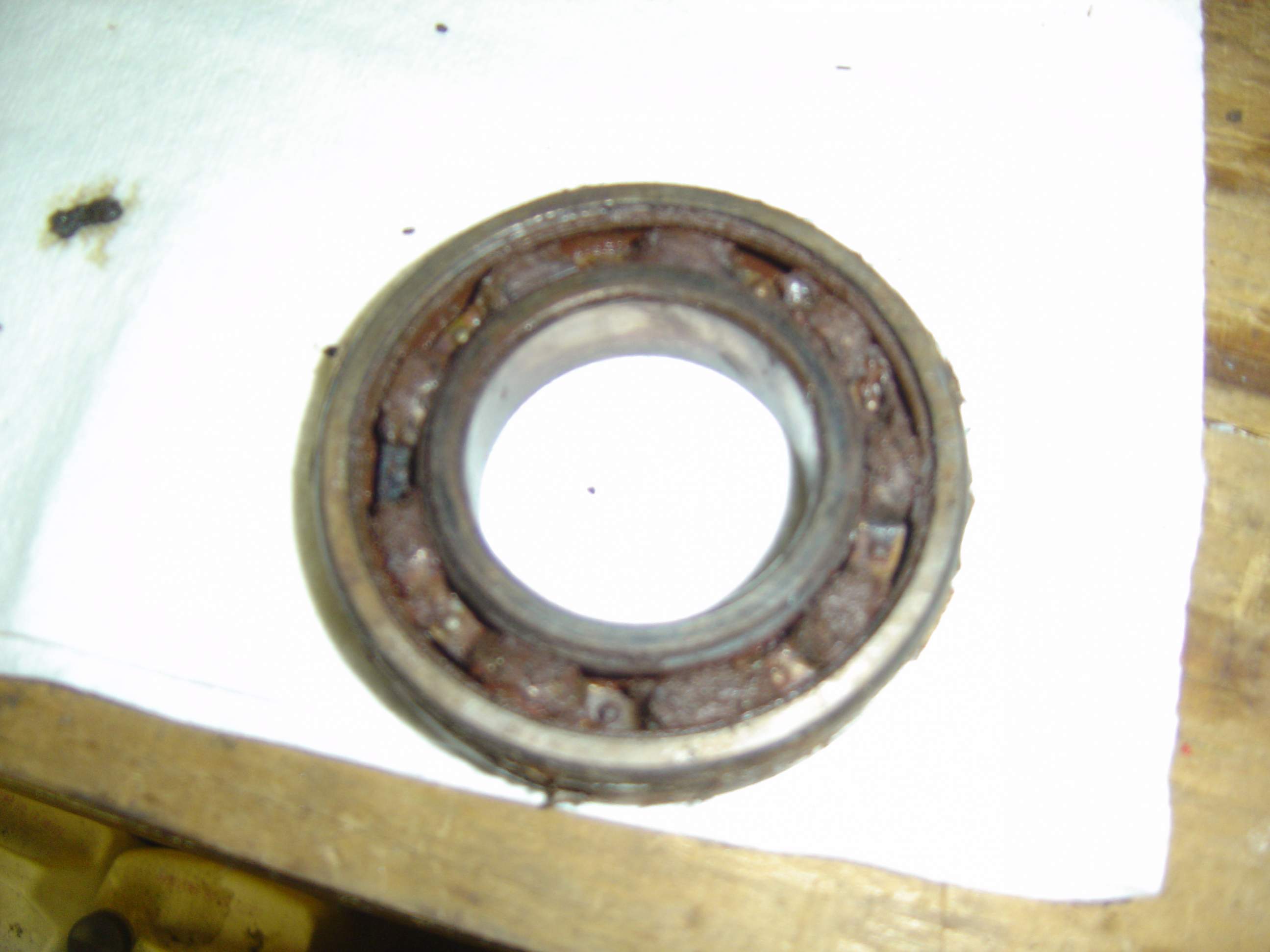

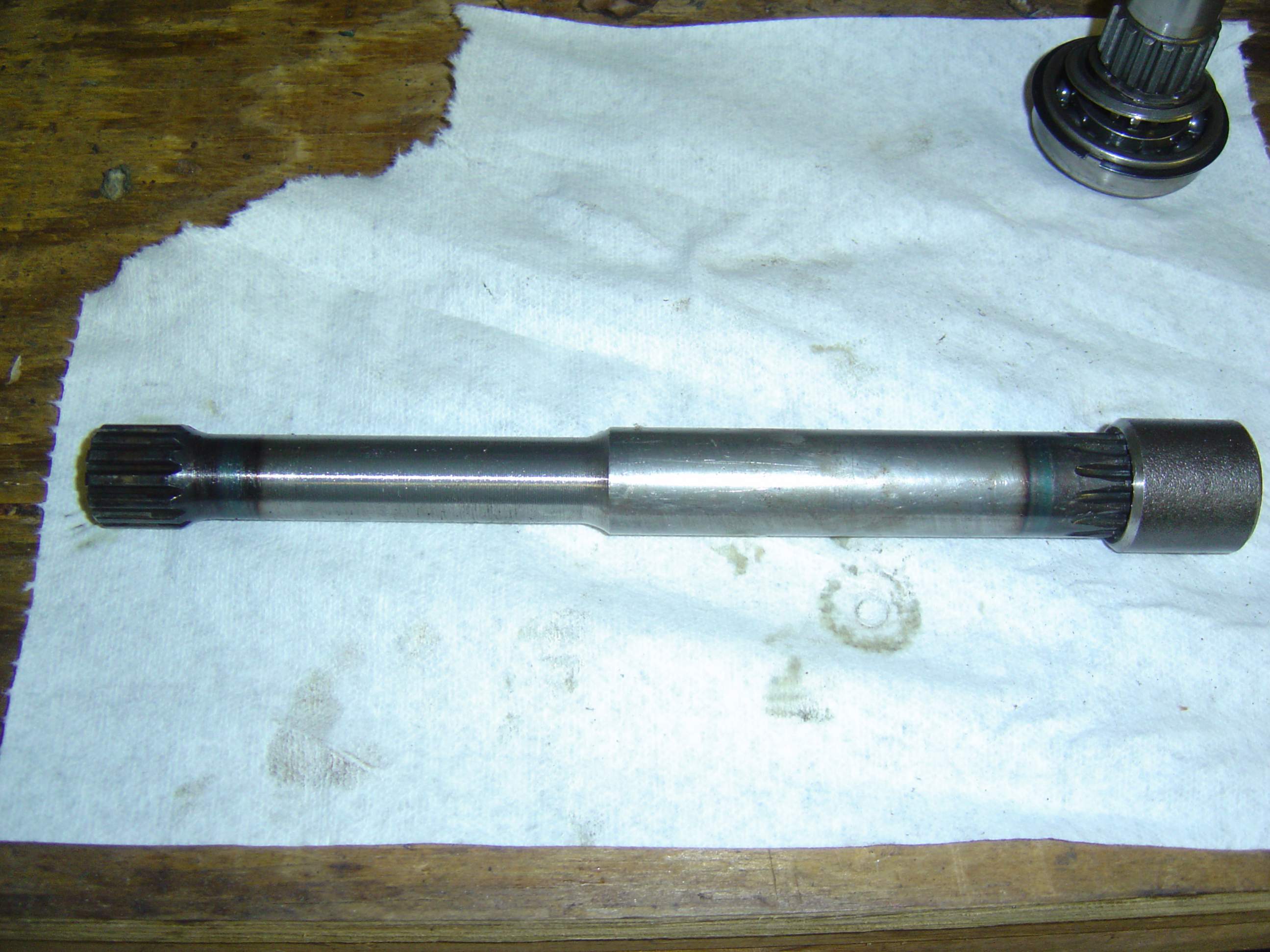

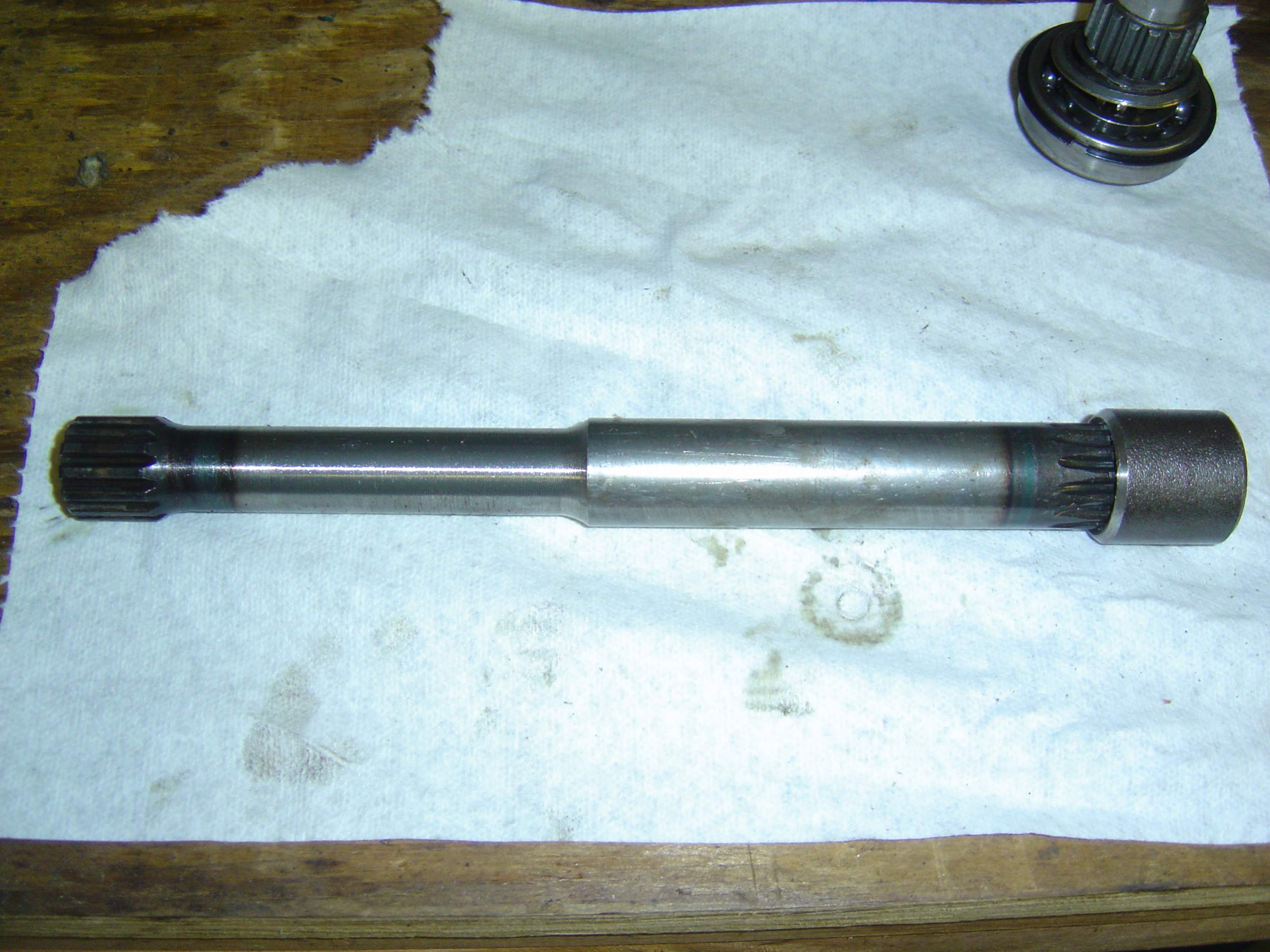

The photos below show the PTO shaft that is inside the rear axle housing. The sleeve that connects it. The original outer bearing from my tractor that had not yet completely failed.

Talk to the guys at Hoye. They will be able to help determine it for sure. But I'm positive it's a red axle setup due to the square housings for the outer bearing and the bolt on brake covers. 30 some years of use will cause the failure. The outer bearings are never greased after assembly so the finally dry out and fail. It has probably been like that for a while. I found mine when it was apart for the hydraulic pickup screen.
